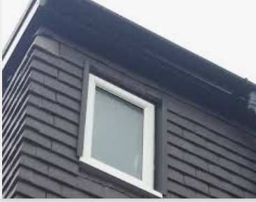

David Lam Posted June 10, 2021 Share Posted June 10, 2021 Hi all First post from me! I'm retrofitting an MVHR system into my new loft and am thinking about where to place the ducts to atmosphere. They could come out of the front of the house through brick. However there's limited space for the MVHR unit due to the pitch of the roof and I want to put the unit close to the facade. Alternatively they could come out of the rear of the house through the tiles in the dormer. However I can't find a product on the internet that will allow a neat solution to dress around the ducts as they exit. Does anyone know how to do this? I'm not in the country at the moment so can't show photos, but this is the kind of tile in the screenshot attached. Thank you! David Link to comment Share on other sites More sharing options...

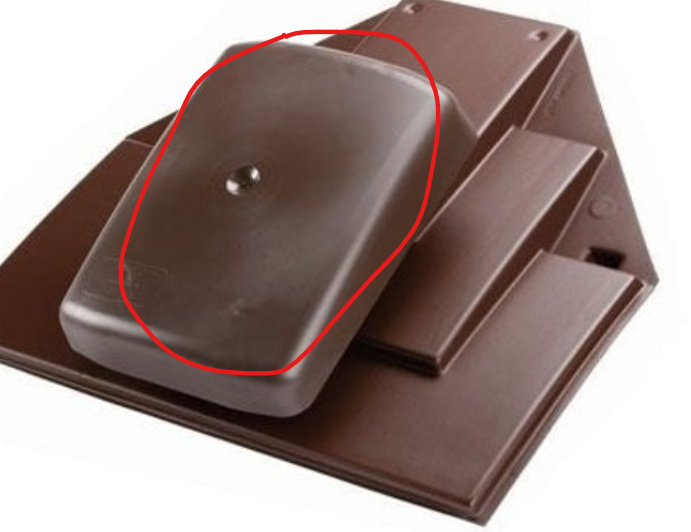

David Lam Posted June 10, 2021 Author Share Posted June 10, 2021 Thanks both. I haven't checked the tiles yet, but they're for the wall of the dormer, not the roof. I was hoping to find an image online that showed me what I was looking for, but havent' been successful. I was expecting to be able to see a ductwork cowl poking out with some neat flashing around or something. Does the Ubbink tile vent allow the bit I've circled to come off? Sorry, I just can't see how it works if you're trying to throw the exhaust air away from the building. Link to comment Share on other sites More sharing options...
dpmiller Posted June 10, 2021 Share Posted June 10, 2021 there's a grille on the underside of the circled bit. it blows "down" onto the tiles. Link to comment Share on other sites More sharing options...

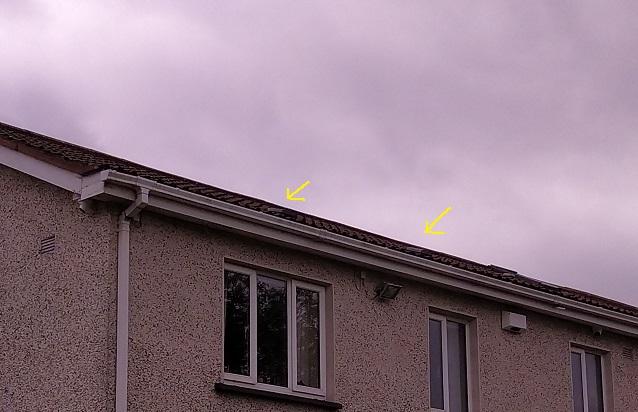

mike2016 Posted June 12, 2021 Share Posted June 12, 2021 Hi, Tried taking a photo, hard to get angle as that's from the back of the garden and not keen on heading up the ladder for a close up. Link to comment Share on other sites More sharing options...
David Lam Posted June 12, 2021 Author Share Posted June 12, 2021 Ah, okay. Thanks for trying! They do look pretty similar from this angle. Link to comment Share on other sites More sharing options...

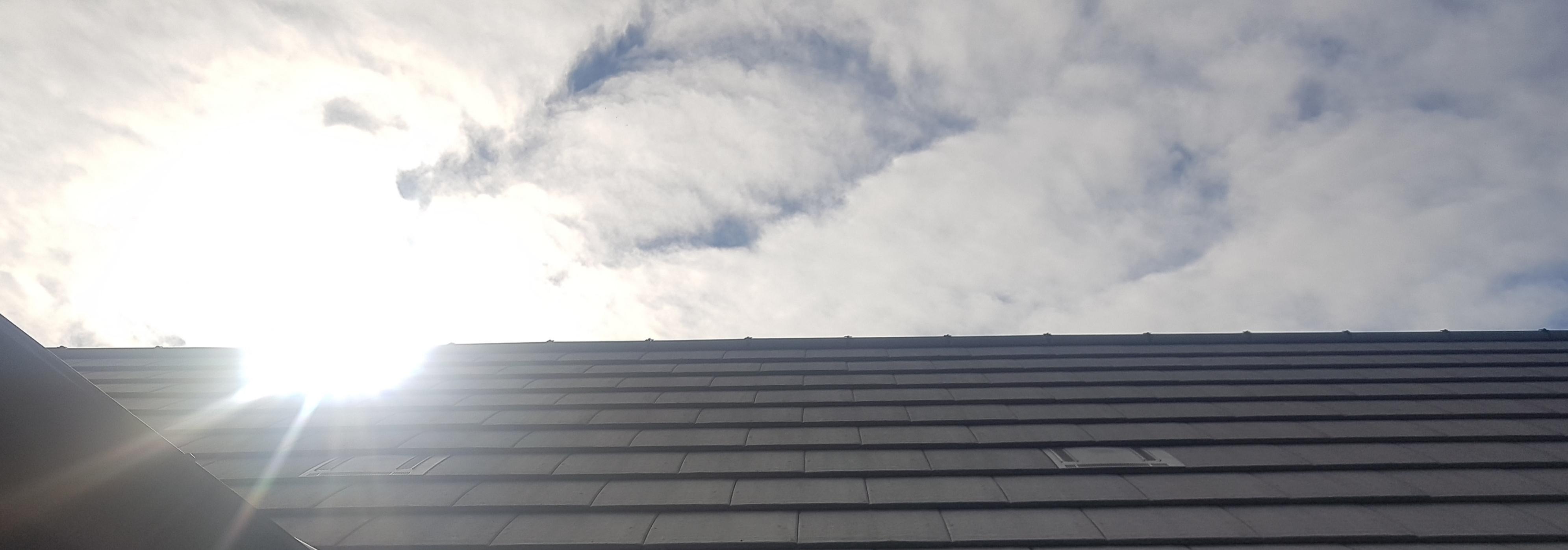

Oz07 Posted June 13, 2021 Share Posted June 13, 2021 Link to comment Share on other sites More sharing options...

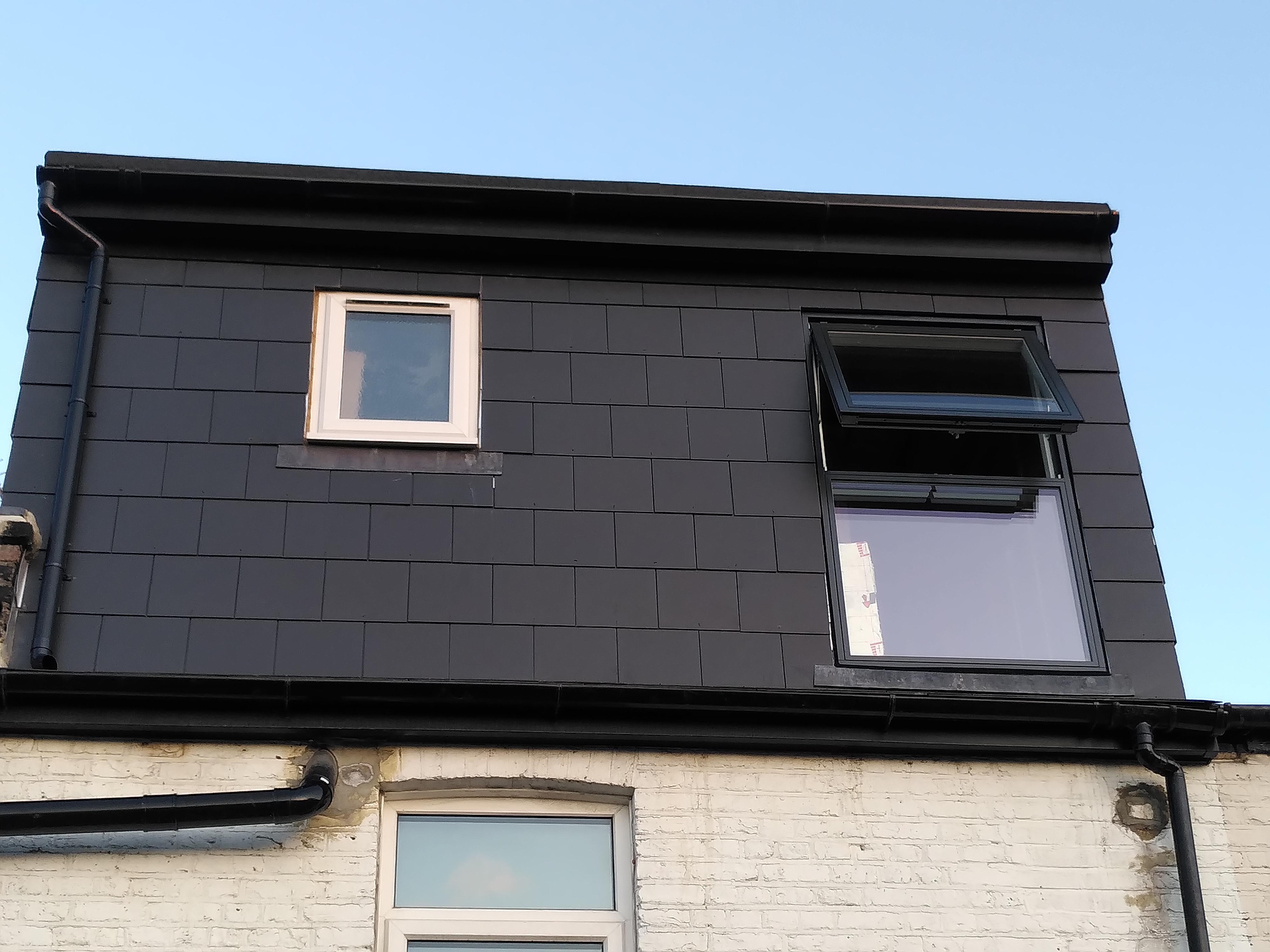

David Lam Posted August 3, 2021 Author Share Posted August 3, 2021 So BCP has suggested their cowl for going out of the wall. https://www.bpcventilation.com/exterior-grille-s-steel-louvered-cowl However I'm worried about the waterproofing of the tiles. Is this something that is standard? I suppose I could remove the tiles, cut a circular hole in them and put the cowl through but this seems a bit bodgy. Does anyone have any ideas? Cheers! David. Link to comment Share on other sites More sharing options...
Oz07 Posted August 3, 2021 Share Posted August 3, 2021 Wall or roof? Link to comment Share on other sites More sharing options...
David Lam Posted August 4, 2021 Author Share Posted August 4, 2021 Wall. I've attached a photo of what it looks like. The alternative is to go through the soffit, but it's pretty narrow. Probably big enough for 100mm duct. The intake/exhaust ducts on the unit I'm thinking of (VentAxia) is 125mm. BPC has said I could reduce from 125mm to 100mm, but that sounds problematic to me. Much appreciations! D Link to comment Share on other sites More sharing options...
James Newport Posted August 4, 2021 Share Posted August 4, 2021 My genius idea is to split the 125mm pipe into two smaller pipes and vent them through the soffit. (This is totally my genius idea and totally not the genius idea I got from @Nickfromwales) 1 Link to comment Share on other sites More sharing options...
David Lam Posted August 4, 2021 Author Share Posted August 4, 2021 Aha! Well it sometimes takes a genius to recognise genius. Did you buy something off the shelf or did you have to have it bespoke made? Thanks! Link to comment Share on other sites More sharing options...
James Newport Posted August 4, 2021 Share Posted August 4, 2021 In my case I already had the 100mm outlets through the soffits. I am using a 90 degree T piece to split a 150mm duct into two and send it out of the outlets. Link to comment Share on other sites More sharing options...
Temp Posted August 5, 2021 Share Posted August 5, 2021 +1 Ours are also through the soffit. In my case the soffit are ground floor level. Link to comment Share on other sites More sharing options...
David Lam Posted August 5, 2021 Author Share Posted August 5, 2021 Thanks both. I'll see if BPC can sell me something like that. Link to comment Share on other sites More sharing options...
