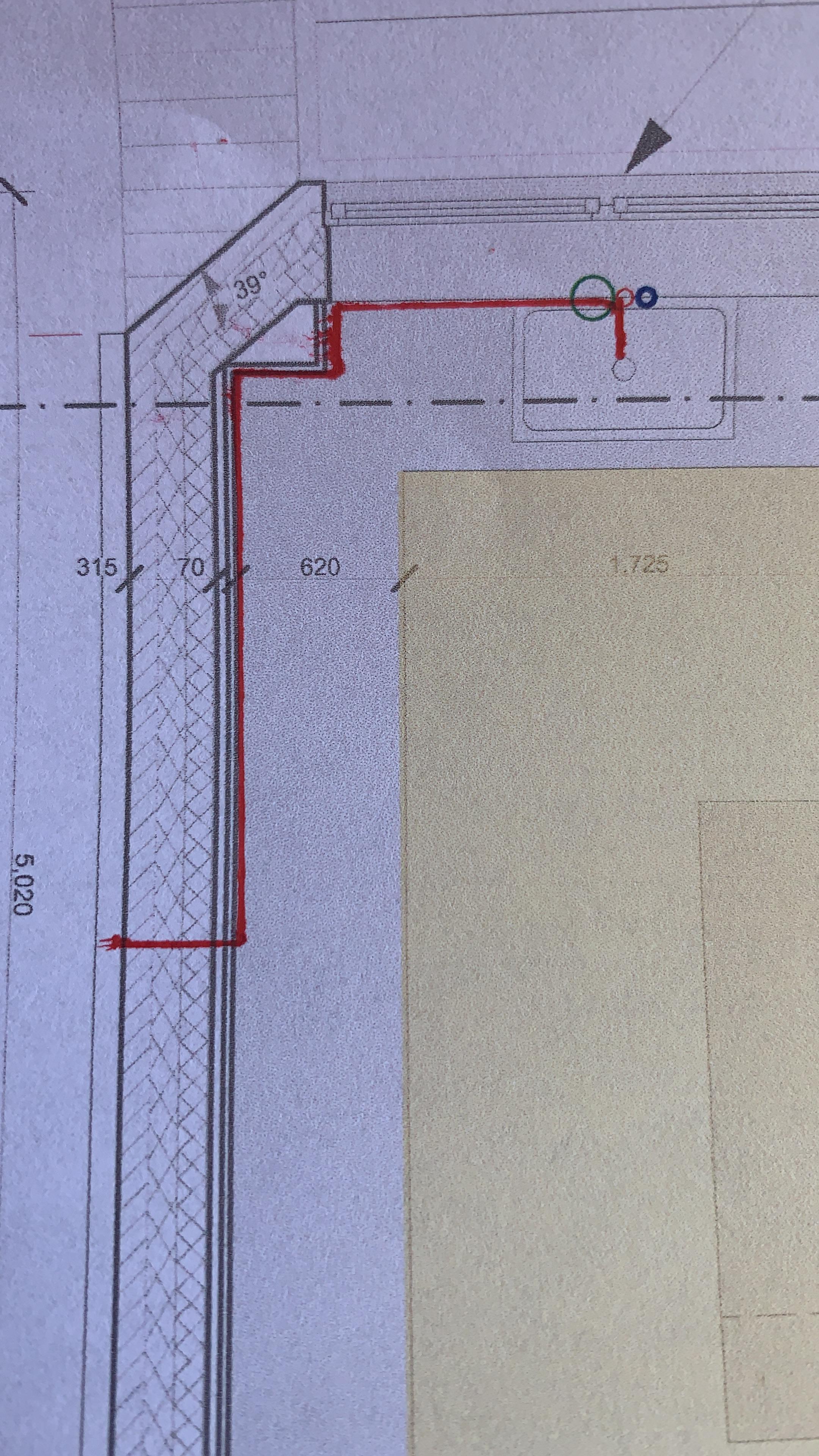

Adsibob Posted June 8, 2021 Share Posted June 8, 2021 Our rear extension is sunk into the ground by about 40cm (planners' requirement, not ours). As the original house is already about 80cm or 90cm below the road and as we are having our kitchen sink and dishwasher at the back of the rear extension, we are going to need a pump to get the waste water from the kitchen sink and dishwasher up to the sewer on the road. I'm just trying to figure out what design considerations I should factor in. We are keen that the pump is quiet but appreciate that these things can never be silent so we were going to place the pump as far away from the kitchen as we can get away with. At the moment, the idea is to take the waste water to the side passage of the house and house the pump underground, in a chamber in the side passage that is covered with a manhole cover. Should I be fitting a back-up pump as well in case the primary one cuts out / dies, or is that only necessary for a toilet? Alarm system to notify me of any issues? Any other recommendations? Is Saniflo the market leader for quiet pumps or should I be considering other brands as well? Any issue with it being outside during a cold patch of weather in winter. Say if the temperature drops to -10? We live in London, so that's rather unlikely, but not unheard of. Link to comment Share on other sites More sharing options...

Adsibob Posted June 8, 2021 Author Share Posted June 8, 2021 Another issue is the extent to which the waste water pipe needs to be serviceable. Our thinking was to install it as shownin red on this drawing, with the pipe going behind the kitchen cupboards for about 4m before travelling through the cavity wall where it would then go underground to the chamber where the pump is. Assuming we can pull out the kitchen cupboards to service it, and there are a couple of access points for rodding, is this a good idea? I know it would be much easier to just go outside, but this area of the rear elevation is a bit of a feature so we rather not have a pipe on show there. Link to comment Share on other sites More sharing options...

Mr Punter Posted June 16, 2021 Share Posted June 16, 2021 I would run the waste right to the end of the kitchen units in 40mm. It looks like there is a void or some insulation behind anyway. Run it to a decent fall. I don't know where the drain is outside in relation to your plan. 23m is not a particularly long run. if you know the invert of the drain we can let you know if you can let gravity be your friend. 1 Link to comment Share on other sites More sharing options...
Adsibob Posted June 16, 2021 Author Share Posted June 16, 2021 3 minutes ago, Mr Punter said: I would run the waste right to the end of the kitchen units in 40mm. It looks like there is a void or some insulation behind anyway. Run it to a decent fall. I don't know where the drain is outside in relation to your plan. 23m is not a particularly long run. if you know the invert of the drain we can let you know if you can let gravity be your friend. Will I be able to hear the trickle of the water from the sink, or can i just insulate the pipe? Not sure i will have much space for insulating a 40mm pipe. Link to comment Share on other sites More sharing options...

Nickfromwales Posted June 16, 2021 Share Posted June 16, 2021 3 hours ago, Adsibob said: Will I be able to hear the trickle of the water from the sink, or can i just insulate the pipe? Not sure i will have much space for insulating a 40mm pipe. It’s that compromise or a pump Take the compromise ! 3 hours ago, Mr Punter said: I don't think the noise of the water will be an issue at all. More likely to hear the water as is goes down the sink waste, not once it is in the pipe and running steadily. +1 Forget the above mention of 110mm pipe, and just run it in 50mm all the way with T’s and cleaning ( rodding ) eyes at each significant point or change of direction instead of bends. All bends need to be bends NOT elbows eg swept. 23m will be fine. Link to comment Share on other sites More sharing options...
Adsibob Posted June 16, 2021 Author Share Posted June 16, 2021 Thanks, this is all helpful stuff. I don't think I have space for a 50mm pipe, but definitely have space for 40mm. Is there a big difference in performance/serviceability between 50mm and 40mm? I think the regs require a minimum diameter of 30mm (table 2, page 9 of this: https://assets.publishing.service.gov.uk/government/uploads/system/uploads/attachment_data/file/442889/BR_PDF_AD_H_2015.pdf) Link to comment Share on other sites More sharing options...
Nickfromwales Posted June 16, 2021 Share Posted June 16, 2021 You’re not really supposed to run 32 or 40mm more than 3m in normal circumstances, but when adversity strikes you can mitigate against ‘risks’ as per the above ( 50mm pipe and plenty of cleaning access etc ). Theres no way in hell that you can go to 32mm pipe for this, and I wouldn’t do it in 40 for more than 6m before upsizing to 50. What’s the issue with locating the 50 all the way? Link to comment Share on other sites More sharing options...
Adsibob Posted June 17, 2021 Author Share Posted June 17, 2021 18 hours ago, Nickfromwales said: What’s the issue with locating the 50 all the way? The units I'm buying have a 42mm service void at the back. So i guess i could set them 8mm in front of the wall and create a 50mm gap that way. Or chase into the wall, but I rather not as that will diminish my insulation. Link to comment Share on other sites More sharing options...
markc Posted June 17, 2021 Share Posted June 17, 2021 1 minute ago, Adsibob said: The units I'm buying have a 42mm service void at the back. So i guess i could set them 8mm in front of the wall and create a 50mm gap that way. Or chase into the wall, but I rather not as that will diminish my insulation. Unless your walls are absolutely perfect you will end up with at least some of the units pulling forward anyway. 10mm forward is nothing and wont affect the worktop Link to comment Share on other sites More sharing options...
TonyT Posted June 17, 2021 Share Posted June 17, 2021 Pull the units forward and put a decorative end panel to hide the gap. Link to comment Share on other sites More sharing options...
Nickfromwales Posted June 17, 2021 Share Posted June 17, 2021 (edited) 3 hours ago, Adsibob said: The units I'm buying have a 42mm service void at the back So with that and the plasterboard channelled you you’d have 56mm to play with? More if it’s plastered plasterboard. Edited June 17, 2021 by Nickfromwales Link to comment Share on other sites More sharing options...
