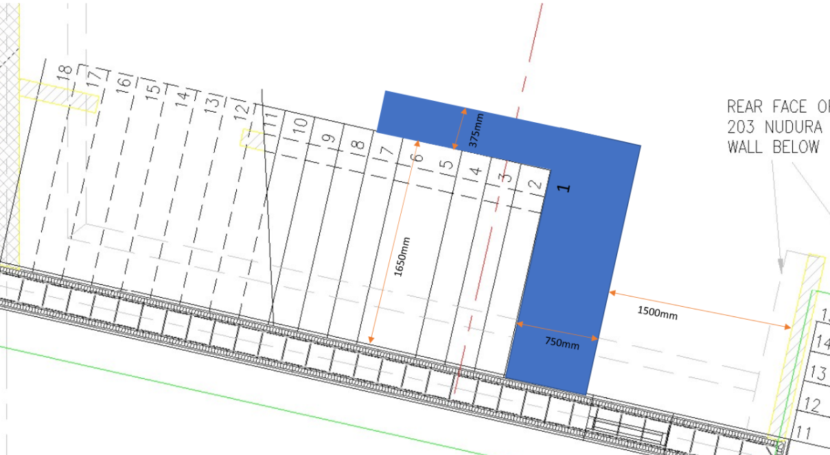

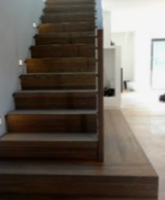

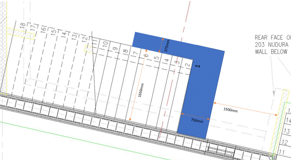

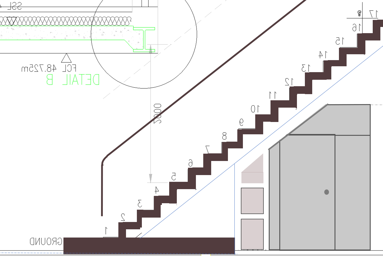

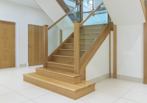

Adam2 Posted June 7, 2021 Posted June 7, 2021 We have a bit if a feature staircase coming from a lounge area into a multi-use kitchen/dining/relaxing area  The original architect design was a straight run of uniform stairs but we'd like the bottom step to be much wider - same rise. Our BC chap indicates this won't be compliant. This is what we're looking to aim for and below is mock up of the side view. We can tweak things if needed but would like to get something like this - I guess worst case we could always do a simple run of stairs and after sign-off modify them?  Beneath the stairs will be a small room so the stair width helps this to be more usable.  Thanks for suggestions           Â
Russell griffiths Posted June 7, 2021 Posted June 7, 2021 What was his reasoning that it wouldn’t comply.Â
Adam2 Posted June 7, 2021 Author Posted June 7, 2021 Max going is too far to be a step but too short to be a landing - think that needs to be at least the width of the stair
Adam2 Posted June 7, 2021 Author Posted June 7, 2021 48 minutes ago, Russell griffiths said: What was his reasoning that it wouldn’t comply. May be able to swing it if 900 deep first step as that would match the width of a "regular" staircaseÂ
DevilDamo Posted June 12, 2021 Posted June 12, 2021 In my opinion, it doesn’t look great but each to their own.  As you mentioned, why not just put in the compliant step and then ‘add’ onto it to create what you want post sign off?
ProDave Posted June 12, 2021 Posted June 12, 2021 Reason for non compliance would be all stairs must be same rise and going. Nothing wrong with the wrap around stair if it was the same rise and going as the rest.
Mr Punter Posted June 12, 2021 Posted June 12, 2021 To me it just looks like an extended curtail feature tread, but square instead of rounded. Â
ProDave Posted June 12, 2021 Posted June 12, 2021 Ask your BC inspector how large it needs to be to be classed as a "landing" and make it that big?
Adam2 Posted June 21, 2021 Author Posted June 21, 2021 Yes he agreed with flexing the landing do it will comply if 900 deep so all good
