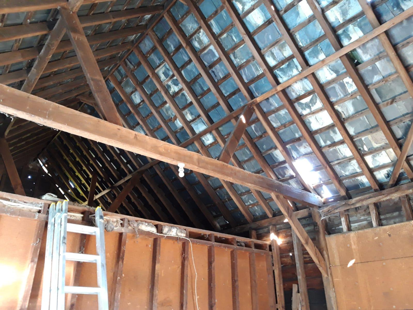

Mr Punter Posted June 4, 2021 Posted June 4, 2021 If you post up the photo we could take a view. Is the whole building demolished, or just the mezzanine? Even if there are some supports or fixing holes it should help your case. 1

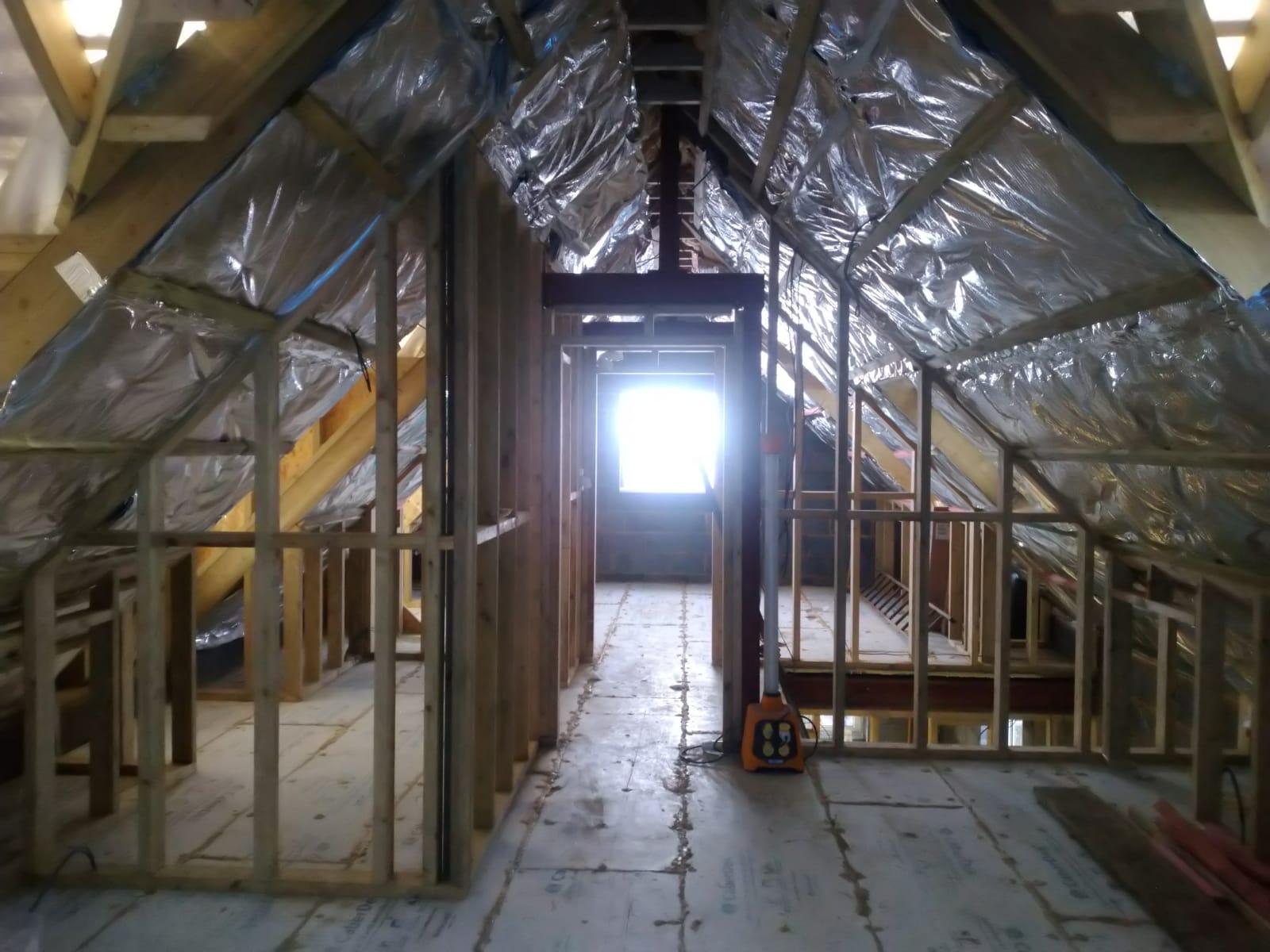

harry_angel Posted June 4, 2021 Author Posted June 4, 2021 Here is the beauty: load bearing, with an accompanying 1st storey window and 1st storey (presumed) hay hatches... How could anyone ignore its delights? PS. LPA also calmly ignored the PD fallback position in terms of floor area, where I could whack up some absolutely vast outbuilding in this one's place, and crack their little " floor percentage increase" thermometer in the process....even typing this is bad for my blood pressure
