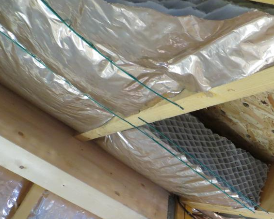

ProDave Posted June 4, 2021 Share Posted June 4, 2021 I was using the loft roll for insulating my sun room floor so it did not need to be self supporting. Frametherm 35 used in my ceiling, self supporting between the rafters before being boarded. I did one test section where I put a strip in long before I was ready as a test and left it there for 6 months and it did not sag or fall out. 2 Link to comment Share on other sites More sharing options...

MortarThePoint Posted June 4, 2021 Author Share Posted June 4, 2021 @ProDave What's this bit? Link to comment Share on other sites More sharing options...
ProDave Posted June 4, 2021 Share Posted June 4, 2021 That's a batten to catch the edge of the OSB sheet about to go on. OSB sheeting first, air tight membrane, battened service void then plasterboard. In my original picture you see the batten running all the way down and behind the first bit of OSB already in place. Link to comment Share on other sites More sharing options...
MortarThePoint Posted June 4, 2021 Author Share Posted June 4, 2021 38 minutes ago, ProDave said: That's a batten to catch the edge of the OSB sheet about to go on. OSB sheeting first, air tight membrane, battened service void then plasterboard. In my original picture you see the batten running all the way down and behind the first bit of OSB already in place. Have to taped the batten though? Link to comment Share on other sites More sharing options...
ProDave Posted June 4, 2021 Share Posted June 4, 2021 32 minutes ago, MortarThePoint said: Have to taped the batten though? The batten is just to secure the OSB. Air tight membranes and taping go over the top of the OSB detailed here http://ardross.altervista.org/Wilowburn/insulating-the-roof/ Link to comment Share on other sites More sharing options...

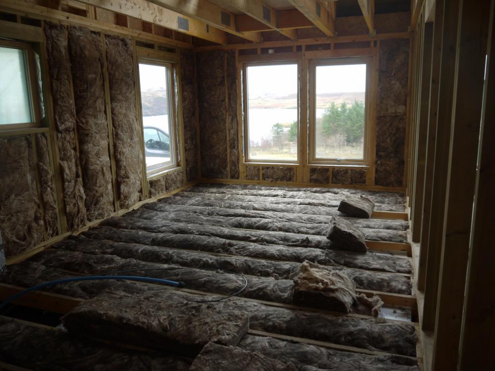

MortarThePoint Posted June 5, 2021 Author Share Posted June 5, 2021 54 minutes ago, ADLIan said: Earth wool is a trade name. Google ‘timber frame roll’ for alternative manufacturers 34 minutes ago, saveasteading said: Or 'cavity wall batt''/slab/insulation if you need the waterproof kind. One thing I wonder though is if Rafter Roll has controlled expansion to ensure it doesn't expand up and touch the roofing membrane. There's supposed to be a 50mm gap left. SHould have gone the counter batten route, but too late now ? @ProDave your FrameTherm didn't look to puff up whereas @Thedreamer yours did. Any thoughts on that? Link to comment Share on other sites More sharing options...
ADLIan Posted June 5, 2021 Share Posted June 5, 2021 Low density loft insulation is compressed more than cavity/rafter/timber frame insulation. All should expand to stated thickness once unwrapped but over or under expansion should not be tolerated. Complain to manufacturer if this happens. Link to comment Share on other sites More sharing options...
Thedreamer Posted June 6, 2021 Share Posted June 6, 2021 14 hours ago, MortarThePoint said: One thing I wonder though is if Rafter Roll has controlled expansion to ensure it doesn't expand up and touch the roofing membrane. There's supposed to be a 50mm gap left. SHould have gone the counter batten route, but too late now ? @ProDave your FrameTherm didn't look to puff up whereas @Thedreamer yours did. Any thoughts on that? In my photo two different products are being used Frametherm 35 in the walls and Frametherm 32 in the floor. The 32 is thicker product and more expensive. Link to comment Share on other sites More sharing options...
