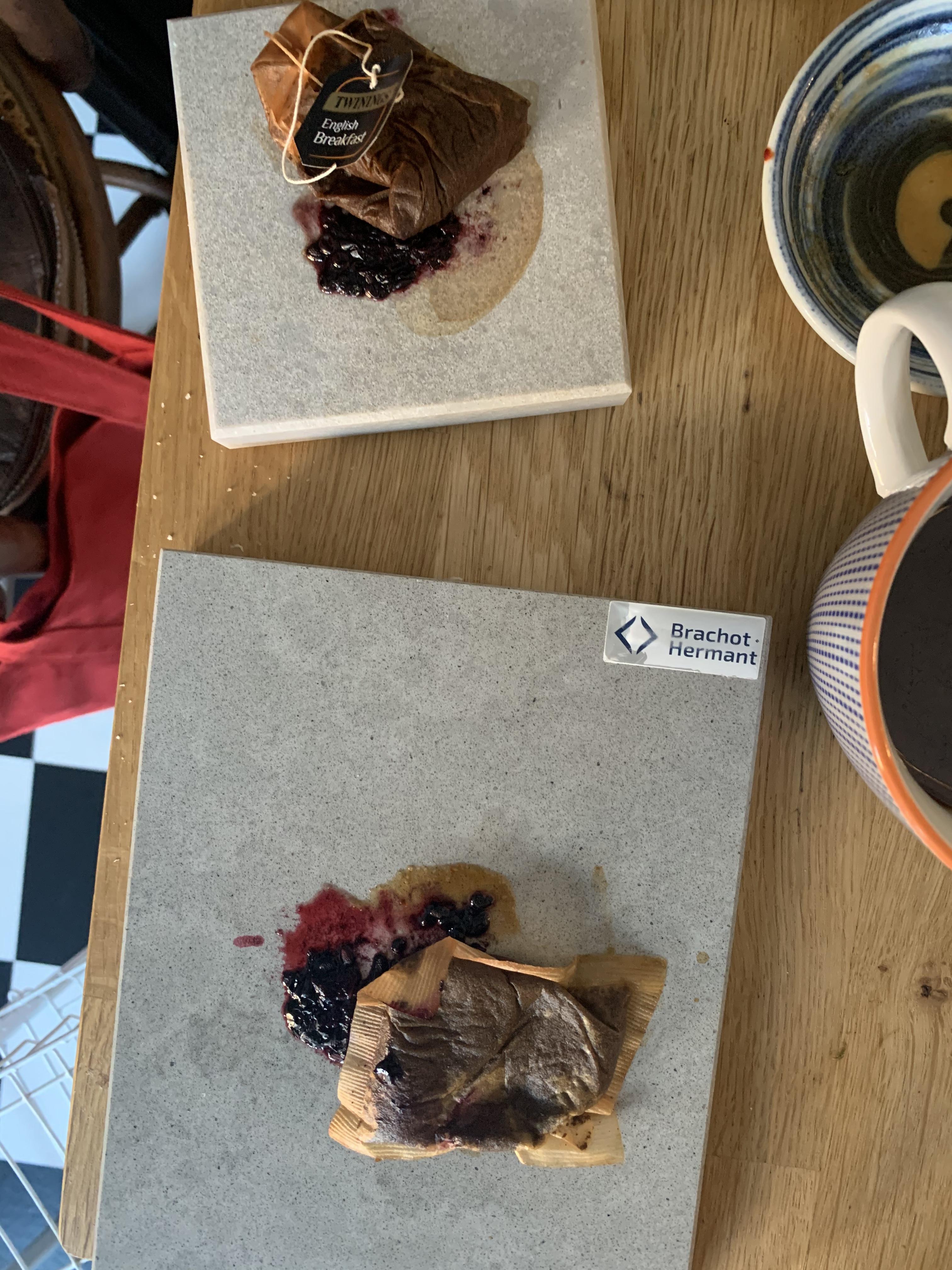

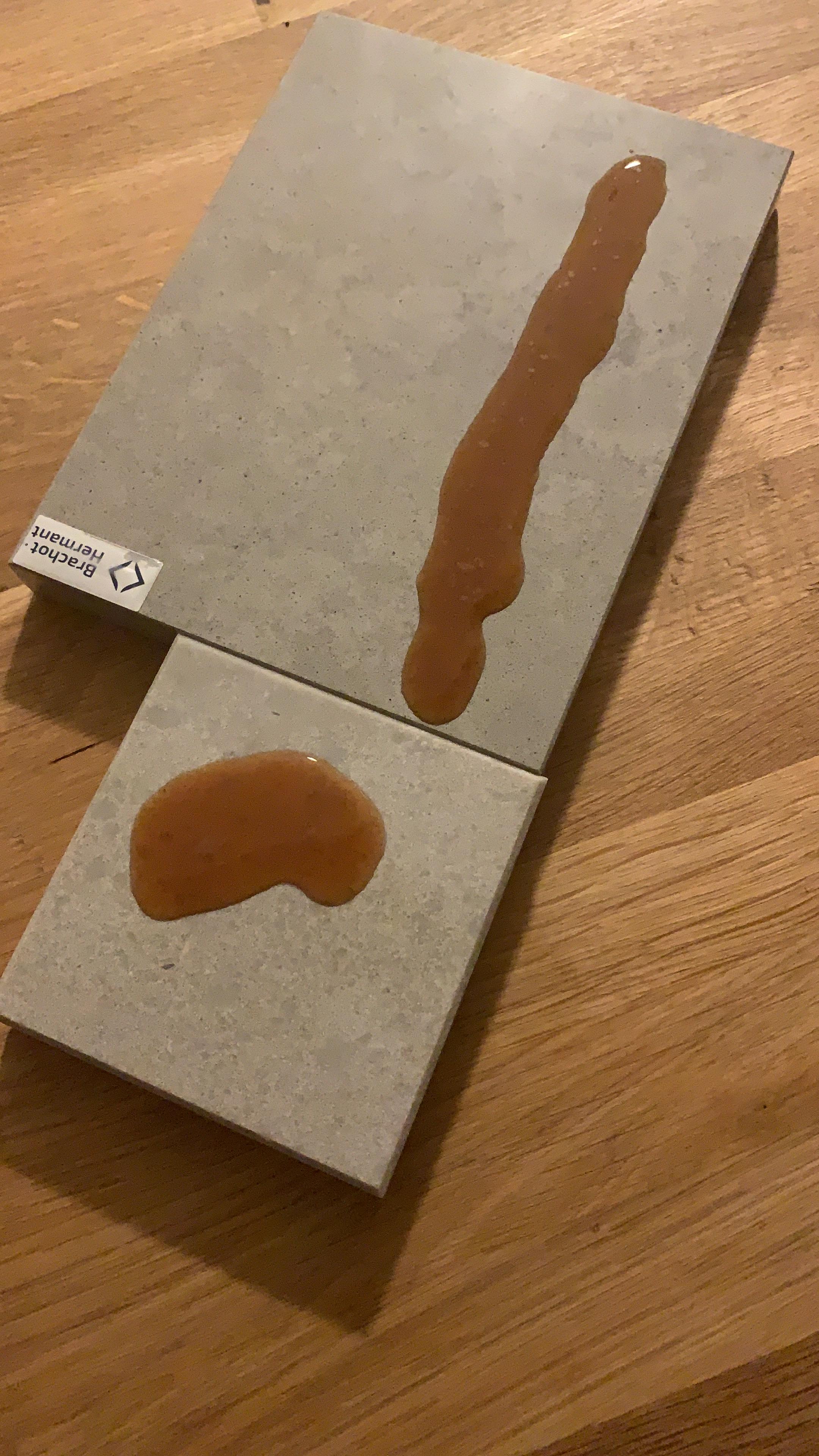

Adsibob Posted May 30, 2021 Author Share Posted May 30, 2021 Yeah, I’ve also been messing around with the samples. See photos attached. It survived the blackberry/ketchup/soy/honey and used tea bag 8h test, but the jury is out on the 24h tea test. My wife is convinced the sample has slightly browned where the tea was, but I’m not sure (it’s the Primordia colour, which has a very subtle and tiny undertone of beige/brown). (the other sample is Unistone by Brachot Hermant, which we are also considering.) Link to comment Share on other sites More sharing options...
ryder72 Posted May 31, 2021 Share Posted May 31, 2021 It is not possible to permanently stain quartz. Link to comment Share on other sites More sharing options...

MikeGrahamT21 Posted June 8, 2021 Share Posted June 8, 2021 Yes you can permanently stain quartz... I've managed it. Of course quartz is non porous, but the staining can come from a chemical reaction with the resin, which is actually worse. I casually put some rhubarb on my white tops, and now have a lovely little dark stain where the liquid oozed out of the rhubarb, tried alsorts to get it out but it won't shift. Turns out oxalic acid is terrible for staining the resin, and rhubarb has a lot of that in it. Ignore the samples for stain resistance also, i did exactly the same, dolloped a load of oil and turmeric on it, left it for days, and it wiped straight off, no stain, on the actual worktops, it leaves a stain, however this one does disappear magically over a day. Link to comment Share on other sites More sharing options...
