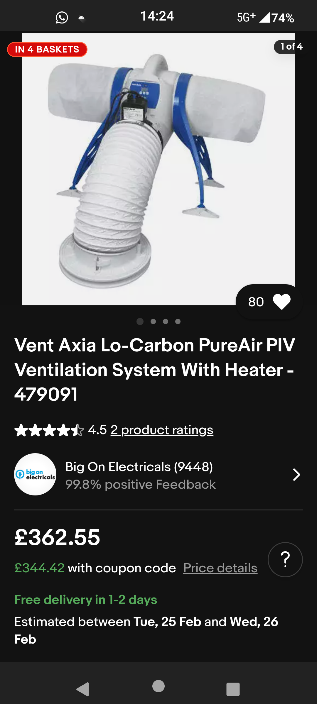

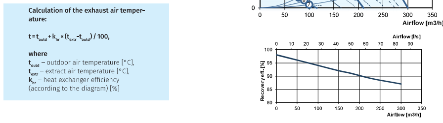

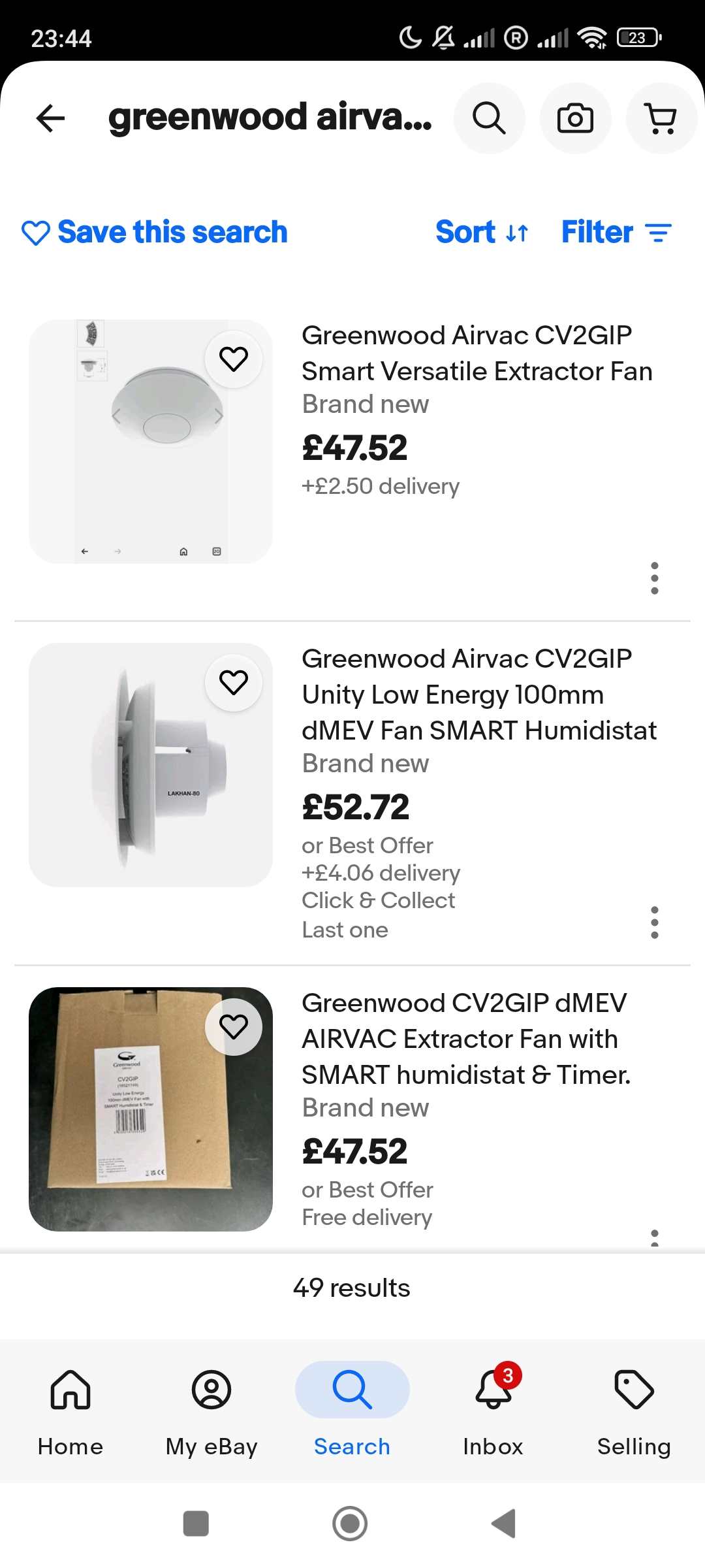

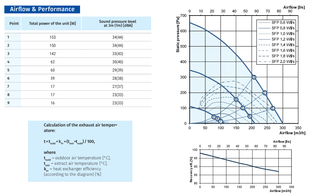

MortarThePoint Posted May 29, 2021 Author Share Posted May 29, 2021 11 hours ago, PeterW said: So given you need to do all this, why not use MVHR and get all the benefits ..?? I need to install extractor fans anyway so the trickle overhead is small there. That's a lot less involved than ducting to a centralised unit. I don't want this to be anti MVHR as I think it suits many well. Personally: - I don't like all the ducting of MVHR. - I don't like the expensive single point of failure of MVHR - For my situation I don't believe the economics of MVHR work. Across 6months of heating season the average dT is about 13C and so the PIV annual running cost is £172 electricity. MVHR only about halves that due to its fan having higher power consumption. Even at £172pa the payback time would be looking like >15 years, based on a modest £2500 outlay. I suspect there are other annual costs that raise MVHR to costing over £100pa to run, taking the payback beyond 30 years. MVHR is largely about the heat recovery. What would you do if you ignored the heat recovery part of it? Sell me on MVHR without mentioning heat recovery ? 1 Link to comment Share on other sites More sharing options...
