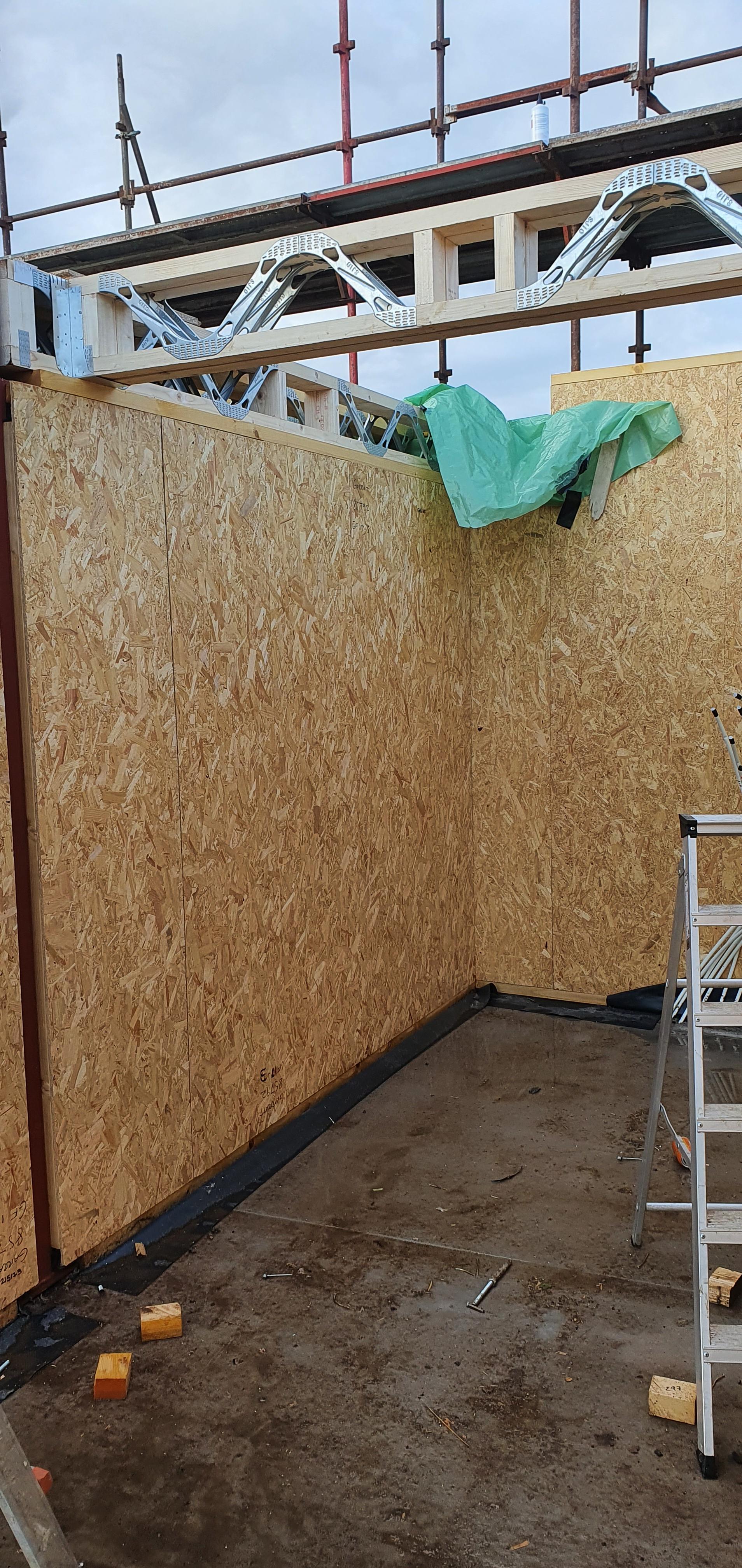

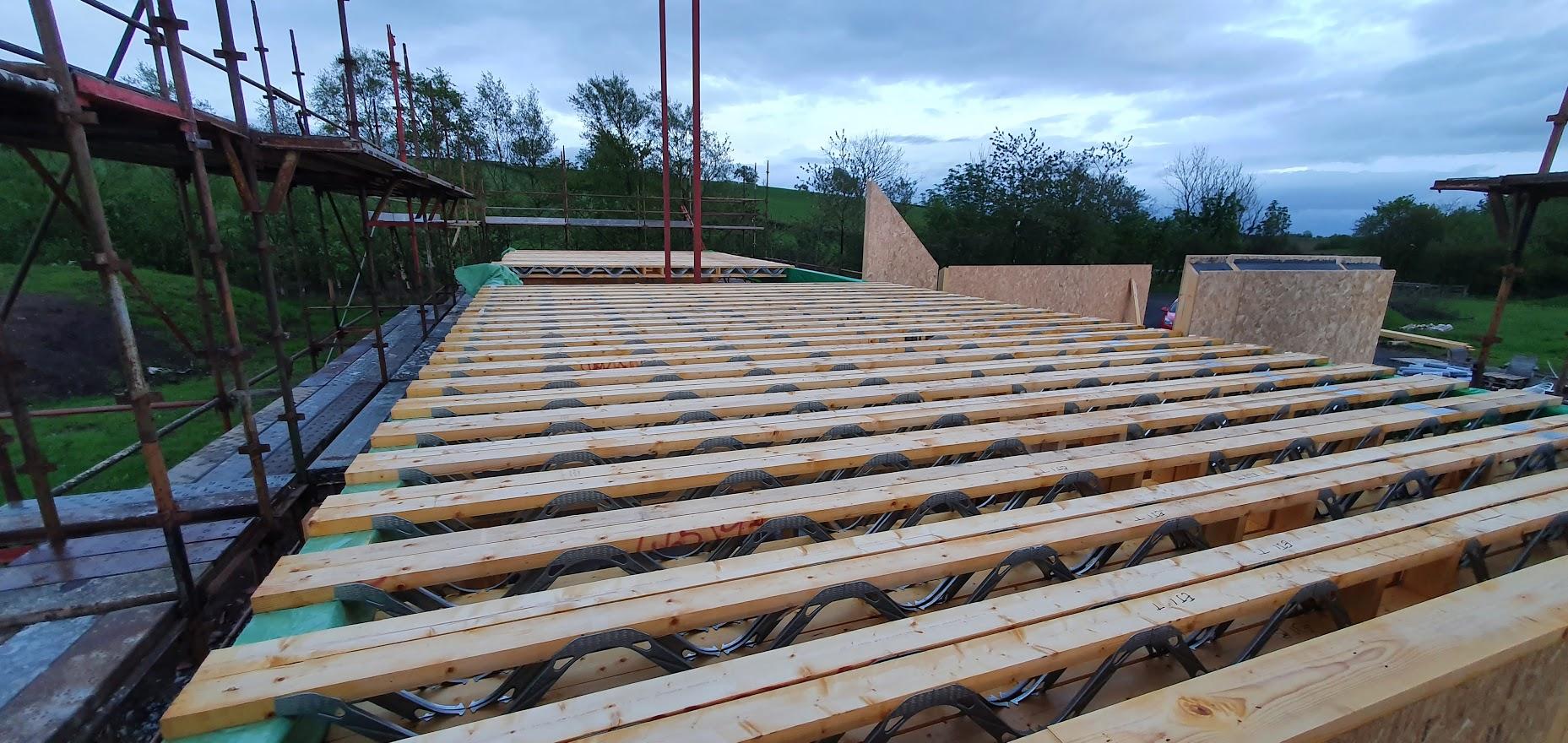

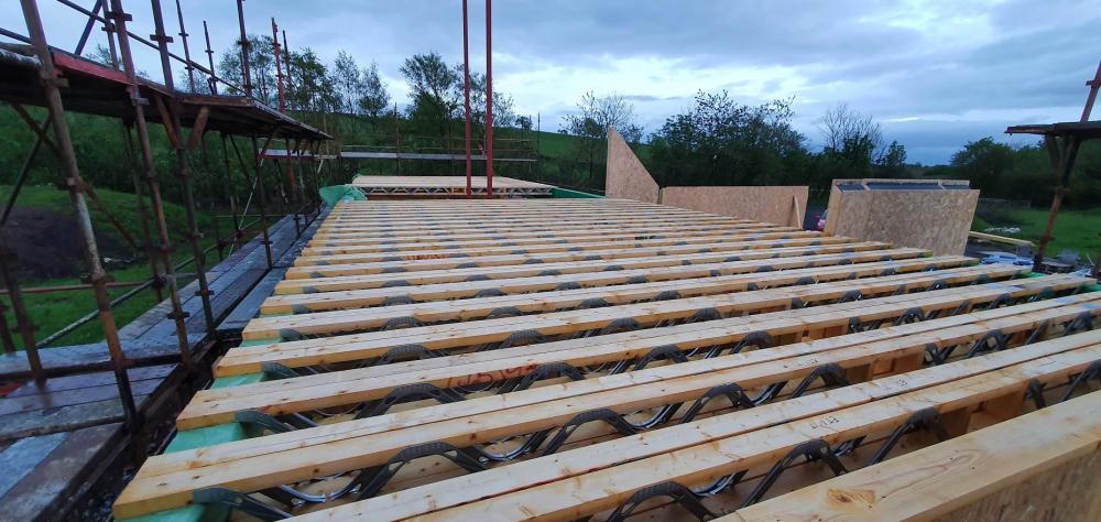

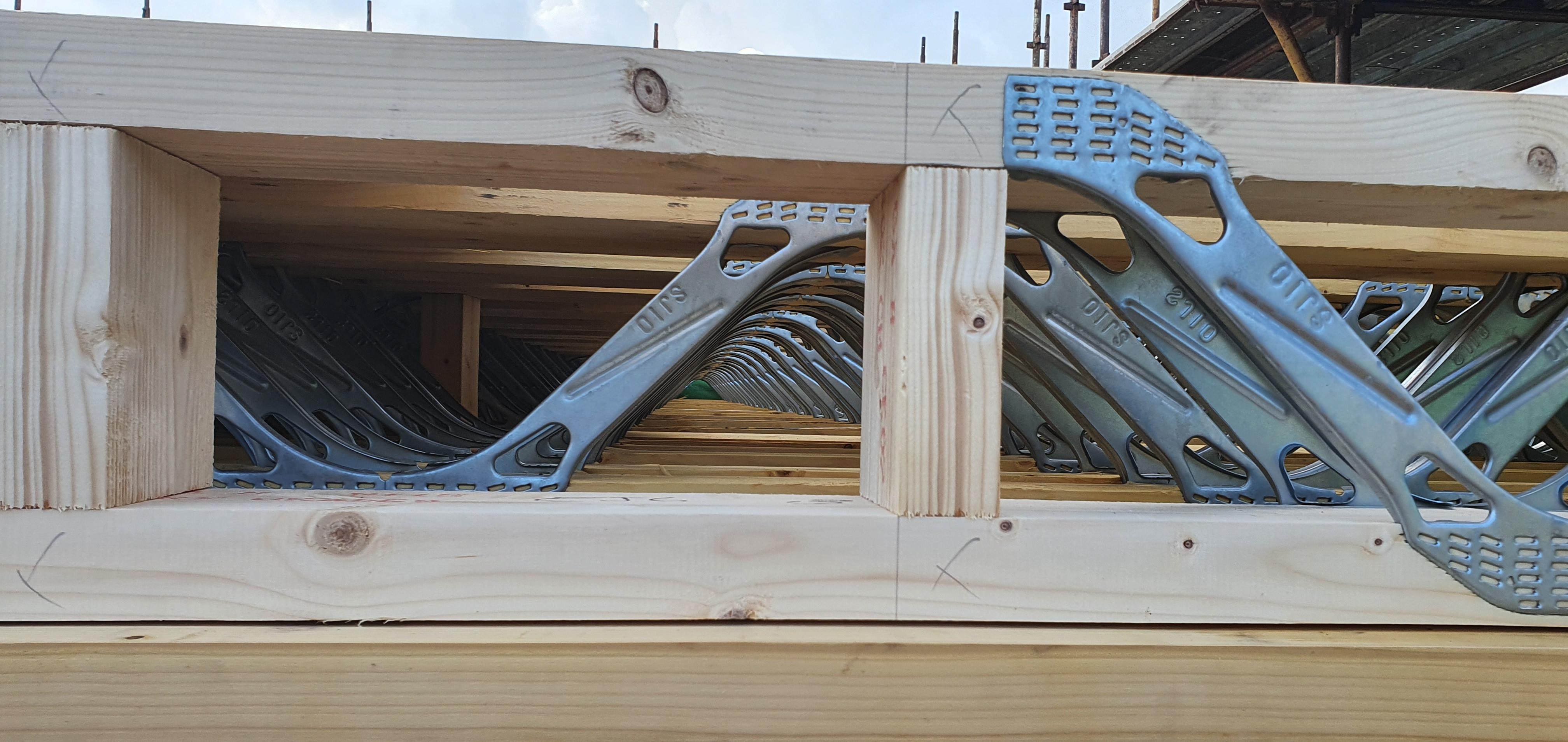

SuperJohnG Posted May 25, 2021 Posted May 25, 2021 My SIPS kit is going up. I hadn't bothered too much about joists before other than to check they were sufficient to stop any bounce. But now as the kit is going up I'm noticing there seems to be A LOT. They have doubled up joists and 400mm centres. so roughly 200mm spacing between the them, they are 254mm Joists. The designer said that was what the programme spat out...which is fine. It would seem the floor should be solid which was my main query initially which it definitely will be I assume, but I hadn't thought of any downsides. But now seeing it, looks like it will be a PITA to get insulation between the joists, then I'll have big areas with no insulation due to the joists. So a few questions: 1) Does this seem like a lot of Joists? (Note no load bearing walls on any joists) 2) How best to insulate between them? and will it be effective considering I cannot do where the joists are. I have rooms above the garage (which are outside the thermal envelope) so that would be my concern there. I have my master bedroom above the lounge and whilst heat loss isn't a concern there, noise transmission would be. I was planning on using resilient bars for the PB there anyways. 3) I assume now running services will be a pisser also?

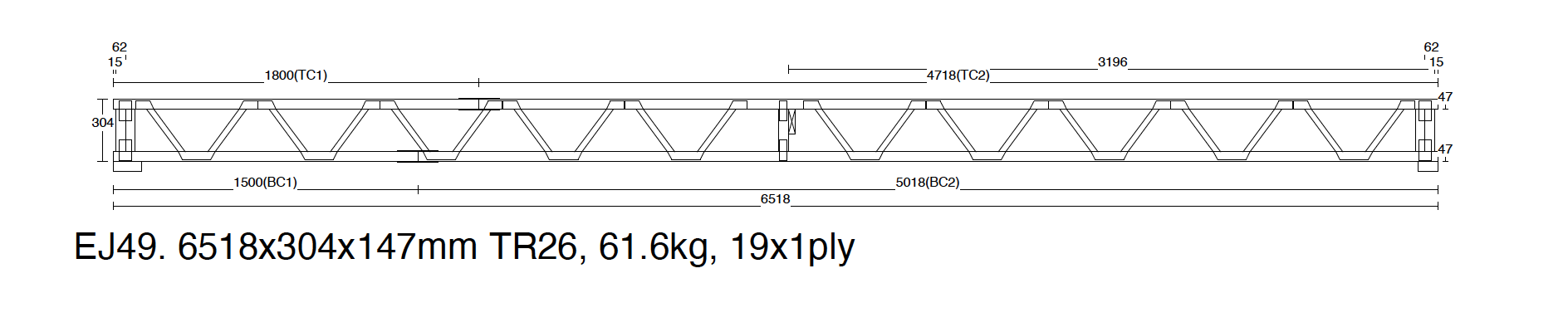

Thorfun Posted May 25, 2021 Posted May 25, 2021 what's the length of that span? we have 6.5m spans in our master bedroom and I requested a maximum deflection of 8mm and they came up with 300mm spacing and 304x147mm TR26 pozi-joists they're not doubled up either. obviously it's a bit late for you now they're in but doubling them up like that does seem rather excessive. I am also a bit concerned about the 300mm spacing which will leave about 153mm between edges of joists but the timber frame company said running pipes and utilities etc shouldn't be a problem and the floor will be rock solid. I guess I'll find out in a few months when the TF is up and I have to install the MVHR system! good luck and let us know how you get on.

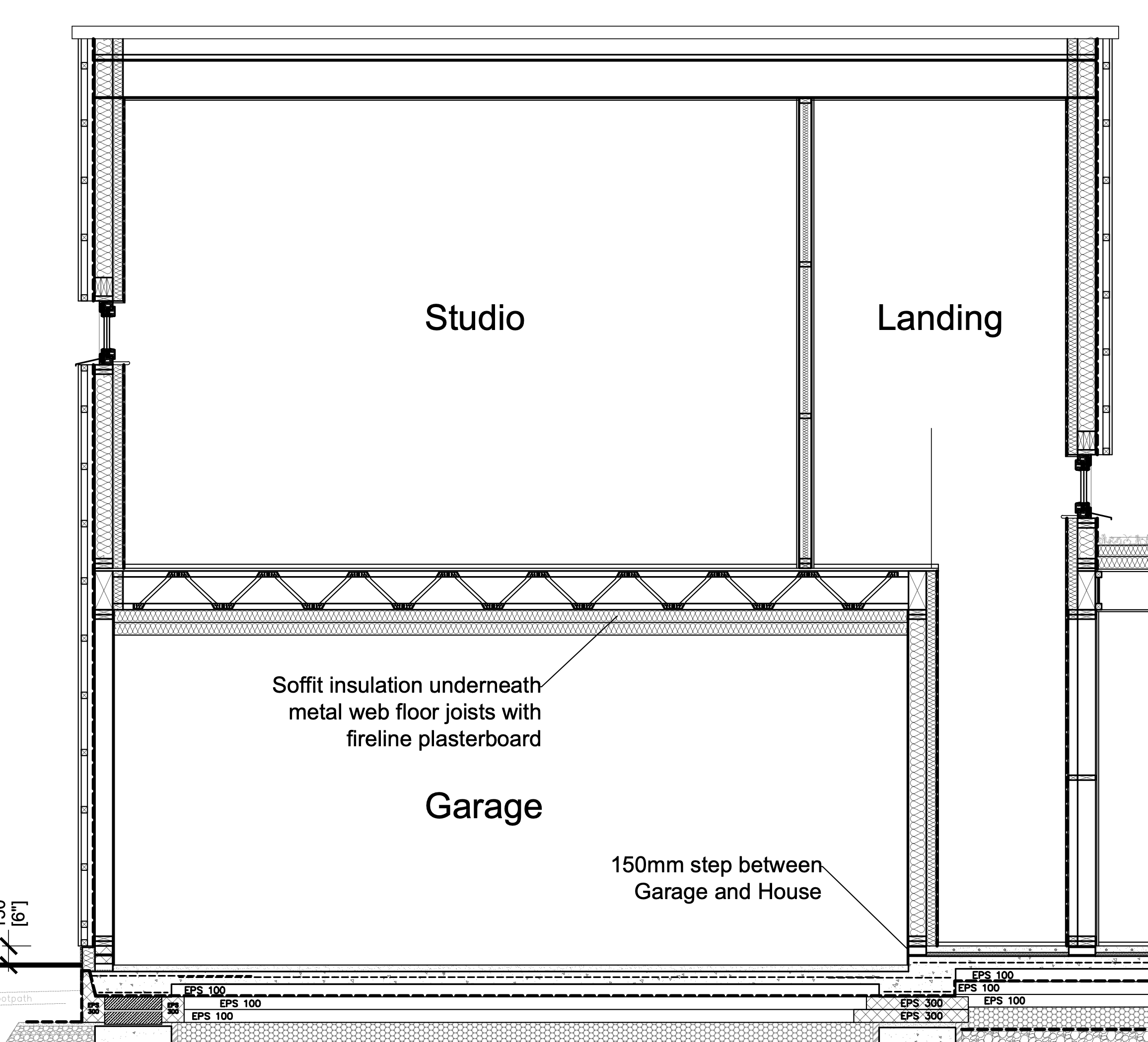

AliG Posted May 25, 2021 Posted May 25, 2021 For above the garage, if you have the height it will probably be better to put PIR under the joists, it will be almost impossible to properly insulate the floor otherwise. We once had a kitchen above the garage and it was always colder than the rest of the house so it is important. I would watch particularly for cables and pipes causing draughts in between and make sure it is well sealed. For the master bedroom, resilient bars will probably be enough. You could put some acoustic rockwool in there, but according to the tables it only adds 2dB to noise reduction anyway. The bars and sounbloc plasterboard would make a bigger difference. Again though a lot of the sound transmissiom will be flanking sound behind walls and it is at least as importnat to seal any paths the sound can travel along.
SuperJohnG Posted May 25, 2021 Author Posted May 25, 2021 On 25/05/2021 at 13:05, Thorfun said: what's the length of that span? Expand It's 6m span, I had checked the span tables and a 304 would have done it at 400mm centres. seems excessive for sure. I'll let you know how difficult it is to turn an MVHR pipe in there! On 25/05/2021 at 13:29, AliG said: For above the garage, if you have the height it will probably be better to put PIR under the joists, it will be almost impossible to properly insulate the floor otherwise. Expand Seems definitely like the logical approach. For the master I'll try and get some insulation in there, albeit it is 2dB a change by 3dB is actually a halving of the sound power. So it's significant. Soundbloc and resilient bars being the best bet. I'll need to do a wee bit of research on flanking sound, thanks. 1
Thorfun Posted May 25, 2021 Posted May 25, 2021 just to concur with @AliG our architect has specified insulation below the joists in the garage for the room above as per this drawing: definitely the logical approach. ?
Mr Punter Posted May 25, 2021 Posted May 25, 2021 I am pleased to see people specifying 8mm max deflection. If you need to install rigid pipes or ducting through these, do it NOW. You could blow in thermal insulation - either fibre or polystyrene. If you do the latter you will not be able to have PVC cables in that zone. 2

MortarThePoint Posted May 26, 2021 Posted May 26, 2021 On 25/05/2021 at 11:55, SuperJohnG said: 1) Does this seem like a lot of Joists? (Note no load bearing walls on any joists) Expand If you'd doubled up again you wouldn't need any OSB3 ? It'll be nice a firm though 3

George Posted May 28, 2021 Posted May 28, 2021 (edited) There are a lot of joists because 254mm deep joists is shallow for a 6m span. That's a span/depth* ratio of ~24 - achievable with a steel beam, but quite an ask for timber. This goes back to the architect setting too small a floor structural zone and on the SE/floor designer for not splitting the spans with a steel beam (although that would make service routing harder). *edit for clarity - span/depth ratios aren't for design purposes - they just gives an indication of how big a beam/joist should be Edited May 28, 2021 by George
