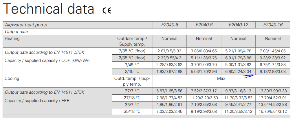

dpmiller Posted June 10, 2021 Share Posted June 10, 2021 43 minutes ago, Dave Jones said: When its close to freezing they perform poorly and freeze up that's just a fact. That is indeed a fact, especially when the RH is high. Which is why there is a defrost cycle. Which still results in an overall COP greater than 1.? Link to comment Share on other sites More sharing options...
joe90 Posted June 10, 2021 Share Posted June 10, 2021 43 minutes ago, IanR said: You've lost the argument, now it's time to move on... ? 56 minutes ago, Dave Jones said: You and the other fanboys can say they don't create noise all you like, your are simply wrong and you know it. Very disingenuous. Are you trolling ? no, I am one of the very happy people that have a heat pump so can base my opinion on actual facts. Link to comment Share on other sites More sharing options...
IanR Posted June 10, 2021 Share Posted June 10, 2021 28 minutes ago, dpmiller said: That is indeed a fact, especially when the RH is high. Which is why there is a defrost cycle. Which still results in an overall COP greater than 1.? As we are talking "facts". At "close to freezing", my HP is still pushing a COP of over 3. The drop in COP from a warmer outside temp accounts for the completely normal defrost cycle: 1 Link to comment Share on other sites More sharing options...
