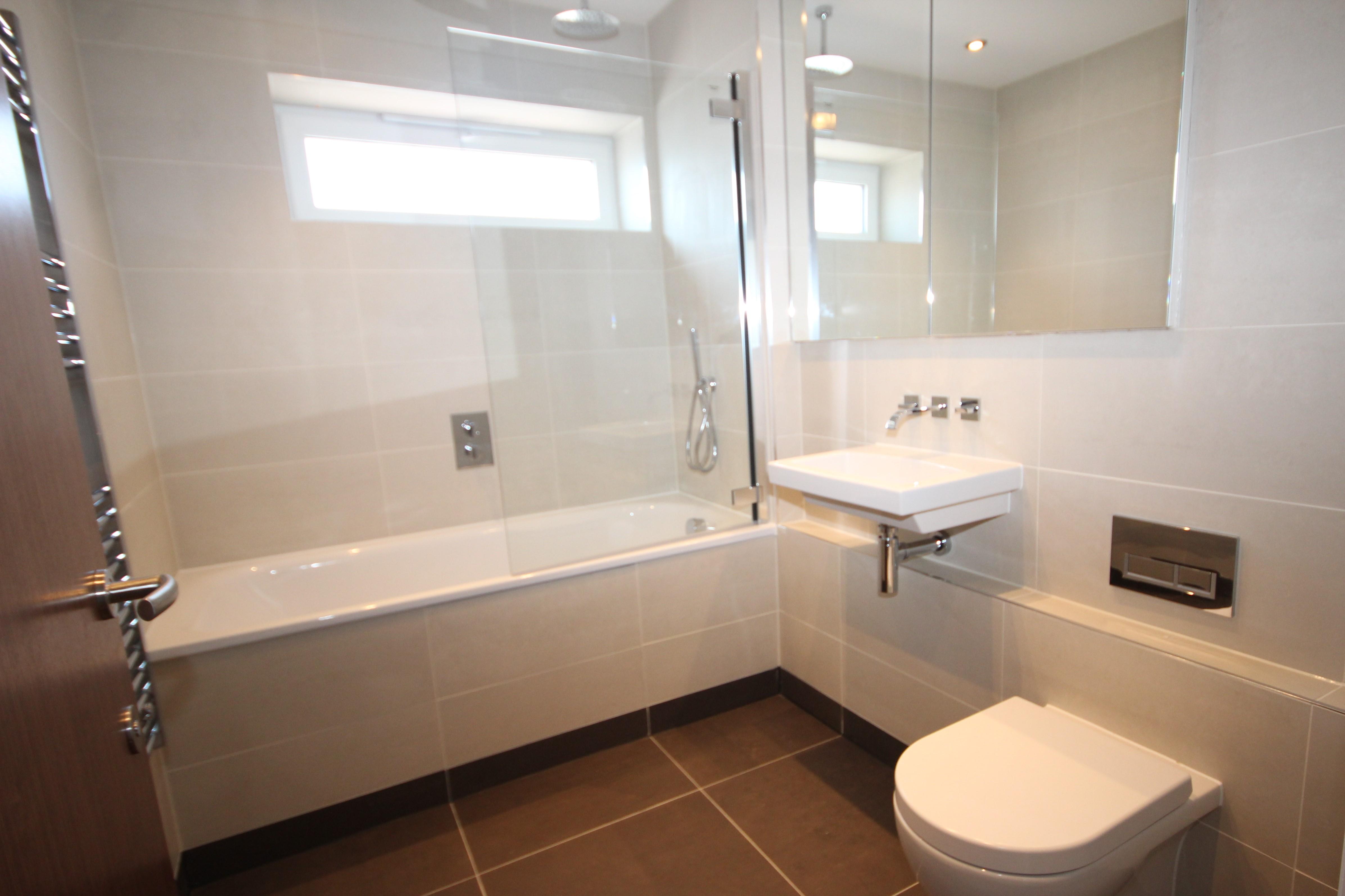

Vijay Posted May 31, 2021 Author Posted May 31, 2021 Visited a few places and came across these https://www.vado.com/notion-2-outlet-2-handle-thermostatic-valve which might be easy to use? Was told they are a very good make (like they'd say anything else) but has anyone installed or come across Vado shower valves? If anyone has any install pics of their shower valves/pipework, I'd really appreciate seeing them
Faz Posted May 31, 2021 Posted May 31, 2021 Stuck those Vado ones in 88 flats in London - didn't have any issues with them. These were handed over in late 2016. They are pricey though....
Faz Posted May 31, 2021 Posted May 31, 2021 Don't be tempted to use the matching wall hung Vado sink tap though - the tap body has about 1.5mm of tolerance to the final tiled wall position on first fix to be able to set the taps square as the backer plates screw on ?.
Vijay Posted May 31, 2021 Author Posted May 31, 2021 Cheers Faz. Always happy to pay a bit extra if the quality is there - especially when they are sunk into a wall. Will be normal basin taps, thankfully my Mum doesn't like the wall outlet taps. Anyone else had any experience of Vado shower valves?
