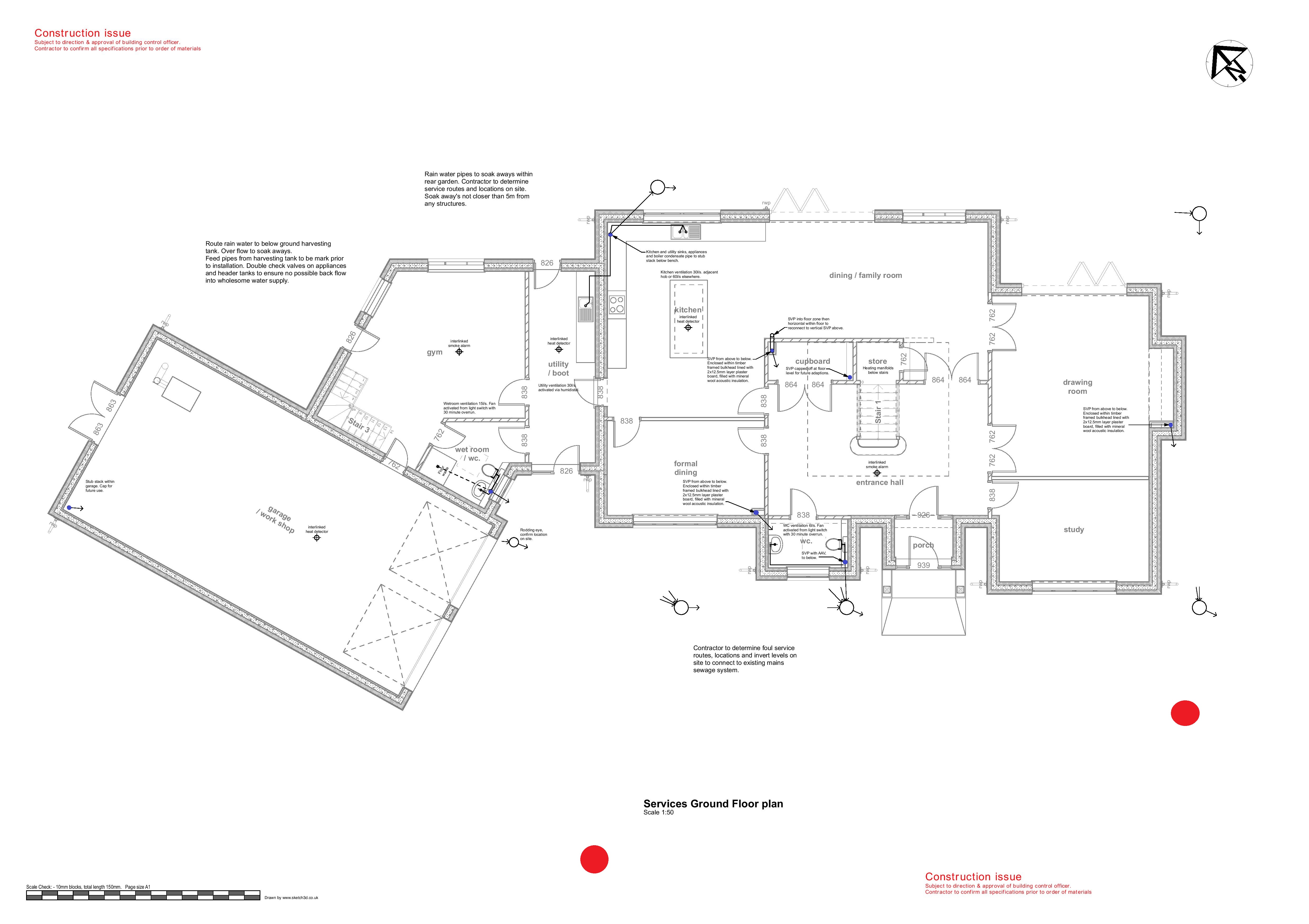

Vijay Posted March 20, 2017 Author Posted March 20, 2017 (edited) No, the pipes are run around the house but I always thought that it would be a shame to have manholes/rodding points showing in the rear outside area. This is the service plan which I've shown the manhole locations in red dots. As you can see it doesn't make sense not to utilise the manhole at the bottom (of the page). Drainage points are the blue dots Edited March 20, 2017 by Vijay

Oz07 Posted March 20, 2017 Posted March 20, 2017 I'd rather have ic's and ridding points than not have them and need them! You know you can use the lids which can be paved

Vijay Posted March 20, 2017 Author Posted March 20, 2017 12 minutes ago, Oz07 said: I'd rather have ic's and ridding points than not have them and need them! You know you can use the lids which can be paved Yeah I know you can get the paved ones but you can obviously still see they're there. Just looking for alternative solutions, but I completely understand your point of having them, cos if there's a blockage, I'd curse myself if I didn't

Vijay Posted March 23, 2017 Author Posted March 23, 2017 Don't know if this is a stupid question but can chambers be stacked up so you get more than 4 (or possibly 5 if it's the last one) inlets?
Nickfromwales Posted March 23, 2017 Posted March 23, 2017 Yes. Just put two in line with each other or a smaller chamber to take 2 into one before getting to the larger chamber.
Vijay Posted March 23, 2017 Author Posted March 23, 2017 Sorry Nick, I meant can they be stacked vertically? In line would then have 2 manhole covers surely?
PeterW Posted March 23, 2017 Posted March 23, 2017 Best practice is not to try and have large numbers of flows into a single IC especially if the main branch is only 110mm. What @Nickfromwales is suggesting is correct - you would use 2 or 3 smaller (ie 300mm) ICs to collate the flow from say 2 WCs or stacks, and then feed them to a further IC later in the chain, with a single 110mm (or 160mm if flow dictates) leaving the property. Do you have an M&E plan for the build as if you are looking at multiple WCs then be mindful of Part H and the various depths and falls required.
Nickfromwales Posted March 23, 2017 Posted March 23, 2017 1 hour ago, Vijay said: Sorry Nick, I meant can they be stacked vertically? In line would then have 2 manhole covers surely? You can make a 'back drop' chamber but it's a bit yesteryear. I'd just combine flows with smaller local ICs and then join the main run larger IC accordingly. Maybe best to run this past your BCO TBH rather than just steaming ahead .
Vijay Posted March 23, 2017 Author Posted March 23, 2017 3 hours ago, Nickfromwales said: You can make a 'back drop' chamber but it's a bit yesteryear. I'd just combine flows with smaller local ICs and then join the main run larger IC accordingly. Maybe best to run this past your BCO TBH rather than just steaming ahead . Understood, I will go inline but check with the BCO before I do anything
Vijay Posted March 23, 2017 Author Posted March 23, 2017 3 hours ago, PeterW said: Best practice is not to try and have large numbers of flows into a single IC especially if the main branch is only 110mm. What @Nickfromwales is suggesting is correct - you would use 2 or 3 smaller (ie 300mm) ICs to collate the flow from say 2 WCs or stacks, and then feed them to a further IC later in the chain, with a single 110mm (or 160mm if flow dictates) leaving the property. Do you have an M&E plan for the build as if you are looking at multiple WCs then be mindful of Part H and the various depths and falls required. The main pipework looks to be 160mm that runs through the plots with a 1:90 fall. I will definitely look at having IC's inline once I get my head around a layout. The fact I've never heard of an M&E plan would suggest not. What is it??
