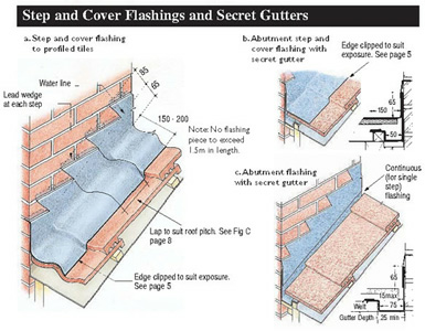

markc Posted May 21, 2021 Share Posted May 21, 2021 Well Done Crack in brickwork is through bricks and wider at the top so the wall is moving/falling away. Subsidence/foundation problem. The path/pavings are far too high (close to Damp Proof Course/membrane). path needs lowering and/or a drainage channel cutting around 6inches wide and at least 6 inches deep, filled with stones or gravel to prevent rising water. Flashing near gutter is just poor and water will be blown in, gutter appears to slope wrong way. Yes this building needs looking at. Link to comment Share on other sites More sharing options...

Temp Posted May 21, 2021 Share Posted May 21, 2021 I've had a look at the pictures and it looks like many other badly built houses. I agree with all the things @markc mentioned. The way the outbuilding has been built close to the house was probably acceptable to Building Control when originally built., however.. The pitch (steepness) of the roof looks quite shallow? Possibly too shallow for the tiles used? If so that could allow rain to be blown under the tiles. Any chance of a picture from further back so we can see the slope? I also suspect the flashing over the gap has failed or was badly installed allowing water into the void between the two buildings. The flashing should be wide enough to cover the first ridge of the tiles. This is a slightly different type of flashing but see the left hand side of this image.. Sorry if the council man laughed, I'm afraid they probably see far worse although that's no excuse. Link to comment Share on other sites More sharing options...
