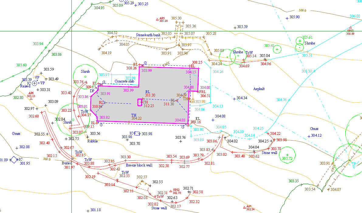

Barney12 Posted March 6, 2017 Posted March 6, 2017 On 05/03/2017 at 08:51, JSHarris said: Our ground works guy had one, one of the reasons he, and a couple of others, were shortlisted. Because our plot was a steep slope originally, from which we had to remove around 900 tonnes of spoil, marking out the site would have been a fair bit harder without one. We were lucky, in that there's an ordnance survey spot height nail in the lane right by the drive entrance, so we already had a known datum to work from, one that could "see" the whole plot and was fixed pretty permanently. Thanks. We had a 3d levels survey done as it was a requirement of the national park. I'm a complete novice on this subject and so need to read a bit more on how to properly read the document and use it. My regular groundworker has a slightly more "farmer" approach to marking out (Sorry the "farmer approach" is defined by "bout ere looks right lad" ) I'm assuming "GPS" (see top left of image) is a datum marker but I'm not so clear on "APS" (top middle as one example)? Its not helped by the fact that a lot of what you see in this screen grab was destroyed by a big ugly demolition crew!
Jeremy Harris Posted March 6, 2017 Posted March 6, 2017 (edited) The triangles are fixed survey positions, known as control stations, in your case GPS1 (top right) and GPS2 (bottom centre) seem to be the GPS-fixed control stations, which will be to a 3D accuracy of around +/-20mm or so for a decent survey GPS. The control stations marked "AP" may mean that they an assessed position from one or more of the GPS-fixed control stations, fixed using the Total Station on one of the GPS control stations, I think. All the other points are measurements relative to the closed-loop traverse datum established from the fixed survey control stations (the errors are corrected by closing a 3D loop around all the control stations, usually using a least squares method to evenly distribute any small errors). I suspect that your site needed several control stations, perhaps because the Total Station had to be moved around in order to "see" the prism on the survey staff. Total Stations are now pretty much one-man machines, that will automatically track the prism on the staff. The Total Station is set up on a control station and then the surveyor can just walk around the site with the staff and the Total Station will log the 3D position of the prism on command, taking account of the height of the tripod that it's mounted on and the height of the prism on the survey staff. Each surveyed position is marked with a "+" on the survey. Edited March 6, 2017 by JSHarris
ToughButterCup Posted March 6, 2017 Author Posted March 6, 2017 @Barney12, I should just add to J's note above, that I went round to check a random selection of pile markers each of which had been marked by a total station. I found 1 that was exactly 1meter out. Hmmmm
Jeremy Harris Posted March 6, 2017 Posted March 6, 2017 11 minutes ago, recoveringacademic said: @Barney12, I should just add to J's note above, that I went round to check a random selection of pile markers each of which had been marked by a total station. I found 1 that was exactly 1meter out. Hmmmm Sounds like finger trouble on the key pad! The offsets have to be manually entered into the total station, plus if doing a closed traverse base line then that needs manual entry too.
ToughButterCup Posted March 6, 2017 Author Posted March 6, 2017 4 minutes ago, JSHarris said: Sounds like finger trouble on the key pad! Exactly, I wrote the post to suggest that a quick dirty check is always worth it....
