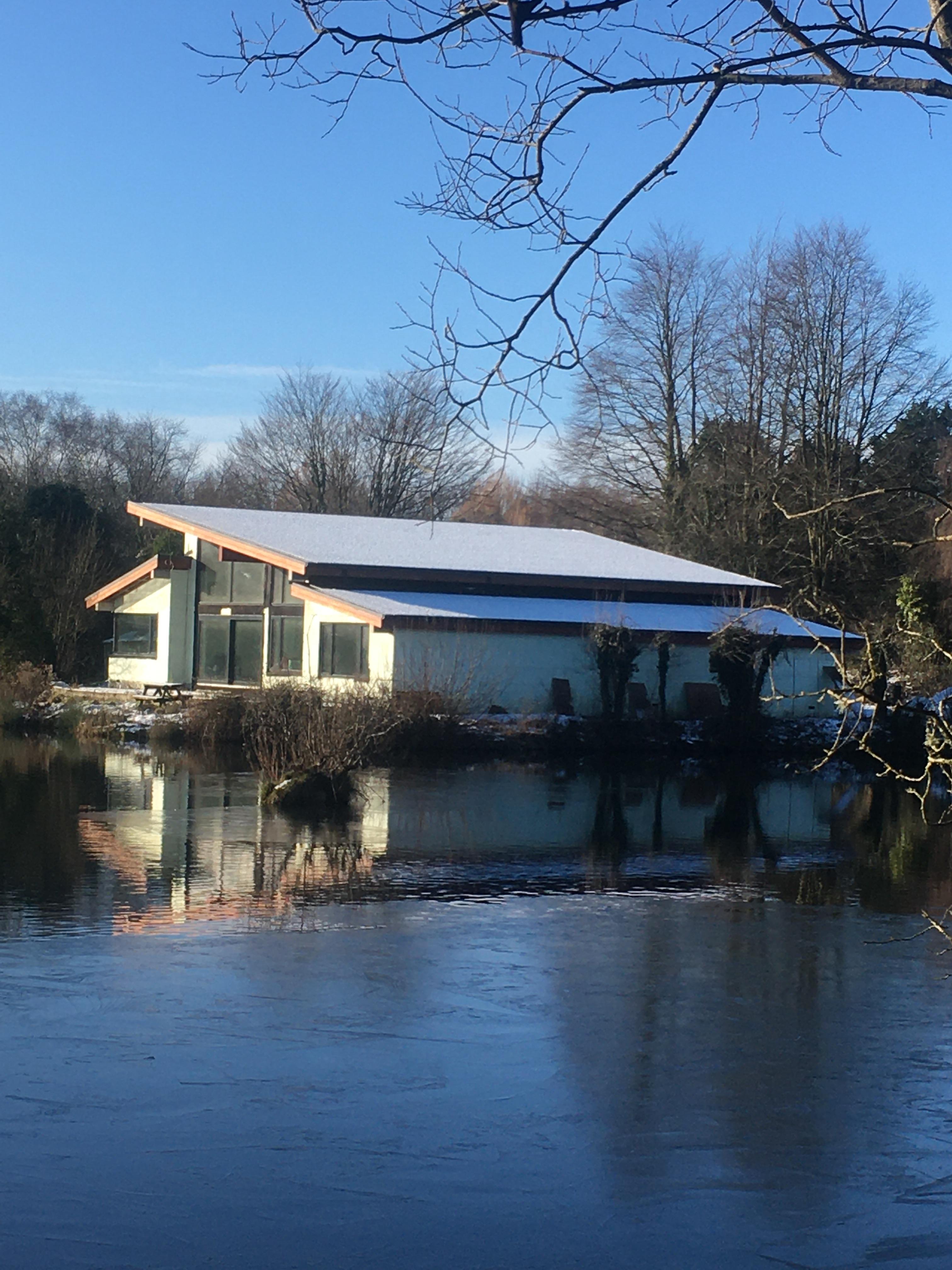

saveasteading Posted May 19, 2021 Share Posted May 19, 2021 Not exactly, but have designed other buildings to allow a river to overflow underneath. Build up to 1m in any material you fancy: brick/ concrete/ steel. Make a deck on it in concrete. Waterproof. Build timber house on top. Some areas will want to allow the flood under the building, others allow enclosure. Have you established that this is allowed? There is usually the 'exception' test to satisfy. 1 Link to comment Share on other sites More sharing options...

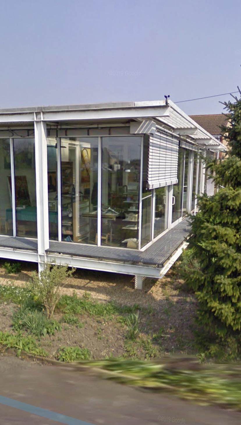

saveasteading Posted May 20, 2021 Share Posted May 20, 2021 Have done buildings on sleeper walls a few times, for reasons other than flood. Steep hillsides basically so some faces are high in the air. If the authorities are happy that the flood flows around your house, then you can infill, but promise not to use it as a handy storage area. In case it really does flood it would be prudent to let it dry quickly, so let lots of air through. Yorkshire boarding? hit and miss. The risk might be of animal life enjoying the sheltered area. Door/gate in it for maintenance? If the council wants you to allow water under the building then perhaps they will still allow hit and miss boarding. For a more rugged effect you can use scaffold boards vertically, and stained. Link to comment Share on other sites More sharing options...

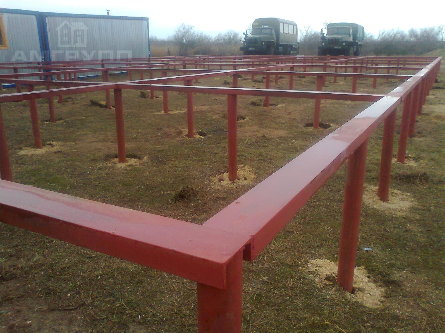

DragsterDriver Posted May 21, 2021 Author Share Posted May 21, 2021 9 hours ago, Mr Punter said: You will need either to elevate the building or have a sacrificial floor, like parking etc. For 1m I would just elevate and where possible build up the surrounding ground levels. Only 4 courses of blocks so no biggie. I do like the look of piles and using a Rsj frame to build off! I need to find a picture. Link to comment Share on other sites More sharing options...

DragsterDriver Posted June 1, 2021 Author Share Posted June 1, 2021 Screwpiles with a steel ringbeam looks handy! Link to comment Share on other sites More sharing options...
