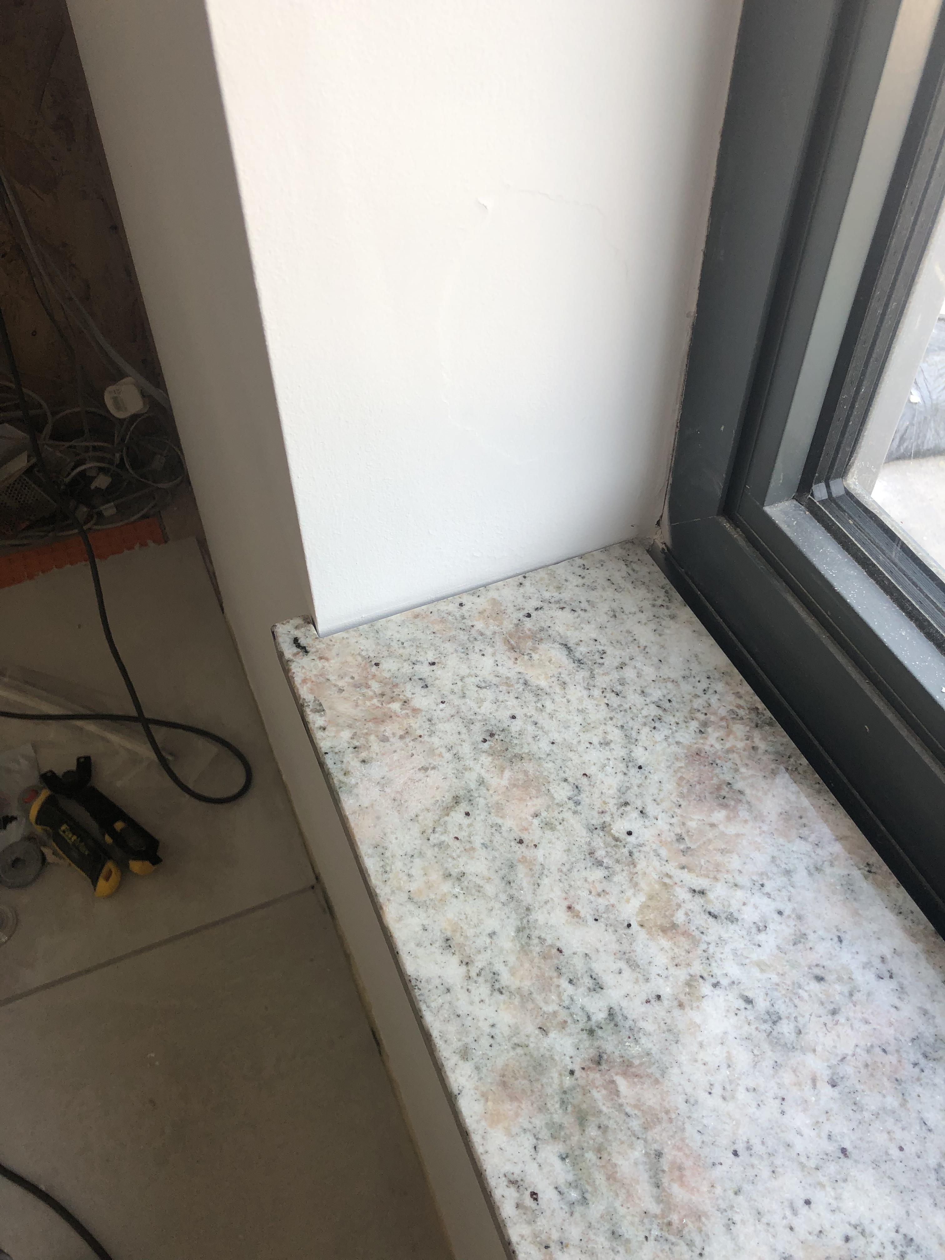

Pocster Posted June 30, 2021 Author Share Posted June 30, 2021 Is it me or is it them ? Ffs Sill in . I gave them depth from window to edge of plasterboard because I didn’t know how ‘big ‘ the nibs are . They’ve cut it but included the nib returns in the total depth not added them . Obviously it will be my fault . Was thinking anyway if silicone along that edge looked crap would fit some nice chrome bead - guess I’ll have too now . Guess I can’t measure anything correctly ? Link to comment Share on other sites More sharing options...

Pocster Posted June 30, 2021 Author Share Posted June 30, 2021 18 minutes ago, Russell griffiths said: Did you send a drawing .? if not then you will need to put it in the pile with the drive on glass. No i emailed dimensions ( with no nib ) When I went in to choose granite guy drew a sketch and put those measurements on it . He added the nib and I didn’t notice I.e ask him to add the nib depth to the overall depth . So my fault I guess . Not to worry though ! ??? Link to comment Share on other sites More sharing options...
PeterW Posted June 30, 2021 Share Posted June 30, 2021 Cut the wall with a multi tool and recess it half way and it will close up the back gap. Link to comment Share on other sites More sharing options...
Russell griffiths Posted June 30, 2021 Share Posted June 30, 2021 57 minutes ago, PeterW said: Cut the wall with a multi tool and recess it half way and it will close up the back gap. I thought that, but wondered if @pocster would understand, so decided to keep my mouth shut. 2 Link to comment Share on other sites More sharing options...

Pocster Posted July 9, 2021 Author Share Posted July 9, 2021 On 30/06/2021 at 15:08, Russell griffiths said: I thought that, but wondered if @pocster would understand, so decided to keep my mouth shut. I didn’t want to do that . I thought it would look crap . I fitted it “ as is “ and will just use some slim metal trim at the rear . I like metal trim . Link to comment Share on other sites More sharing options...
