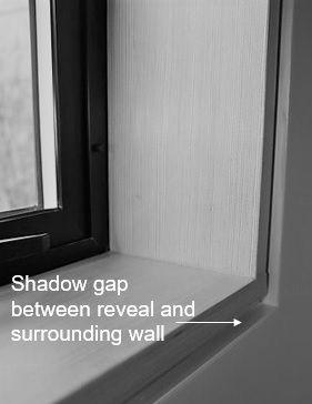

Here's the closest I could nick in less than a minute: looks nice - PITA to clean.
and

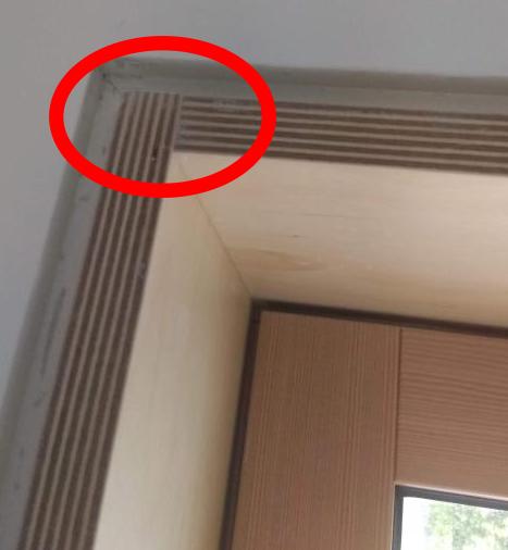

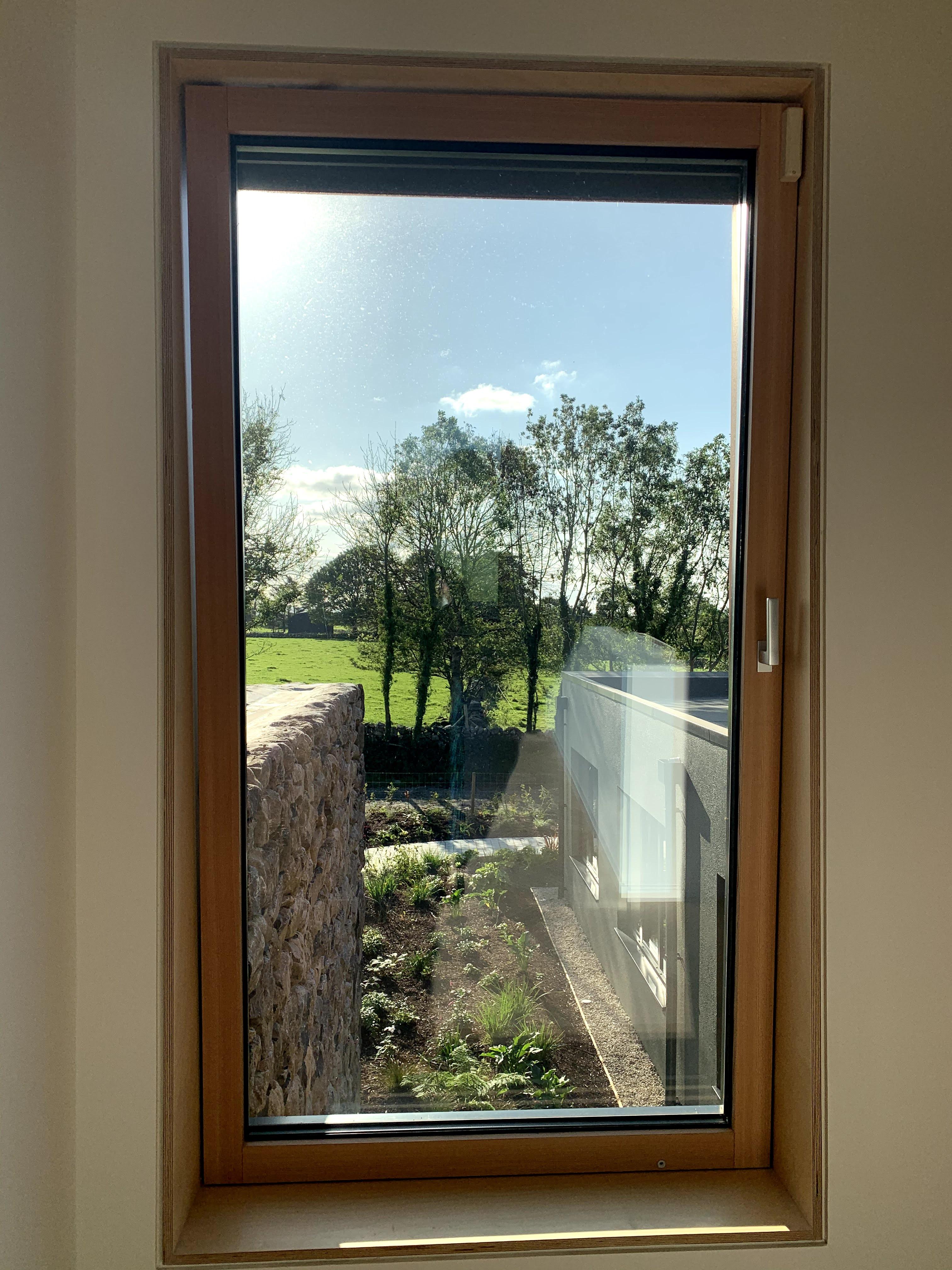

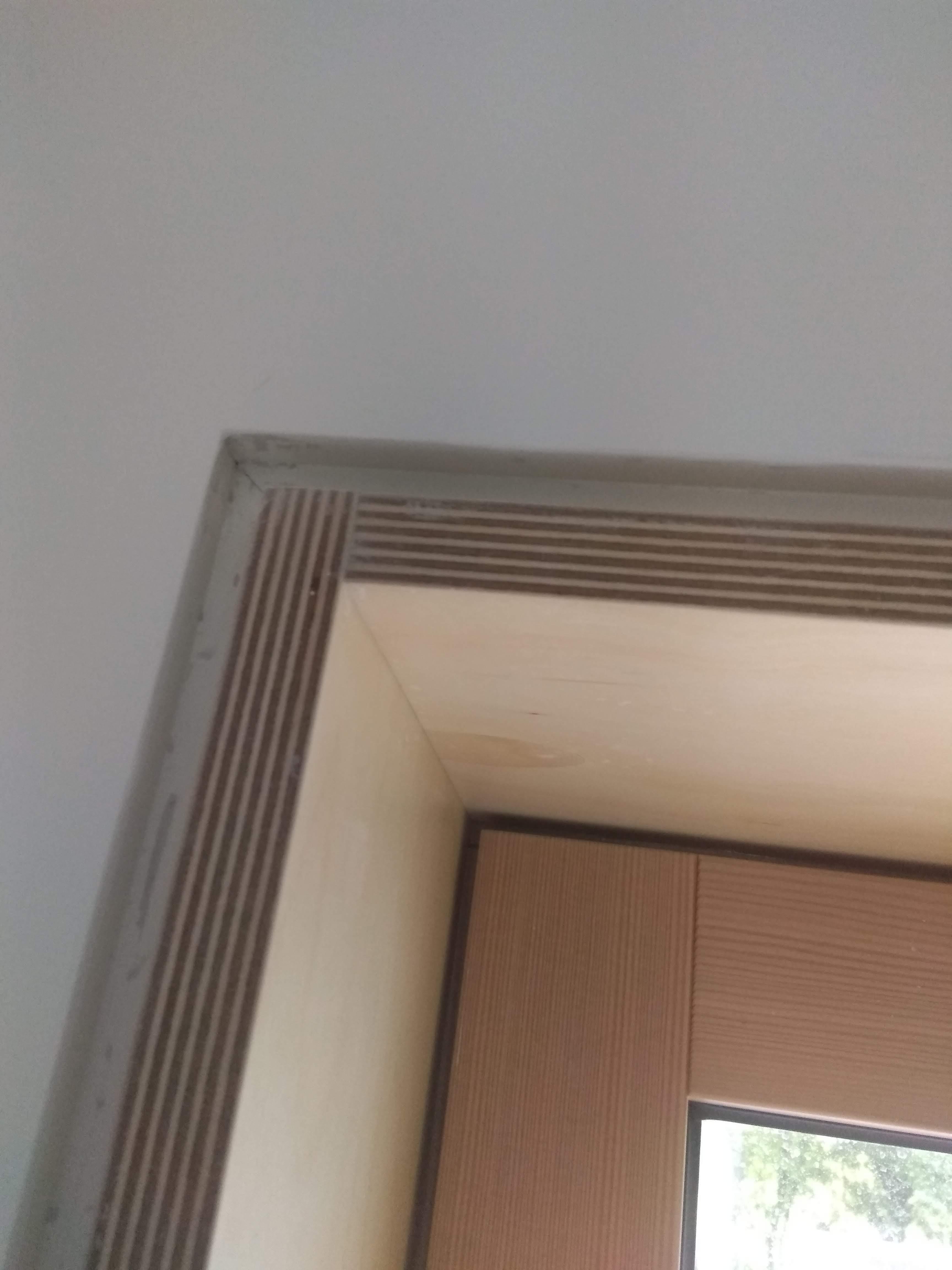

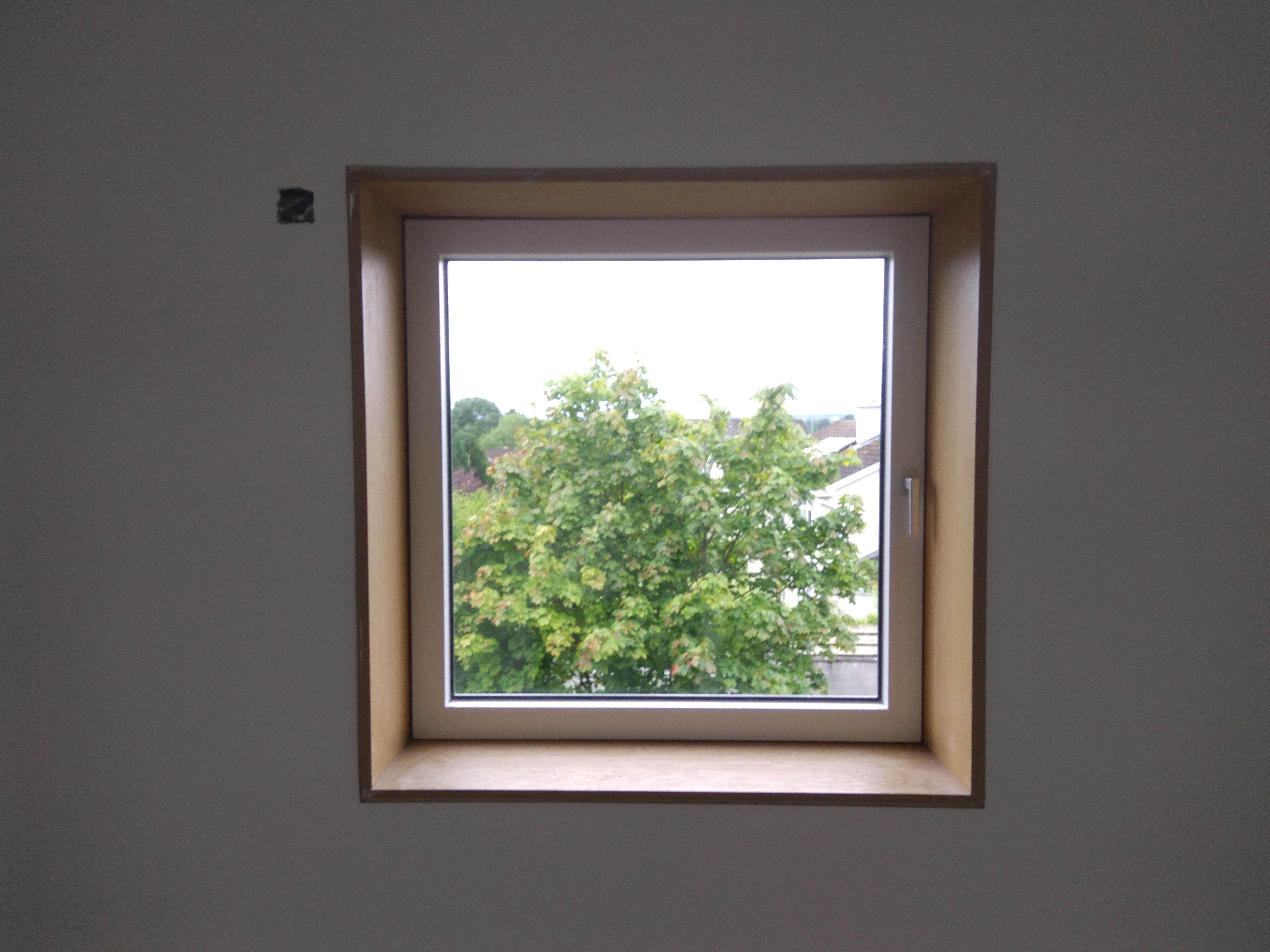

Yes I've done it in my own house and others. Some of the below photos are before moving in and they window surrounds were cleaned or shadow gaps tidied but you get the idea.
Edit: one of the below is veneered MDF and the other is Birch ply so you've options.
Edited by Dudda
That is really sharp @Dudda
Next time the corners will be mitred I bet ....?

Not a hope in hell. It was very difficult to do that as is. First project each part was put in individually. It was a refurbishment and the walls weren't plum and blockwork so rough. Incredibly hard. Second project was a new timber framed house. This was easier and the walls were more plumb and timber made it easier. The surrounds were made up in a workshop and lifted into place.
For some of them we have in the top part a recessed cut out in the top of the timber which is where the blind is. This has to be designed in early enough as you could have structure or a DPC above the window in the way. Another one has birch ply shutters incorporated into the sides that disappear when open. Again this was difficult but looks well.
