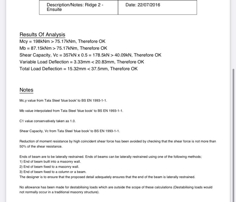

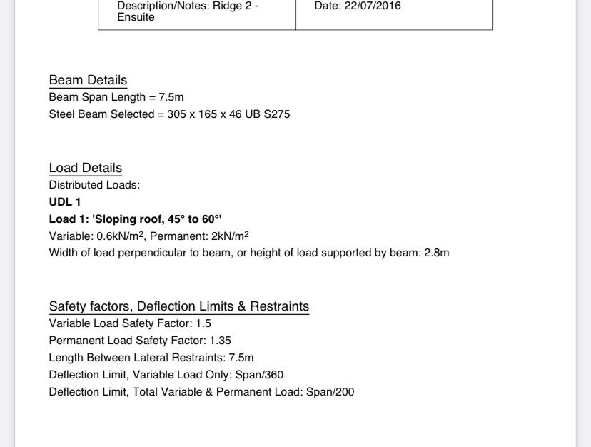

Ok so for those that want to see a pretty horrendous - but acceptable - load graph then is is from a job we did but did not use the steel in the end as it was designed without the ridge as a single steel.
This is the sort of detail I get from the SE - note it’s in three sections which is the inputs, the graphs and the notes.
First off, this is a beam that is 305 x 165 - no small beam. At 46kg/m it would weigh in over 350kgs. It is purely a ridge beam, so no real additional loads.
What’s worth noting is the Deflection Limits. Fully loaded, it’s Span/200. That means if you want a 4.5m span that only deflects 5mm max, you need to tell your engineer you want Span/900..!!  That is the bit most people get wrong or miss, as it’s a standard value unless you change it..!!

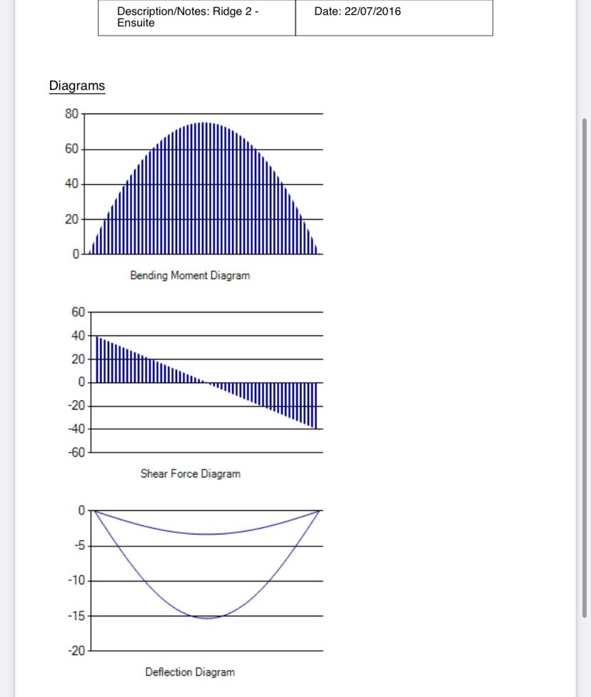

Now look at the graphs.
The bottom is the deflection graph - at 3.75m it would be deflecting over 15mm.
Now finally look at the notes. Note the comments about assumptions made, and the deflection being within the tolerance ..!!
This is a beam that is 305mm deep, with a decent profile and yet a 37.5mm deflection would have been acceptable ..?? That’s 1 1/2” in old money ...
So maybe a few people need to talk to their engineers and explain their requirements and a lot of these door issues wouldn’t occur.
