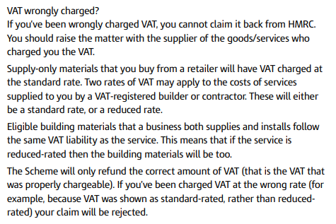

Labour-only and supply and fit work carried out by others on your conversion may also qualify for 5% VAT, as discussed in:
https://www.gov.uk/guidance/buildings-and-construction-vat-notice-708#section7
https://www.self-build.co.uk/our-guide-claiming-back-vat-self-build/
etc
You can claim all the VAT back anyway at the end anyway (assuming you qualify etc), but paying only 5% VAT upfront rather than 20% helps your cashflow during the build and reduces the 'risk' you have stored up with HMRC.
We've found so far that all contractors have been happy to charge only 5%, provided we sent them the right bits of paper & links justifying it before they sent any invoices. Make sure the service is one that qualifies for a reduced VAT rate (and ultimate refund) first though. See the link in the HMRC guidance about this. E.g. 'Professional services' such as architects don't qualify, neither does scaffolding. But things like demolition, groundwork, building, etc do.
CIL is important to establish as it can be expensive or it can be nothing. From what I remember, I think even self-build conversions under Class Q can be liable where 'new' floorspace is created, but it's worth checking in detail and then confirming in writing with the council (IF CIL applies at your council).

 Not my area of expertise, but I'd double-check that.  I don't think you can pay 5% VAT and claim it back.
Yes you can on a conversation if its being converted to a separate dwelling. Not if can't be sold seperately to the existing house.

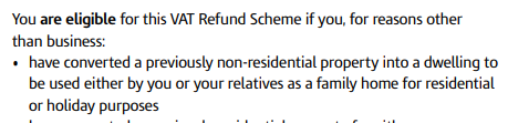

Had me worried there, but checking the conversion VAT reclaim form I think confirms it, and the point about whether a conversion for relatives also qualifies. But this is my naïve interpretation and best to get it checked.
Can you reclaim VAT on self-build conversion invoices charged at reduced rate?
This implies that you can claim refund on reduced VAT rate work, if that rate was charged on the invoice.
Can you reclaim VAT on self-build conversion for your parents?
Both from the VAT431C form
https://www.gov.uk/vat-building-new-home/how-to-claim
https://assets.publishing.service.gov.uk/government/uploads/system/uploads/attachment_data/file/828048/VAT431C_form_and_notes__1_.pdf

This is the bit that I’m not clear about
You are not eligible to use the DIY Housebuilders Scheme if you:
• have converted a property that, because of a term in the Planning
Permission (or similar permission such as a Planning Agreement) cannot
be sold separately or used separately,

This is the bit to me that actually makes it clear. Class Q PD is for the creation of a new Residential unit, so there is no term in the Planning Permission that stops it being sold separately. It doesn't need to "yet" be separated off on to its own Title, it just needs to be capable of being.
Conversions can also make use of the 5% VAT rate for Supply and Install work, t help cashflow.
Then if that’s the deal with Class Q it should certainly make it eligible for the scheme.

Conversions are subject to a 5% VAT rate for supply and install, rather than the 0% of a New Build. However that 5%, + the full 20% of supplied goods can then be reclaimed at the end.
1 hour ago, gc100 said:
My build is class Q . I was always lead to believe we can only claim back 15% of the VAT and not the full 20%
As @IanR says this is a common misunderstanding. You must be billed @ 5% for all eligible labour and supply and fit work, and your supply only materials will be billed to you with standard VAT. When you do your claim you can claim back the 5% billed for labour and supply & fit, and the full 20% paid on materials.
Unlike new builds where labour and supply & fit are zero rated, all conversions and properties empty for 2 years are billed @ 5% VAT initially but you can still reclaim this as you are creating a new dwelling (subject to you meeting all of the scheme rules). Not all of the projects billed at 5% will be eligible for a full VAT reclaim and the rules are complex so if all are billed @ 5% it avoids trades having to determine whether to zero rate certain conversion works or not. Have a read of the claim form and notes. You will see that there is a separate section of the form for reclaiming the 5%.
