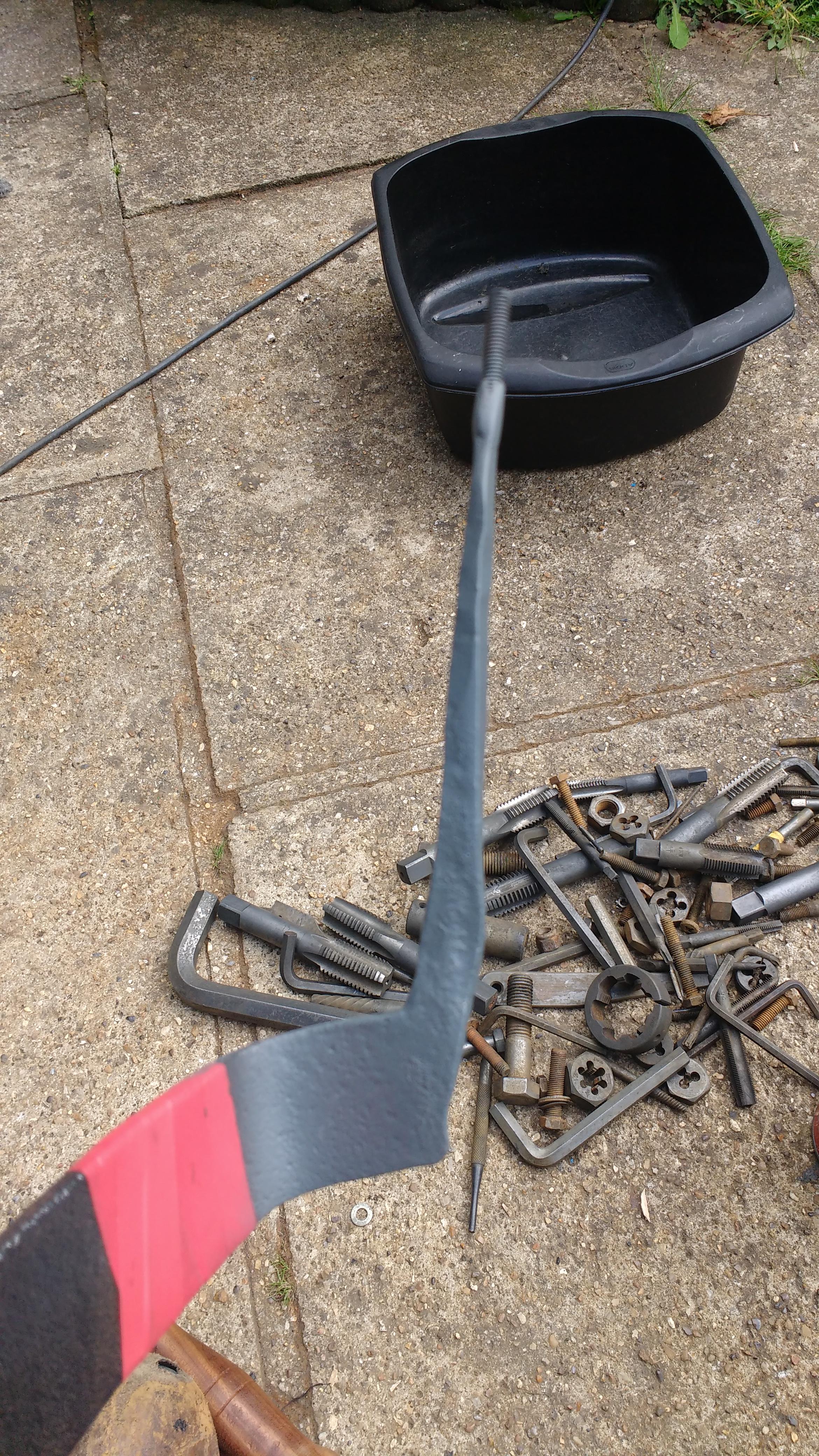

Onoff Posted May 4, 2021 Share Posted May 4, 2021 How, traditionally, are handles fitted to sythes like this? These handles are rotten with woodworm. Plan is to remake them in local timber. Is it called a "tang" the section that fits into the handle? Something in the back of my mind is saying the tangs were heated up and pushed into the wood... Link to comment Share on other sites More sharing options...
markc Posted May 4, 2021 Share Posted May 4, 2021 Yes its a Tang, hole drilled in the handle under size, tang heated and then pushed into the timber to burn a perfectly sized and shaped hole. Sometimes a small amount of tree resin or hoof glue was used to fix handles in place after burning. 2 Link to comment Share on other sites More sharing options...
ToughButterCup Posted May 4, 2021 Share Posted May 4, 2021 Once that was done (see above) , my dad always used to put the handle and the bottom bit of the scythe in a bucket of water and leave it for a good while. Swole up a treat. Link to comment Share on other sites More sharing options...

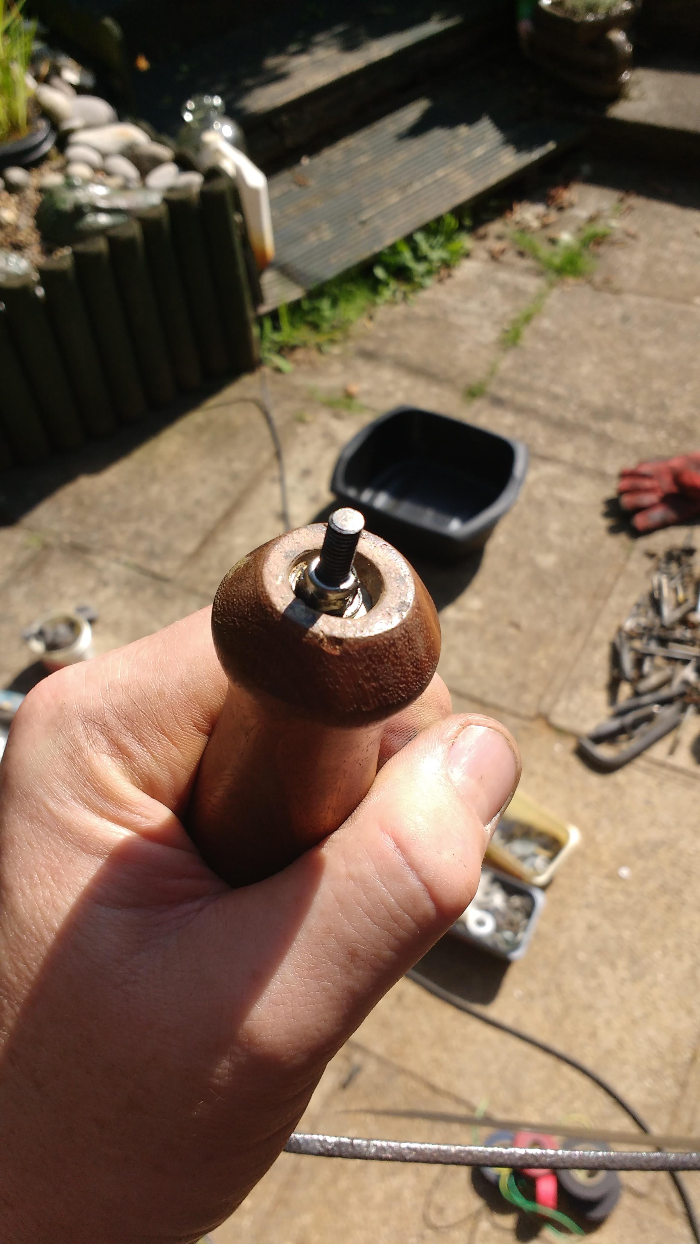

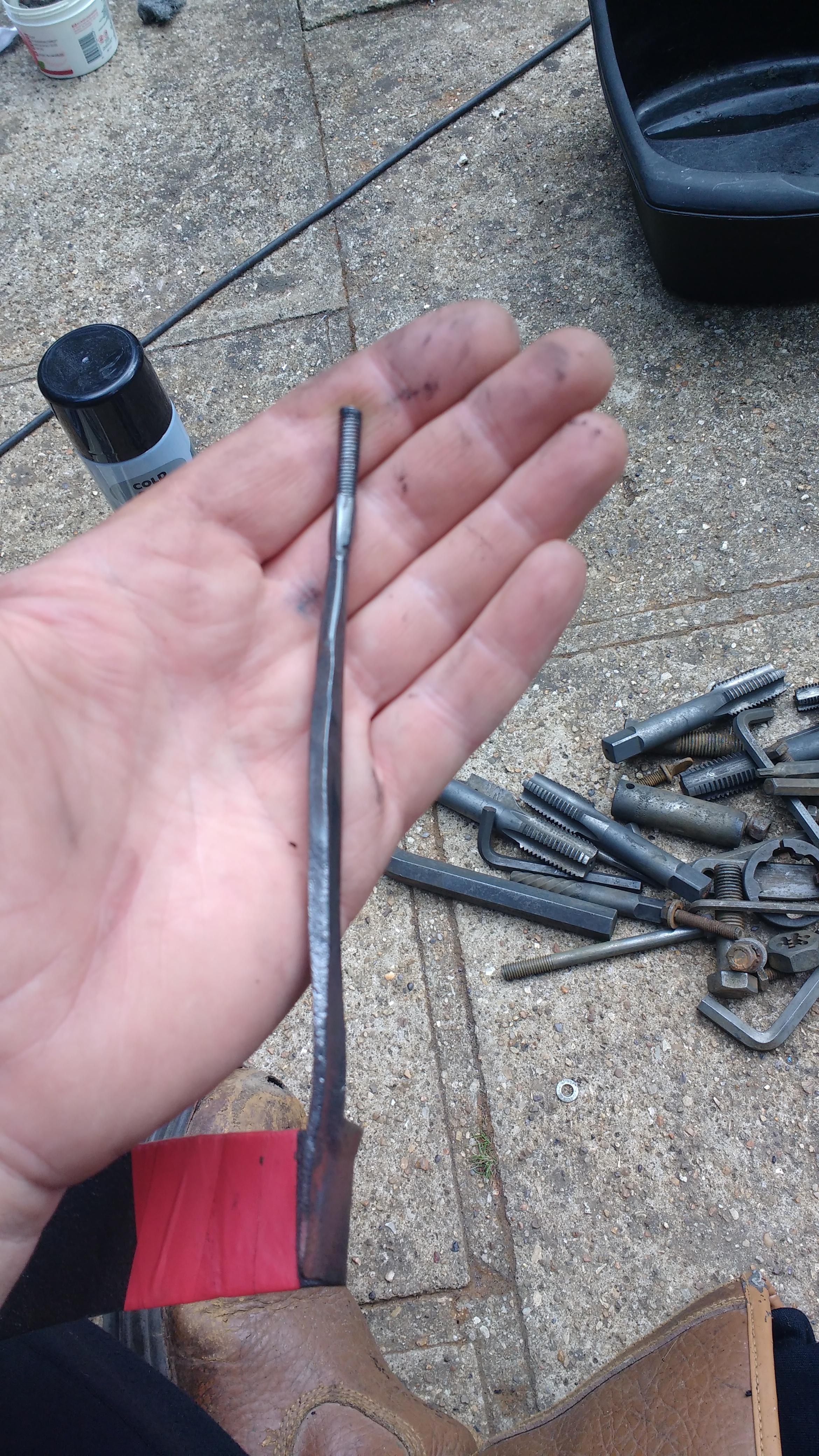

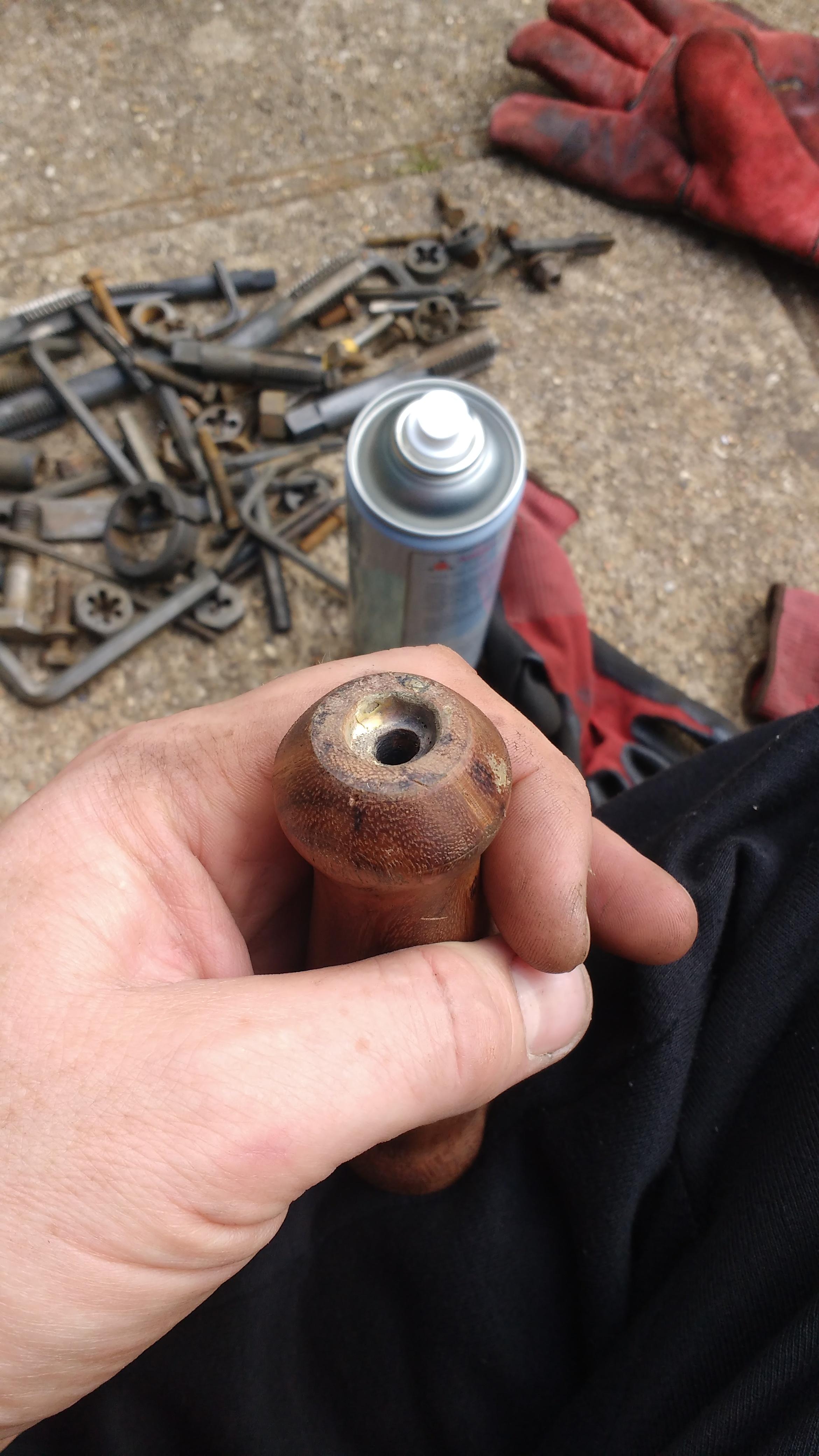

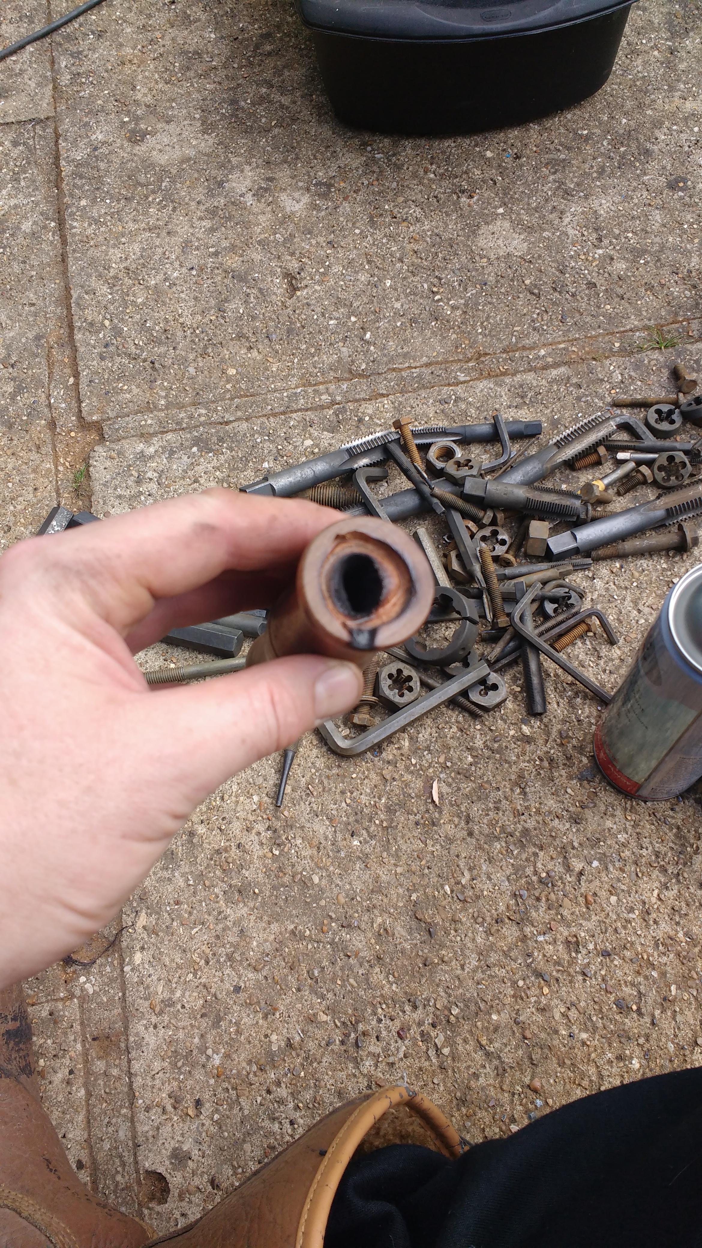

Onoff Posted August 15, 2021 Author Share Posted August 15, 2021 Bump. Link to comment Share on other sites More sharing options...
