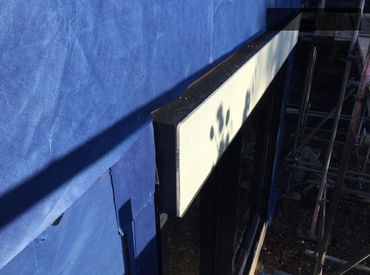

13 minutes ago, Bitpipe said:
We have Roma blinds and are very happy with them. They came fitted to our Gaulhoffer windows which we sourced from @craig not sure how they sell directly to UK market.
Very interesting.
Do you have a block cavity build?  If so then did the head unit (140mm > 100mm block) fit flush to the external leaf and the window move into the cavity?
Link to comment
Share on other sites
Just now, Mr Blobby said:
Very interesting.
Timber frame, we specified a void where the blind box sits above the window to achieve a flush effect.

4 minutes ago, Mr Blobby said:
the blind box can be fastened to adjacent timber.
Blind box generally isn't attached to anything other than the guide rails, the guide rails being attached to the window frame & shouldn't really need to be attached to anything else.
Link to comment
Thank you @craig
So is it possible to transpose the above diagram to a (200mm) block cavity?
If so then the blind box would be inside the cavity supported by the window and the window inside and fastened to the inner leaf (140mm) blockwork?
Link to comment
Yeah, basically put the above would be showing the blind on the outer skin behind the external finish.
Different boxes existing where you can render over the front face of the box.
Edited by craig
  • Like 2
Link to comment
Yes, this is how we will integrate the blind box, into the outer block leaf with the render-able face.  We are looking to increase the  outer leaf to 140mm form 100mm to be same width as blind box.
