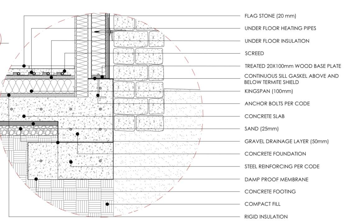

ashthekid Posted May 1, 2021 Share Posted May 1, 2021 I am just wondering what the best floor slab insulation is recommended for maximum heat insulation efficiency with UFH? Current plan is for 100mm Kingspan to go in, we cannot go anymore than 100mm, if anything I would prefer to go lower if possible but then I know we won’t have the most efficient insulation for retaining heat. Link to comment Share on other sites More sharing options...
PeterW Posted May 1, 2021 Share Posted May 1, 2021 Why are there 3 layers of insulation ..?? 120mm PIR would be better - what’s the screed thickness ..?? Looks like there is the space to get 120mm in there and will work fine. Link to comment Share on other sites More sharing options...
ashthekid Posted May 1, 2021 Author Share Posted May 1, 2021 Good question. I should have said that the only change to the layer detail is that only one layer of 100mm insulation is going on top of the concrete slab itself, then UFH, the screed which I believe is approx 25mm, then finished floor tile. No other insulation. Link to comment Share on other sites More sharing options...
Russell griffiths Posted May 2, 2021 Share Posted May 2, 2021 Are you in this country ? or have you used an online architect service? there is some weird stuff going on in your drawings, termite barriers WTF. Link to comment Share on other sites More sharing options...
Thorfun Posted May 2, 2021 Share Posted May 2, 2021 14 hours ago, ashthekid said: the screed which I believe is approx 25mm are you sure? I thought about 50mm was the minimum for a liquid screed and 75mm for sand and cement Link to comment Share on other sites More sharing options...
ashthekid Posted May 2, 2021 Author Share Posted May 2, 2021 Yes in this country ? @Russell griffiths So going back to the question of the 100mm insulation, what do you recommend as the best heat retention option? Or does all PIR have the same level of retention? Just trying my best to be efficient and make the UFH do its job properly. Link to comment Share on other sites More sharing options...
A_L Posted May 2, 2021 Share Posted May 2, 2021 15 minutes ago, ashthekid said: Or does all PIR have the same level of retention? Yes PIR is consistent, thermal conductivity 0.022W/m.K (maybe 0.023W/m.K) Link to comment Share on other sites More sharing options...
Russell griffiths Posted May 2, 2021 Share Posted May 2, 2021 So why the termite barrier??? Link to comment Share on other sites More sharing options...
wozza Posted May 2, 2021 Share Posted May 2, 2021 28 minutes ago, Russell griffiths said: So why the termite barrier??? And why "to code" on the bolts and steel reinforcing ? And is that an external wall without a foundation? Link to comment Share on other sites More sharing options...
ashthekid Posted May 2, 2021 Author Share Posted May 2, 2021 Thank you @A_L That is what I wanted to know. No termite barrier - European architect feature which is not happening. The external wall foundation detail is not needed as it is a wall that already exists. We are only building the new internal wall and slab. Link to comment Share on other sites More sharing options...
dpmiller Posted May 3, 2021 Share Posted May 3, 2021 so what drawings are provided to the BCO? Link to comment Share on other sites More sharing options...
ashthekid Posted May 3, 2021 Author Share Posted May 3, 2021 A slightly different one that has been all signed off by BCO. ?? I just wanted to know about my 100mm insulation options.❓ Link to comment Share on other sites More sharing options...
Olf Posted May 3, 2021 Share Posted May 3, 2021 You can also use phenolic boards (also with Kingspan in the name): 0.022W/mK , so you get 20% better insulation than PIR. But at >100% price premium (currently they're £90-£100 for 1.2m x 2.4m piece) Link to comment Share on other sites More sharing options...
