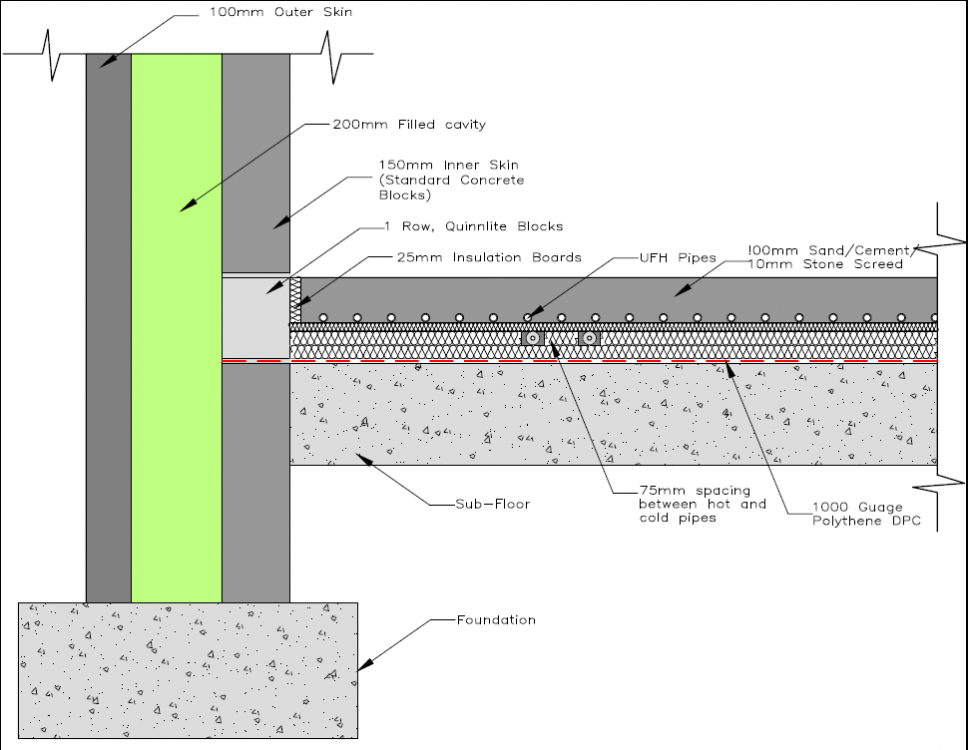

JamieM Posted March 1, 2017 Share Posted March 1, 2017 12 minutes ago, DeeJunFan said: We have 150mm concrete sub-floor, quinn lite blocks at the slab level and then we are currently debating to go either 200mm PIR with Sand/Cement screed or 250mm PIR and 50mm CemFloor screed. I'm the same except trying to decide whether to use 125mm PIR and 100m sand cement or 150mm PIR and 75mm s/c Link to comment Share on other sites More sharing options...
Declan52 Posted March 1, 2017 Share Posted March 1, 2017 150mm insulation. 1 Link to comment Share on other sites More sharing options...
joe90 Posted March 1, 2017 Share Posted March 1, 2017 I am having 200 mm PIR and 65mm sand and cement with UFH pipes. Link to comment Share on other sites More sharing options...
JohnW Posted March 1, 2017 Author Share Posted March 1, 2017 1 hour ago, DeeJunFan said: In NI this is the "Way" it would be very difficult to find a builder locally who would even consider doing anything differently. This is the same build up as i have used. We have 150mm concrete sub-floor, quinn lite blocks at the slab level and then we are currently debating to go either 200mm PIR with Sand/Cement screed or 250mm PIR and 50mm CemFloor screed. What U-values are you hoping to achieve with your 2 options @DeeJunFan? Link to comment Share on other sites More sharing options...
JohnW Posted March 1, 2017 Author Share Posted March 1, 2017 1 hour ago, Declan52 said: I wouldn't want my finished floor put in at the founds stage if I was going to be building blocks. The floor will be ruined!!! Plus all that weight on your floor with the ufh piped in it is taking a chance. Depending on how access is you might have to stack blocks up 5 straps high which is 5t sitting on 1m2 which is a lot. @Declan52 that's a fair point. Link to comment Share on other sites More sharing options...
JohnW Posted March 1, 2017 Author Share Posted March 1, 2017 1 hour ago, JamieM said: I'm the same except trying to decide whether to use 125mm PIR and 100m sand cement or 150mm PIR and 75mm s/c What U-values are you hoping to achieve with your 2 options @JamieM? Link to comment Share on other sites More sharing options...
JohnW Posted March 1, 2017 Author Share Posted March 1, 2017 45 minutes ago, joe90 said: I am having 200 mm PIR and 65mm sand and cement with UFH pipes. What U-value are you hoping to achieve with this @joe90? Link to comment Share on other sites More sharing options...
JamieM Posted March 1, 2017 Share Posted March 1, 2017 very roughly the u value for the PIR would be about 0.176(125mm) and 0.1467(150mm) and if you include the screed/sand/cement would be 0.168(125mm) and 0.143(150mm) Link to comment Share on other sites More sharing options...
JamieM Posted March 1, 2017 Share Posted March 1, 2017 (edited) thickness (mm) W/m K m2 K/W u value PIR 125 0.022 5.681818 0.176 screed 100 0.41 0.243902 5.925721 0.168756 PIR 150 0.022 6.818182 0.146667 screed 75 0.41 0.182927 7.001109 0.142835 Edited March 1, 2017 by JamieM 1 Link to comment Share on other sites More sharing options...

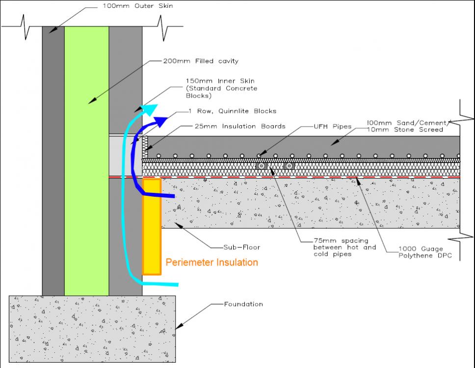

PeterW Posted March 1, 2017 Share Posted March 1, 2017 The P/A value also affects the overall floor uValue as I found out. As we have a retrofit and new build element then we end up with a whole raft of different calcs but due to P/A of some we end up with a lower uValue for the same thickness of insulation in a couple of places. Link to comment Share on other sites More sharing options...
Declan52 Posted March 1, 2017 Share Posted March 1, 2017 You need to work out the perimeter of your build and divide this by the floor area. Go to this site with whatever your figure you got from working out the sum above and put it into the calculator. http://www.kingspaninsulation.co.uk/Services/U-Value-Calculator.aspx Link to comment Share on other sites More sharing options...
Jeremy Harris Posted March 1, 2017 Share Posted March 1, 2017 (edited) Bear in mind that for a new build Part L ( https://www.gov.uk/government/uploads/system/uploads/attachment_data/file/540326/BR_PDF_AD__L1A__2013_with_2016_amendments.pdf ) has tightened up on things like thermal bridging and heat losses from UFH, so what may have been acceptable under the last edition may not under the current regs. The changes are mainly intended to stop the horse trading big developers were doing, by fitting a handful of solar panels on the roof and then cutting back on insulation, as the PV improved the TER enough to get a pass despite the house being pretty poor in terms of insulation. There are also notional model design guideline values for fabric U values that are suggested as a way to get a low enough TER/TFEE, and the floor U value in that table is now 0.13 W/m².K, not the limiting fabric value of 0.25 W/m²/K. UFH must also not lose more than 10W/m² into the ground, maximum. This isn't a tough target to meet if you have a low overall heating requirement, but would be tough to meet if you build to the limiting fabric U values, I think. Edited to add: This is the compliance guide for new build domestic building services, including UFH: https://www.gov.uk/government/uploads/system/uploads/attachment_data/file/453968/domestic_building_services_compliance_guide.pdf Edited March 1, 2017 by JSHarris Added the compliance guide link Link to comment Share on other sites More sharing options...
JohnW Posted March 1, 2017 Author Share Posted March 1, 2017 I suspect this thread could roll on for weeks as there appears to be many ways to skin this particular cat. I think, I now have enough information to make a well informed decision, which will definitely involve increasing the insulation in the floor, reducing cold bridging and attempting to achieve a floor U-value as close to 0.1 as the budget will allow. So, thanks again to everyone who contributed to this thread. I really appreciate the combined expertise and the unselfish time & effort you have all spent. 1 Link to comment Share on other sites More sharing options...

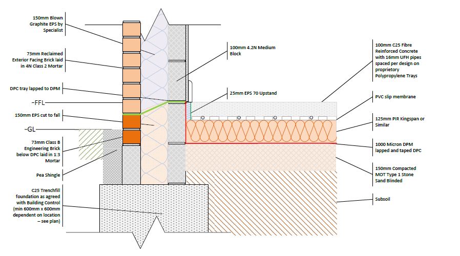

Laith J Posted January 30, 2020 Share Posted January 30, 2020 Sorry to hijack an old thread... Some very useful information to be fair.. Im currently helping my father out with is extension and we have 190 mm to build up to finished floor, fow which he has already bought 100mm PIR and is going to run 16mm UFH pipe. He currently is planning on a 90mm s/c screed to take him up to FF but personally I think he should put more PIR and reduce the screed amount.. what would be the best option in this scenario? Link to comment Share on other sites More sharing options...
JamesP Posted January 30, 2020 Share Posted January 30, 2020 (edited) 1 hour ago, Laith J said: Sorry to hijack an old thread... Some very useful information to be fair.. Im currently helping my father out with is extension and we have 190 mm to build up to finished floor, fow which he has already bought 100mm PIR and is going to run 16mm UFH pipe. He currently is planning on a 90mm s/c screed to take him up to FF but personally I think he should put more PIR and reduce the screed amount.. what would be the best option in this scenario? I would increase the PIR by up to 50mm. Do double check your levels and thresholds. My floor build up was 150mm celotex on top of the slab, 16mm ufh and 40mm screed. Check with the screeders minimum screed recommendation. Edited January 30, 2020 by JamesP spellin Link to comment Share on other sites More sharing options...
Temp Posted January 30, 2020 Share Posted January 30, 2020 Google says 20 and 30mm PIR is available so you could add a layer of that to the 100mm PIR he already has. Think I'd put it under the 100mm. 1 Link to comment Share on other sites More sharing options...
