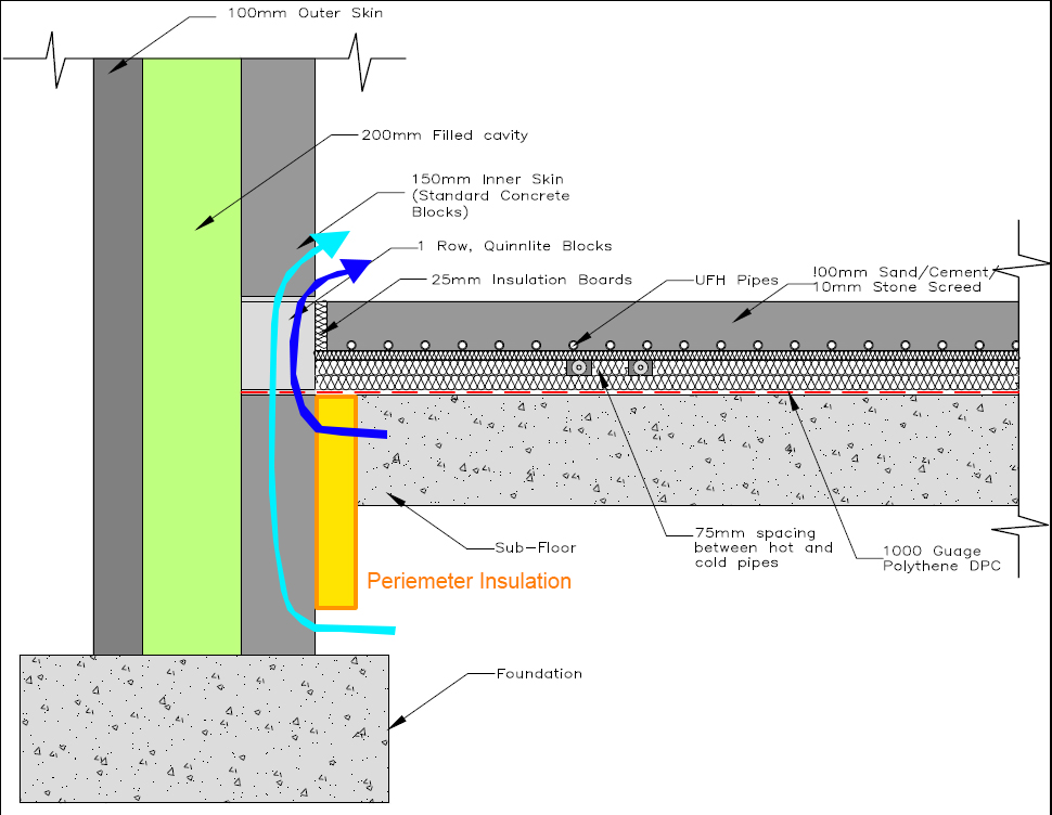

JohnW Posted February 28, 2017 Author Share Posted February 28, 2017 (edited) Thanks @PeterW, it's not dissimilar to what we have been advised to use. (See below - I should also point out that this image and all technical & design information contained within are the copyright of Reinco Insulation & Renewables consultant, Eric Davidson) Edited February 28, 2017 by JohnW Added copyright information for the image Link to comment Share on other sites More sharing options...
Jeremy Harris Posted February 28, 2017 Share Posted February 28, 2017 (edited) @JohnW, your build up looks better, as you're partially mitigating the thermal bridge at the internal wall/floor junction with the Quinnlite blocks, but I'd question the need for the separate, cold, sub-floor. I think you could useful change this detail to the one in the Kore link I gave earlier, leaving your foundation and wall detail as-is. If you have room, then I'd suggest laying the insulation either direct on to a blinded, packed type1 sub-base (cheap!) , or with the blinding covered with the DPM, then the insulation, and making the finished floor the structural layer, with the UFH pipes closer to the top than the bottom, to further reduce losses. If I get time later I'll try and do a sketch to show exactly what I mean, but I'm pleased to see that some effort has been taken to reduce thermal bridging in the internal wall - this is a detail that is often overlooked, it seems. Edited February 28, 2017 by JSHarris typo 1 Link to comment Share on other sites More sharing options...
joe90 Posted February 28, 2017 Share Posted February 28, 2017 32 minutes ago, JSHarris said: @JohnW, your build up looks better, as you're partially mitigating the thermal bridge at the internal wall/floor junction with the Quinnlite blocks, but I'd question the need for the separate, cold, sub-floor. I think you could useful change this detail to the one in the Kore link I gave earlier, leaving your foundation and wall detail as-is. If you have room, then I'd suggest laying the insulation either direct on to a blinded, packed type1 sub-base (cheap!) , or with the blinding covered with the DPM, then the insulation, and making the finished floor the structural layer, with the UFH pipes closer to the top than the bottom, to further reduce losses. If I get time later I'll try and do a sketch to show exactly what I mean, but I'm pleased to see that some effort has been taken to reduce thermal bridging in the internal wall - this is a detail that is often overlooked, it seems. That makes it similar to the golcar passive house I linked to earlier. Link to comment Share on other sites More sharing options...
JohnW Posted February 28, 2017 Author Share Posted February 28, 2017 2 hours ago, joe90 said: That makes it similar to the golcar passive house I linked to earlier. Thanks @joe90, @JSHarris it's good to hear we appear to be planning correctly...just have to build it correctly now Link to comment Share on other sites More sharing options...

JohnW Posted February 28, 2017 Author Share Posted February 28, 2017 3 hours ago, JSHarris said: @JohnW, your build up looks better, as you're partially mitigating the thermal bridge at the internal wall/floor junction with the Quinnlite blocks, but I'd question the need for the separate, cold, sub-floor. I think you could useful change this detail to the one in the Kore link I gave earlier, leaving your foundation and wall detail as-is. If you have room, then I'd suggest laying the insulation either direct on to a blinded, packed type1 sub-base (cheap!) , or with the blinding covered with the DPM, then the insulation, and making the finished floor the structural layer, with the UFH pipes closer to the top than the bottom, to further reduce losses. If I get time later I'll try and do a sketch to show exactly what I mean, but I'm pleased to see that some effort has been taken to reduce thermal bridging in the internal wall - this is a detail that is often overlooked, it seems. In the scenario you paint above with the UFH pipes close to the top of the structural layer, would the structural layer not be deeper than 100mm and therefore a large percentage of the heat from the UFH pipes would transfer downwards and never make it to the surface where we need it? Link to comment Share on other sites More sharing options...
Jeremy Harris Posted March 1, 2017 Share Posted March 1, 2017 (edited) 9 hours ago, JohnW said: In the scenario you paint above with the UFH pipes close to the top of the structural layer, would the structural layer not be deeper than 100mm and therefore a large percentage of the heat from the UFH pipes would transfer downwards and never make it to the surface where we need it? It's the way our slab's laid, and works well. We have a layer of reinforcing steel fabric on 50mm chairs, so at the mid-point in the 100mm thick slab. The UFH pipes are on top of this, so are closer to the top than the bottom (the top of the pipes is around 34mm from the surface of the slab), which improves the response time slightly and also reduces the losses slightly. The thermal conductivity of concrete is pretty close to that of water, so pretty high, and the heat capacity of concrete is a lot less than water, so in practice heat travels from the water in the pipes to the surface of the slab quite quickly. There will still be a temperature gradient both ways when the systems running, with the centre of the pipe being the highest temperature and the temperature dropping the further away from that you go in the slab. If the pipes were at the bottom, then the losses would increase slightly, as the hottest part would be further away from where you want the heat delivered, and closer to the place you don't want the heat to go, the ground underneath. No insulation is perfect, there will always be heat lost through it whenever there is a temperature difference from one side to the other, and the key thing here is that the higher the pipes are in the slab the lower the temperature of the slab will be at the bottom, which is a good thing overall. Edited March 1, 2017 by JSHarris 1 Link to comment Share on other sites More sharing options...
