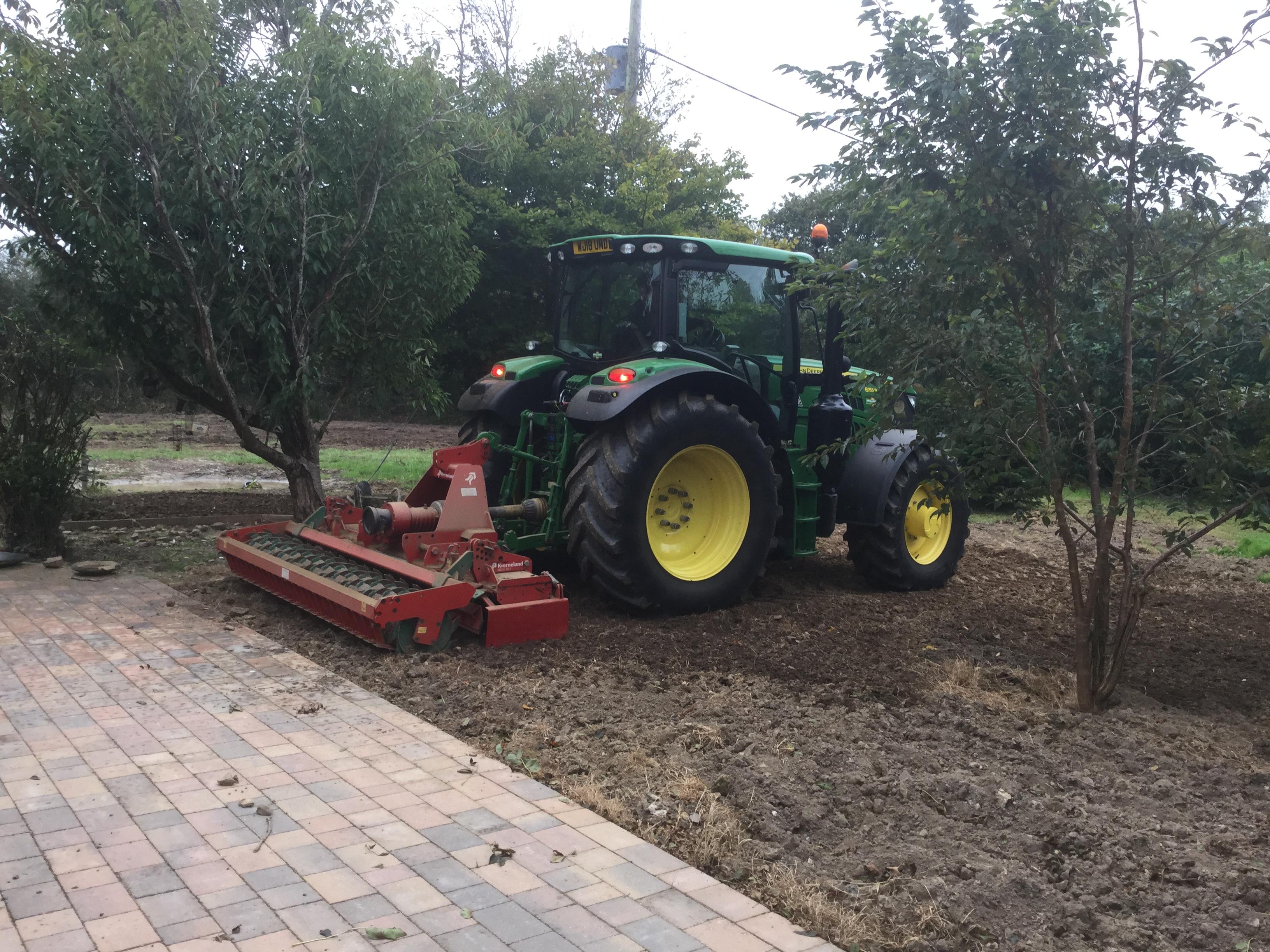

Weebles Posted April 27, 2021 Share Posted April 27, 2021 We have got to the grass stage and the area to be grassed / flower beds is rock solid from having diggers track over it so much. It doesn’t drain very well at all. I’ll definitely get in some topsoil but what would should we do with this rock solid stuff first before we put topsoil on top? No weeds. It’s like concrete. Link to comment Share on other sites More sharing options...
Stones Posted April 27, 2021 Share Posted April 27, 2021 Hire a rotovator for the weekend, break it up. Roughly level and finish with topsoil. Link to comment Share on other sites More sharing options...
saveasteading Posted April 27, 2021 Share Posted April 27, 2021 If inclined, break it up with a fork, perhaps wetting first for ease. To the topsoil add plenty of manure or compost, and worms will do it for you, over a couple of years. Henley-on Thames I see. Lots of horses around there? Link to comment Share on other sites More sharing options...
joe90 Posted April 27, 2021 Share Posted April 27, 2021 I got a power Harrow to break mine up..... Link to comment Share on other sites More sharing options...
Vijay Posted April 27, 2021 Share Posted April 27, 2021 2 hours ago, joe90 said: I got a power Harrow to break mine up..... Now you're just showing off lol 1 Link to comment Share on other sites More sharing options...
joe90 Posted April 27, 2021 Share Posted April 27, 2021 23 minutes ago, Vijay said: Now you're just showing off lol Only cost me £60 to do 1/2 an acre in 30minutes. Beats the hell out of working hard ? Link to comment Share on other sites More sharing options...

Weebles Posted April 28, 2021 Author Share Posted April 28, 2021 All great advice thank you. Yes plenty of manure round here though not cheap sadly. might plump for seed in the end but clearly got done prep to do either way. Seen this in Aldi https://www.aldi.co.uk/electric-tiller/p/805141459647600?gclid=EAIaIQobChMIx6m2vvCe8AIVi_93Ch09OQ4tEAQYASABEgKVaPD_BwE&gclsrc=aw.ds#product-reviews reckon it will get through the solid layer? Link to comment Share on other sites More sharing options...
Temp Posted April 28, 2021 Share Posted April 28, 2021 I inherited a similar size petrol rotavator. Useless, it just skips about on a hard surface. I'd rent something bigger. If you still have an excavator on site use that to dig up the top layer. 1 Link to comment Share on other sites More sharing options...
joe90 Posted April 28, 2021 Share Posted April 28, 2021 I have a jcb with toothed 600mm bucket which I raked the ground with, on really hard ground I reversed with the front bucket, teeth down and front wheels in the air. No rotovator would have touched it. 1 Link to comment Share on other sites More sharing options...
Weebles Posted April 28, 2021 Author Share Posted April 28, 2021 1 hour ago, joe90 said: I have a jcb with toothed 600mm bucket which I raked the ground with, on really hard ground I reversed with the front bucket, teeth down and front wheels in the air. No rotovator would have touched it. Sadly no digger on site. But today’s rain might soften it so we can dig a small pit to see how deep the problem is. 1 Link to comment Share on other sites More sharing options...
