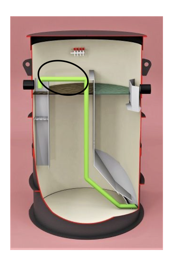

Inclined to agree with your comment. I enclose a picture of where I removed the waste pipes and then shoved a pressure hose down the vertical to clear the SSR.
Wish I had paid a bit more attention to the design of the internals before filling.
If and when emptied I will throughly clean out and take note of internal parts.

My Vortex is slightly different to the diagram above and the one on their website, my tubes go into the air action chamber not the sampling chamber. I understand the air pump produces bubbles but don’t understand how an air compressor can pump fluid from one chamber to another, it’s not explained on the website, anyone know? I wish I had taken photos of the insides before it got filled.

I don’t think that is the case with the Vortex, the pipe runs in the above diagram run above the water level so some “pumping” must be done!
edit, just found this on the official website.   Air from the blower spurs from the regulator to two sludge return pipes,
Is it the same way that cheap fish tank filters work?
The air lowers the density of the surrounding fluid and it then rises.
10 minutes ago, dpmiller said:
yep, a big air-lift.

using small bore tubes to move "settled" sludge looks like a not-so-tasty recipe for disaster.
These are 50mm pipes. But I have found the problem
a large dead rat
Came floating to the surface, not a good way to go. I will now fit a grill to the outlet pipe as that’s the only way it could have got in.

Yes - I’m starting to have this problem. The floating sludge is so thick that the floating sludge return barely touches it. Did you find a solution?
Well it cleared itself, no idea why, working fine now and very little floating sludge.
Increase the frequency or length of the floating sludge return maybe
assuming of course the pipe work protrudes above the water line.
What heppens when the sludge return is running? Can you see the crud going down the pipe?
Pipework and levels are perfect and everything is working as it should (in theory).
I increased the rate from 5 minutes per hour to 5 minutes per 45 minutes. The problem is that if the layer is too thick - and we are talking perhaps 15-20mm - then its resistance to move across the surface towards the pipe is so much greater than clear water that flows from beneath the layer. So, if you get a stick and direct the layer towards the pipe then sure enough it gets sucked away, but left under its own devices it is hardly affected.
I don’t understand why the layer has formed. Clearly the floc is too buoyant and floating (I think it is called ‘bulking’), but trying to understand the causes behind this from internet search is hard. Anything I find relates to industrial scale plant, not domestic plant, though the theory is nominally the same. It seems the world of domestic activated sludge plant is a bit of a black art.
The 6 person tank in a house of 4 people has only been installed 7months, so it shouldn’t need emptying yet. I do periodic settlement tests and the 30minute %settled is 80%, and the spec says to de-sludge if this goes above 90%. I have tried increasing aeration so will give it a bit more time to see if that changes the equilibrium. @joe90said his just cleared up of its own accord.
