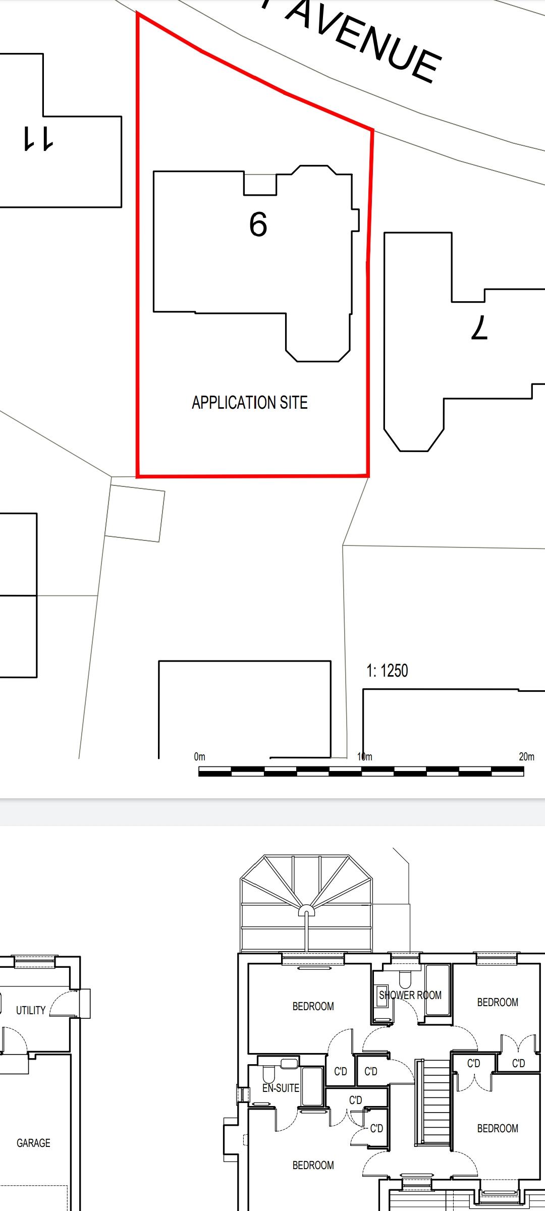

Haylingbilly Posted April 20, 2021 Posted April 20, 2021 So, due to issues with access, I am going to have to do my foundations spoil removal by hand and have 330 cubic meters of top soil and sand to remove. Firstly I think it will bulk up and be roughly 30 grab lorries - does that seem right? I would love to use a dumper or tracked barrows to move it - I might get away with tracked barrows but won't with a dumper. My experience of tracked barrows is on the level they aren't any quicker and for me there is limited space to turn around at the tipping point so I think would be very slow turning around so no faster than by hand. So I I had 5 men with a high capacity wheel barrow each and one man in an excavator loading their barrows for them - each man has to wheel their barrow a level 40m and then tip it before returning. Is it realistic that each man can do the equivalent of a grab a day? And in which case this is a 6x5 man day for barrowing and 6 days of an excavator driver job? I have looked into the cost of a conveyor belt and even a railway but both are double the price of doing it by hand unless I have my estimates of the time out by a lot!. Really appreciate the build hubbers wisdom on this....

Haylingbilly Posted April 20, 2021 Author Posted April 20, 2021 Thanks for the feedback - to answer some of the questions The access issues are that there is a pinch point which is very narrow that we have to take everything past - to one side is a 2m high retaining wall that is not sound (we are above it) and hence we couldn't get a tipper through. To remediate that wall we are looking at £5-10k and even then there is a victorian water storage tank that we have to go over which may or may not take the weight. For me these is just too much risk of using any heavy machinery. I wish I could raise the rest of the site a foot - ironically I have 1/2 an acre, but most of it has a blanket TPO so tree officer won't let me dump any soil there. I'll be trying to lose as much as I can but. 330cum is realistic in what we need to remove Moonshine and Declan52 - I don't think we are a million miles off our estimates (admittedly I am doing the classic client thing of underestimating!). The earth is very very free draining, is golden sand - you can't really grow anything on it so I think it will be lighter that you estimate - at say 20% lighter - that would put your estimate at touching 50 days. I think the cost neutral point of getting a conveyor in if all goes as plans is the same as 65 days of heavy lifting, but with inevitable delays (breakdowns blockages, and such like) it could easily work out at 80 plus days. If the consensus was at the level of 80 days then I would look at conveyor more seriously, but am thinking the thing to do, is get a team in for half a day and see what we can manage and then reassess.
