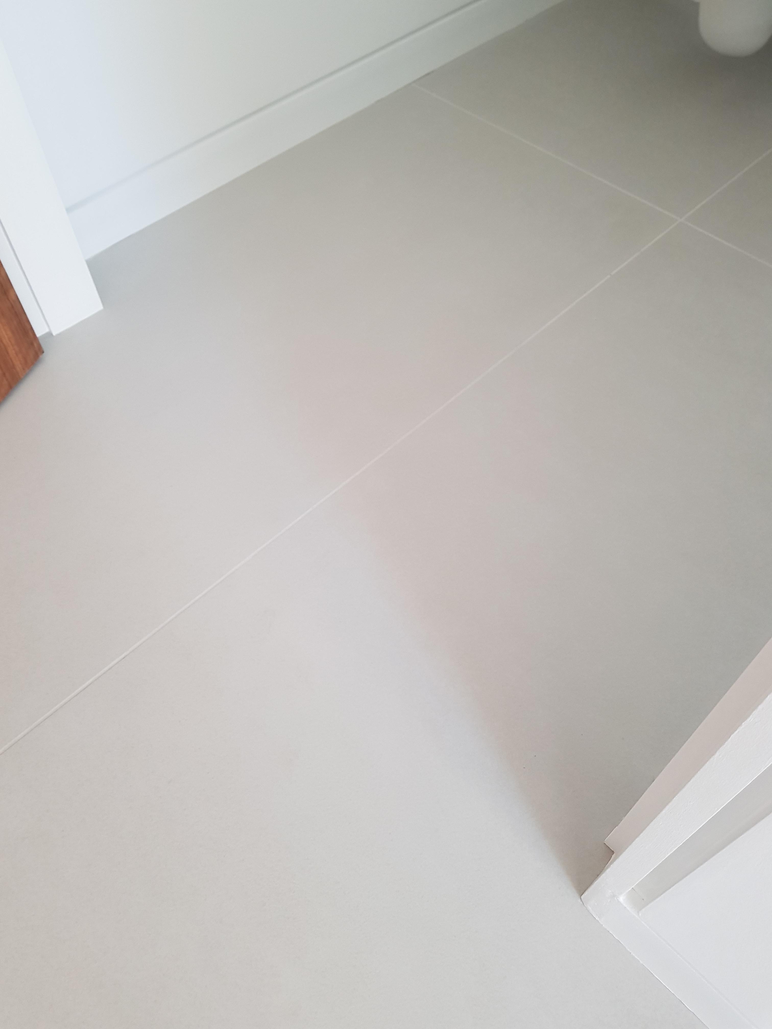

Pete Posted April 16, 2021 Posted April 16, 2021 (edited) On 16/04/2021 at 06:37, pocster said: Sure . But what if my tile grout line ( the expansion strip ) doesn’t line up in the doorway ? . Just ignore it ? . Or just put the expansion strip as near as possible to the doorway ? Expand I do not have expansion strips of any kind in my doorways. I have laid 1.2m x 1.2m tiles throughout my ground floor onto decoupling membrane on a concrete slab and have had no problems and imo looks better than putting thin strips in which would have spoilt the look of my large tiles Edited April 16, 2021 by Pete Add photo 1

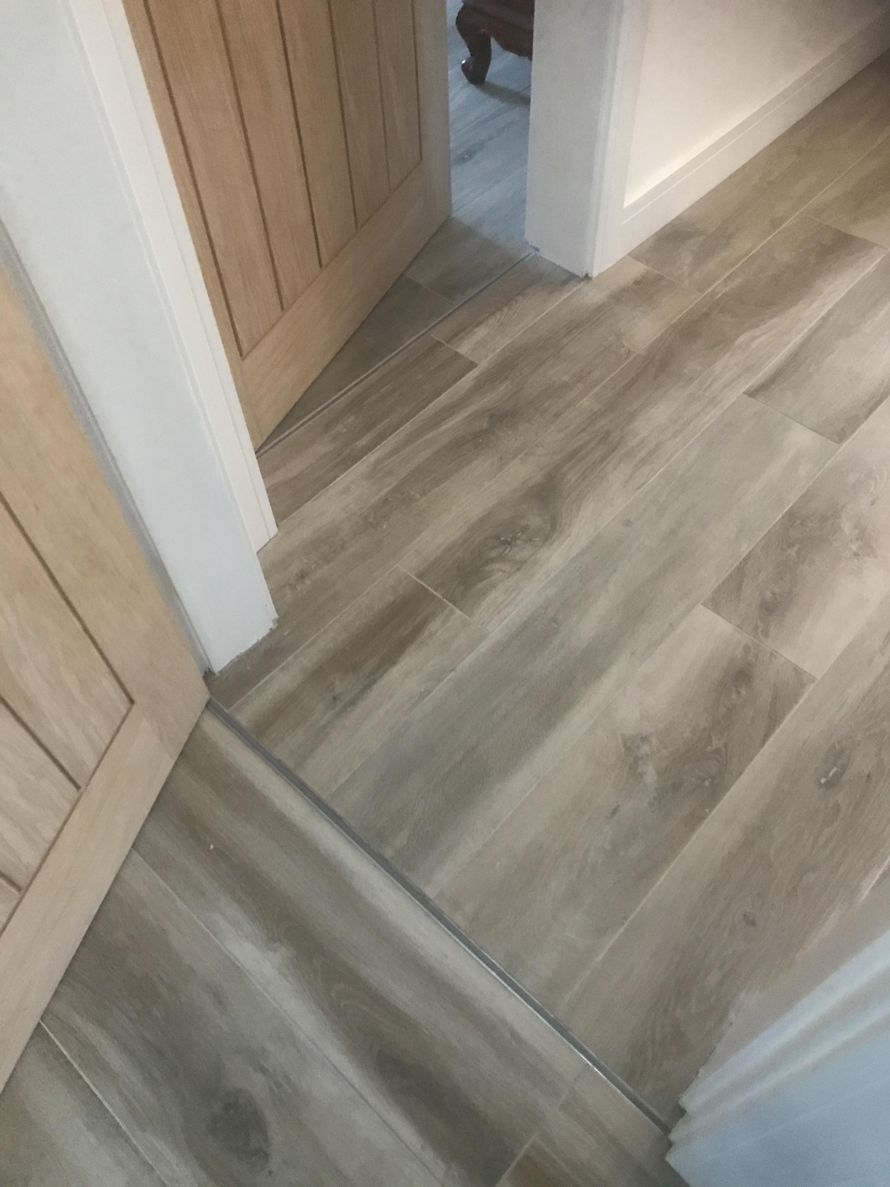

Pocster Posted April 16, 2021 Author Posted April 16, 2021 On 16/04/2021 at 07:18, Pete said: I do not have expansion strips of any kind in my doorways. I have laid 1.2m x 1.2m tiles throughout my ground floor onto decoupling membrane on a concrete slab and have had no problems and imo looks better than putting thin strips in which would have spoilt the look of my large tiles Expand I’m tempted to only put an expansion strip in a doorway only when there’s a change of tile flooring . So it’s a natural break and you won’t even notice it as the tiles have changed .
Pete Posted April 16, 2021 Posted April 16, 2021 On 16/04/2021 at 08:42, pocster said: I’m tempted to only put an expansion strip in a doorway only when there’s a change of tile flooring . So it’s a natural break and you won’t even notice it as the tiles have changed . Expand Would be ok but I did not even do that in the two bathrooms as I had used the mat throughout 1
