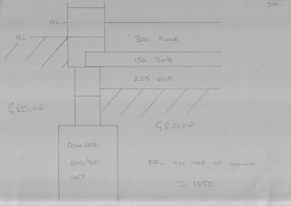

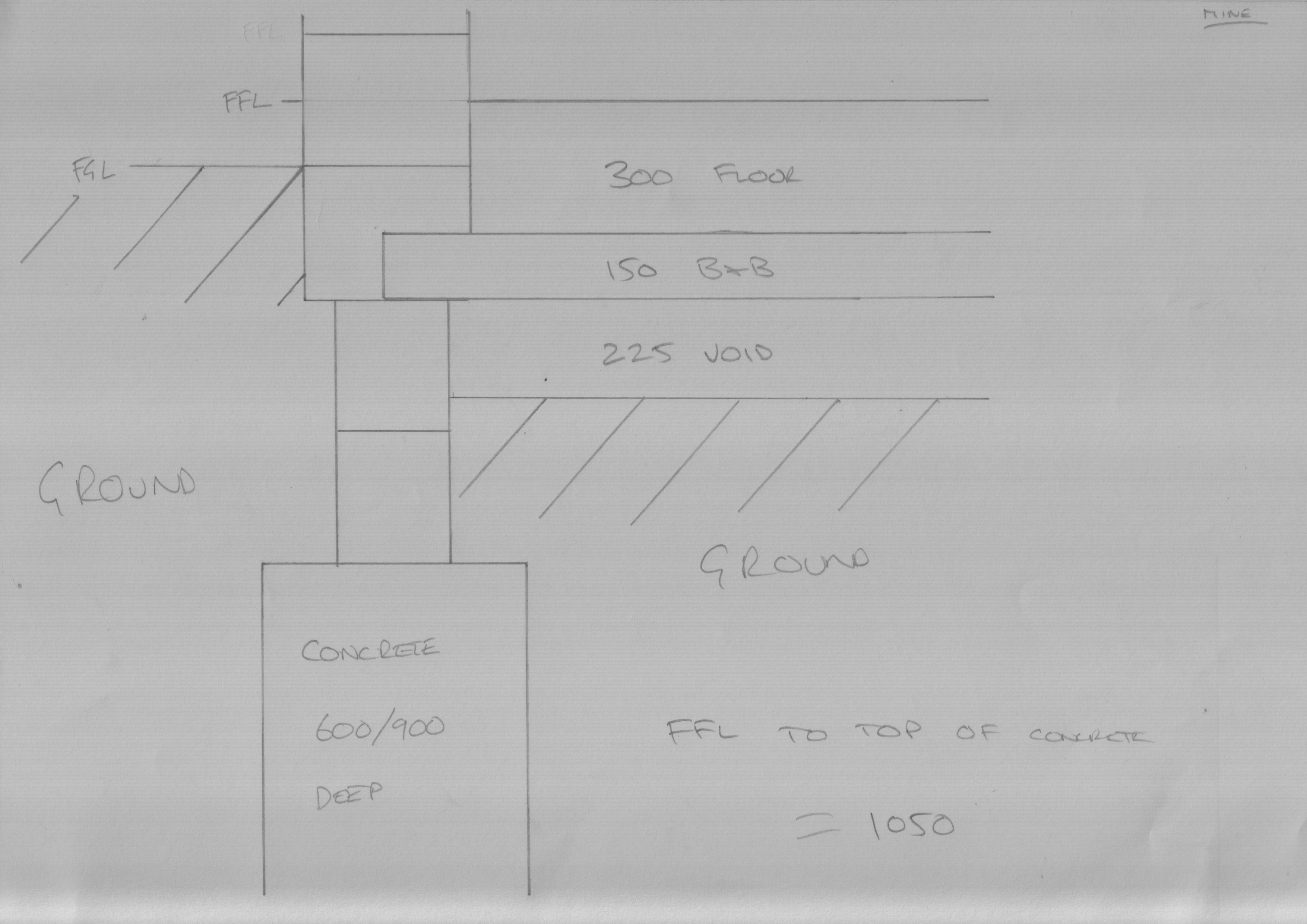

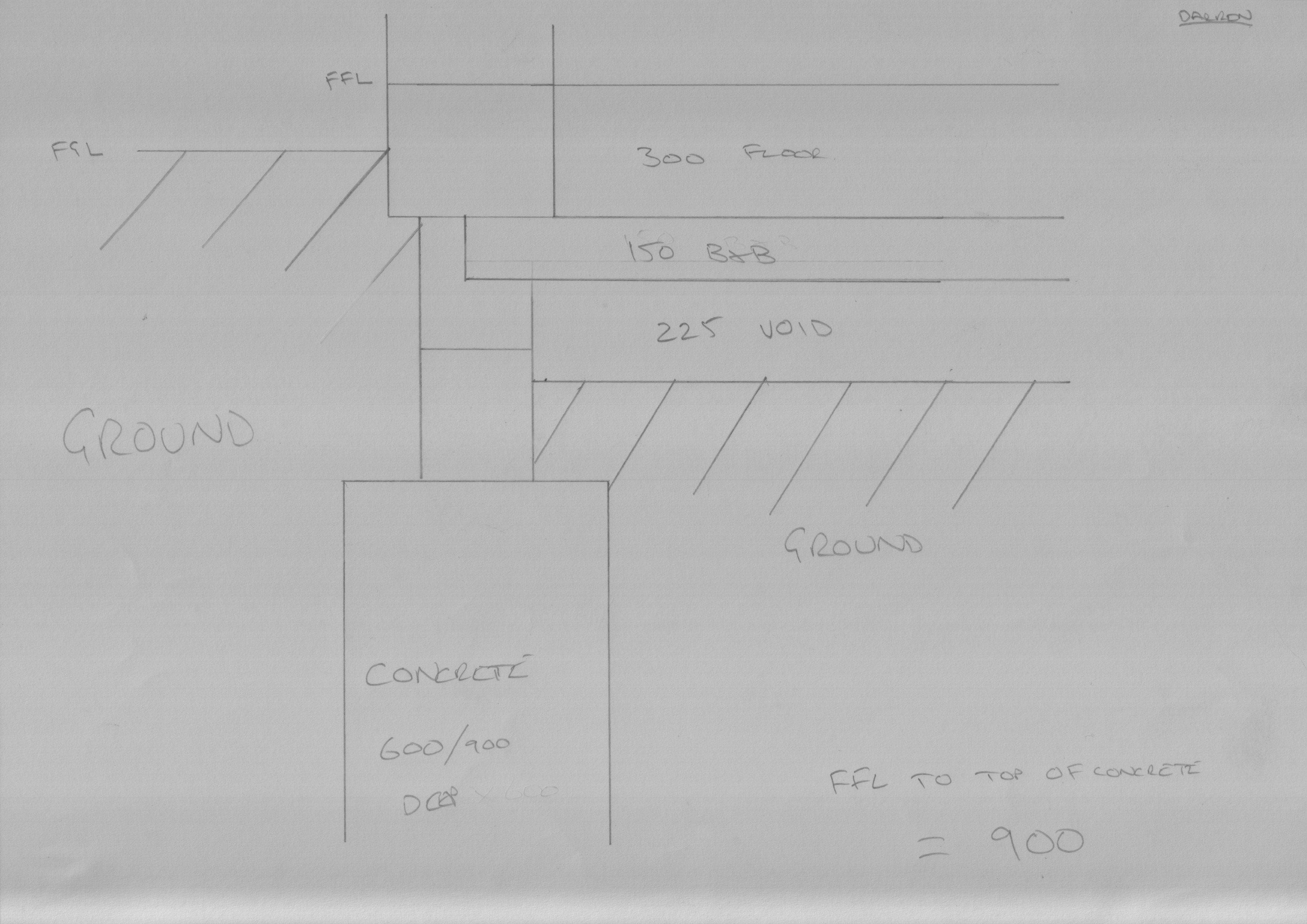

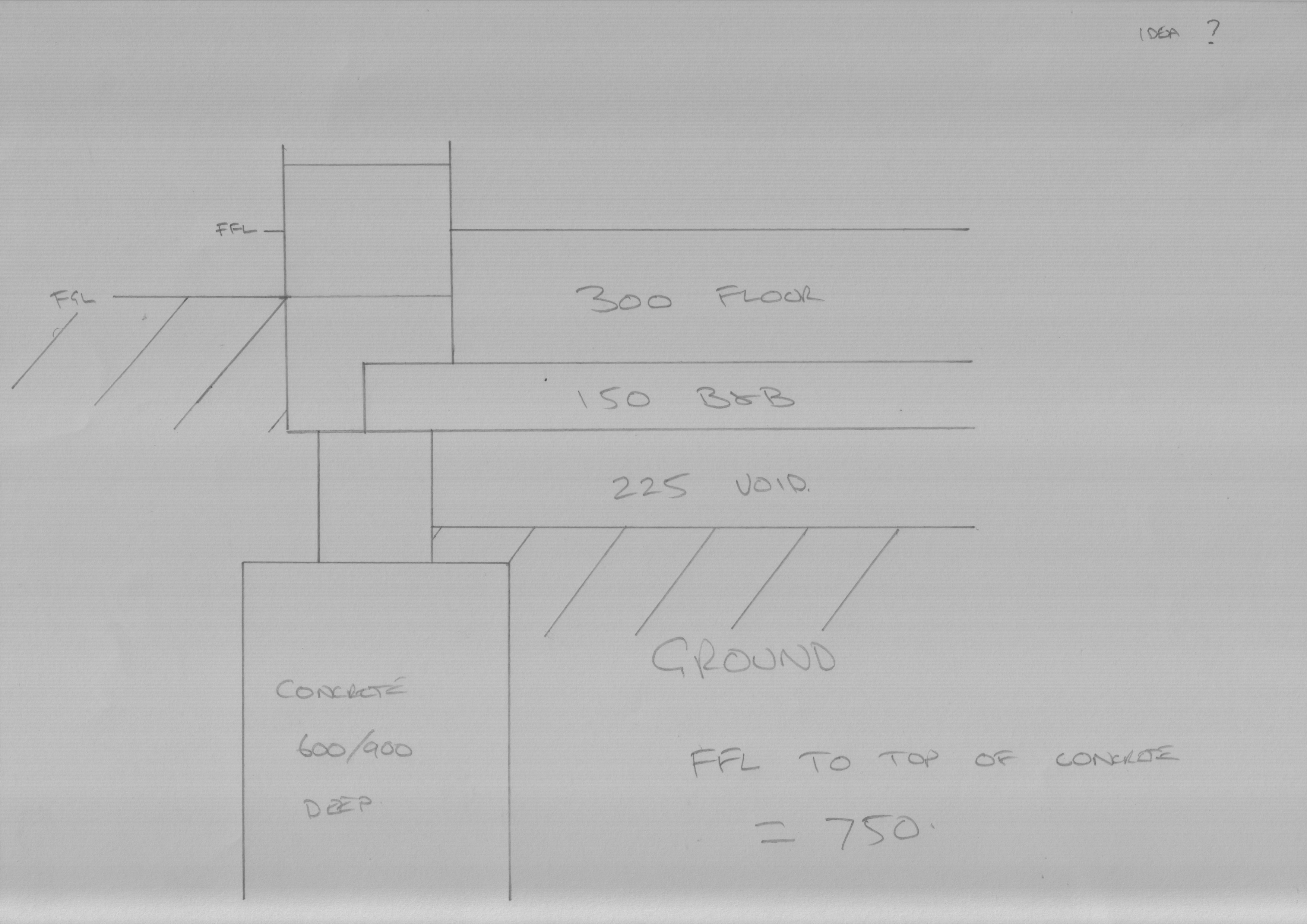

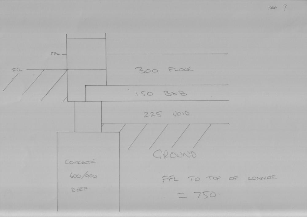

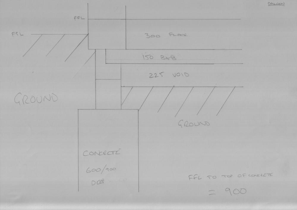

Vijay Posted February 23, 2017 Posted February 23, 2017 (edited) Got a slight snag with the foundation depth after clearing all the topsoil from the plot. My rising walls will be Polarwall ICF for the external walls and foundation blocks for the internal and sleeper walls. My external walls will also be in Polarwall ICF. I've done some quick drawings to show my issue. The structural engineer says the important thing that he is concerned about is the distance from the bottom of the mass concrete footing to finished ground level has to be 1200/1500 (depending on where abouts it is). I've wondered why I need so much rising wall out of my footings before I sit the beam and block floor. On the architects drawing, it shows 450mm which is 1.5 x Polarwall panels. This gives me 900 from FFL to top of concrete or 1350/1650 from FGL to bottom of concrete. For ease of installion, the floor beams really need to sit on top of a Polarwall Panel so I looked at doing this. The B&B now sits on top of 2 x Polarwall panels and give me 1050 from FFL to top of concrete or 1500/1800 from FGL to bottom of concrete. Now, this is what I think makes sense as it saves digging out, mucking away and loses a course of Polarwall ICF and now gives me 750 from FFL to top of concrete or 1200/1500 from FGL to bottom of concrete which is exactly what the SE specified. So can anyone think of any reason why this wouldn't work? Someone suggested frost but the rising wall is still 600 from FGL. I should also mention that I've assumed that FGL is exactly that, the FINISHED ground level once landscaping and everything else is done, as it will obviously be lower that the moment with topsoil removed. Cheers for any help and sorry for the long post Vijay Edited February 23, 2017 by Vijay
RichS Posted February 23, 2017 Posted February 23, 2017 Surely if what you are achieving with your last sketch is what the SE is asking for there is no problem. As long as the ground at that depth is solid enough to take it then why bother digging out another 300mm?
Mr Punter Posted February 23, 2017 Posted February 23, 2017 Why are you using the Polarwall below ground? Why not just us concrete blocks? I assume the void is vented, so you won't gain from insulation.
Vijay Posted February 23, 2017 Author Posted February 23, 2017 1 hour ago, RichS said: Surely if what you are achieving with your last sketch is what the SE is asking for there is no problem. As long as the ground at that depth is solid enough to take it then why bother digging out another 300mm? That's exactly what I thought but wondered if there would be a reason it was done like that. SE has replied saying as long as the measurements from FGL to bottom of concrete footing is 1200/1500 it is fine

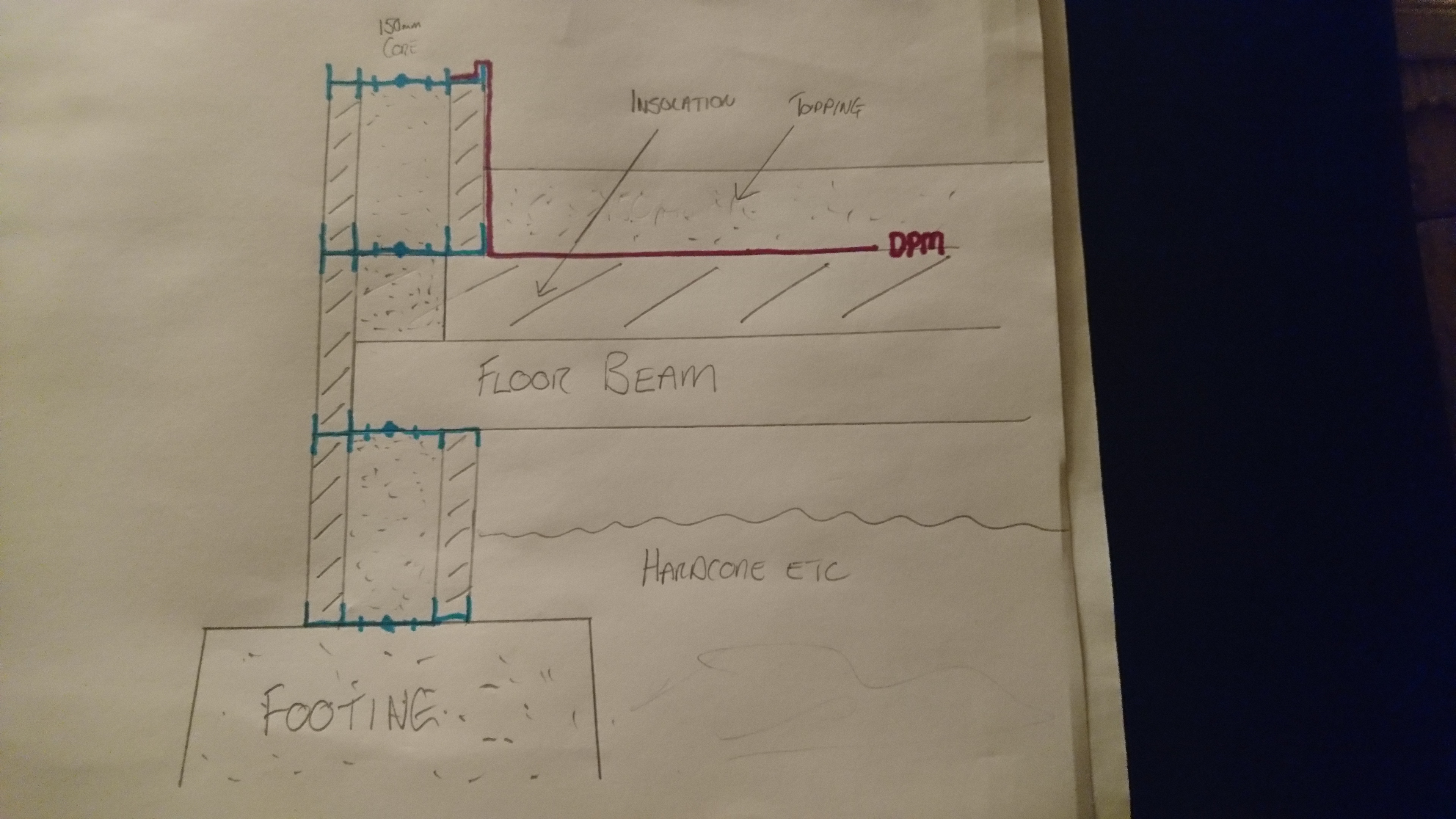

Jeremy Harris Posted February 23, 2017 Posted February 23, 2017 (edited) 11 minutes ago, jamiehamy said: Using ICF for the below ground won't eliminate cold bridging, but it will reduce it significantly or eliminate depending on how you view it. You're spot on, Jamie, if you continue wing insulation down to a couple of feet below ground level, even with a vertical thermal bridge up through the the core, the net effect is to significantly reduce the overall thermal bridge at this point. There was some work done on using below ground peripheral insulation to reduce thermal bridging in refurbs, where taking the floor up to add under floor insulation was impractical, and it is a pretty good mitigation measure. By significantly reducing outward, horizontal, heat transfer, the heat loss path is forced to be vertical, and even though soil isn't that good an insulator, with a deep layer of buried peripheral insulation you can create a deep enough layer of soil under the floor to be a reasonably effective insulator. Edited February 23, 2017 by JSHarris
Vijay Posted February 23, 2017 Author Posted February 23, 2017 43 minutes ago, jamiehamy said: Okay - you're partially right. Using ICF for the below ground won't eliminate cold bridging, but it will reduce it significantly or eliminate depending on how you view it. - I've done a rough sketch to show. @Vijay. This is not based on yours per se just an aside to show what is possible although I think yours will be like this from looking at it? That's pretty spot on to what I'll be doing, except the Polarwall inner panel will come down to and in between the floor beams - so they kind of encapsulate the beam. It's more work cutting them to fit but Alan has said if I get him the exact measurements' he'll cut the fillets to fit for me
PeterW Posted February 23, 2017 Posted February 23, 2017 1 hour ago, Vijay said: That's pretty spot on to what I'll be doing, except the Polarwall inner panel will come down to and in between the floor beams - so they kind of encapsulate the beam. It's more work cutting them to fit but Alan has said if I get him the exact measurements' he'll cut the fillets to fit for me Check with SE and beam supplier on that - the strength in a BB floor comes from the blocks and the beams and you're not supposed to leave voids unless absolutely necessary (soil stack etc) or as agreed with the supplier.

Vijay Posted February 24, 2017 Author Posted February 24, 2017 Decided to call the building control company and the inspector is popping around Monday to confirm he's happy with the depth of the footings so far. My digger mate doesn't really want to go over the same part again and again as the front of the house has a few recesses where the ground is bound to collapse if the digger goes over it too many times.
