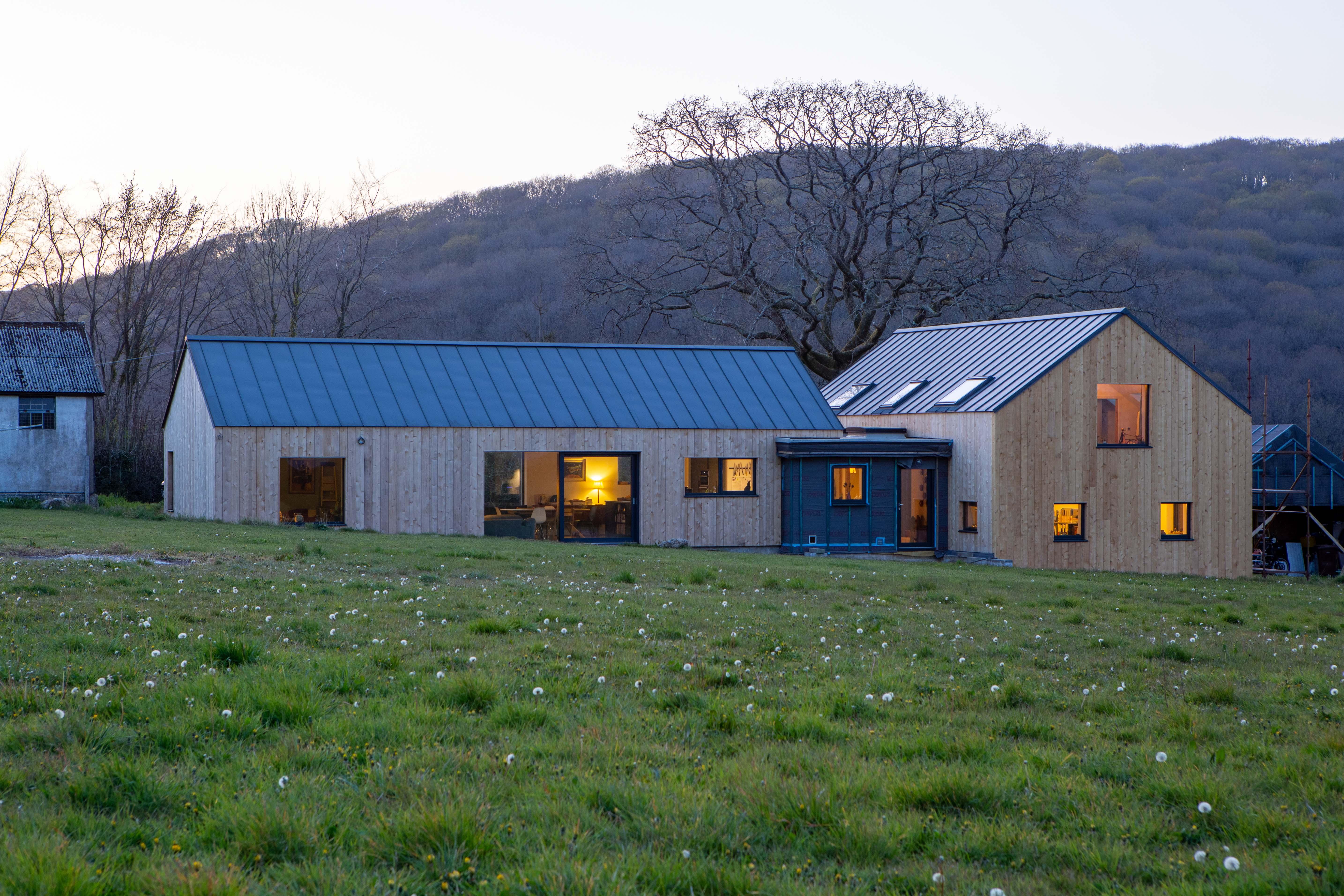

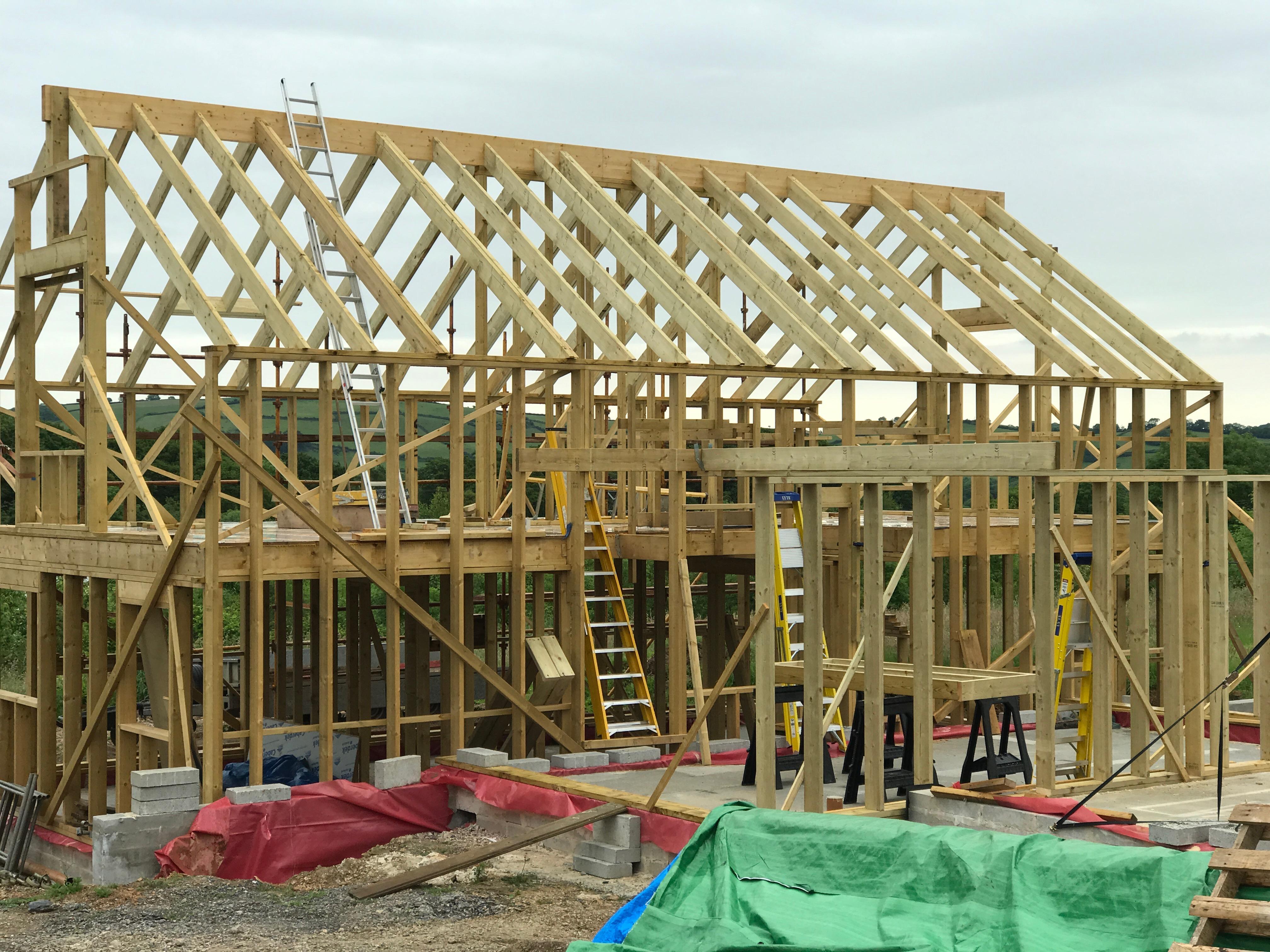

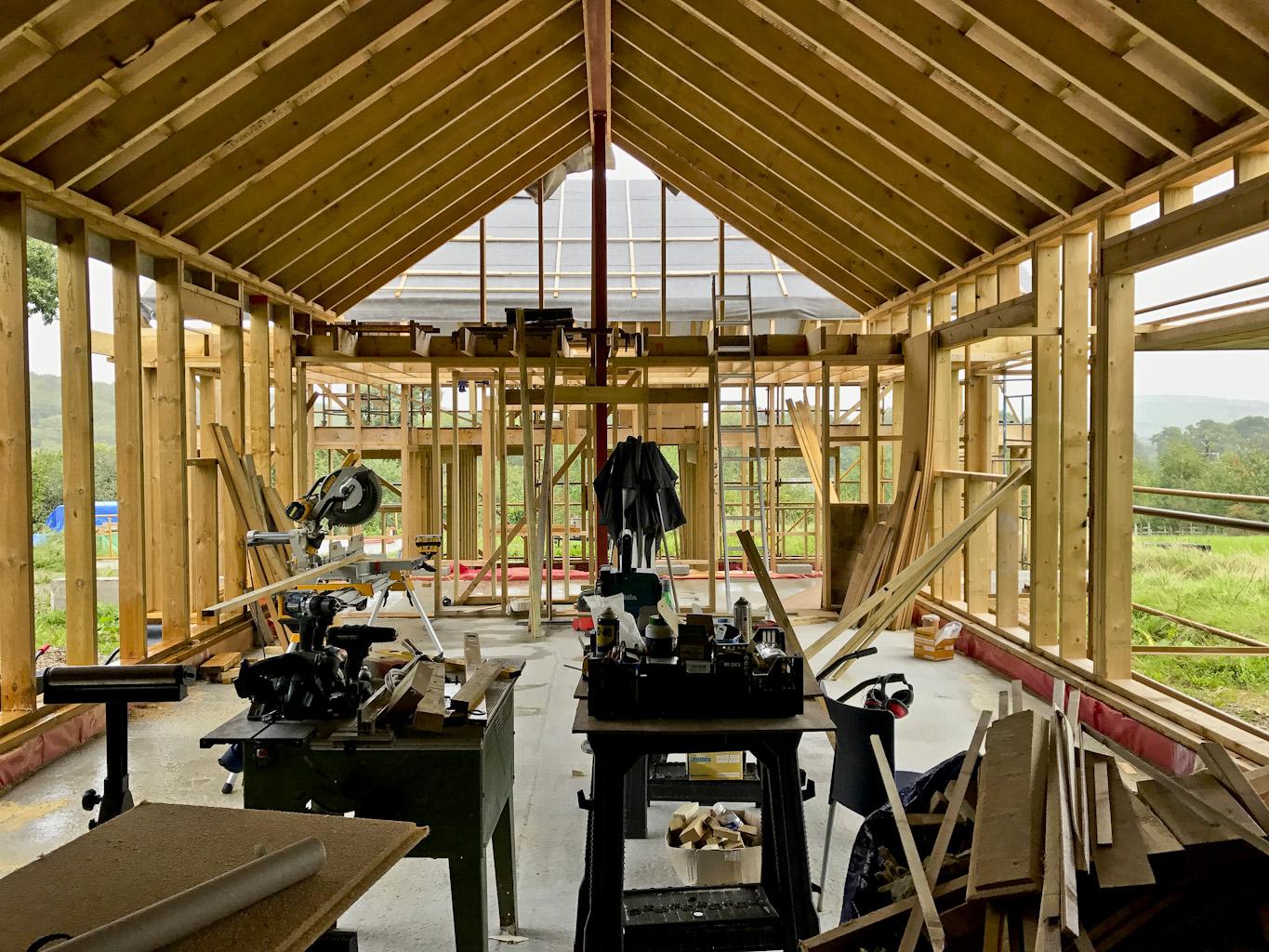

JamesP Posted April 25, 2021 Posted April 25, 2021 @PeterTweeter I stick built my new build as it was feasible with my limited experience, a pleasure todo though a little niche. I cannot imagine large house building companies doing the same. Takes along time to be water tight. Also fitted a Tata Steel roof. Work in progress. 5
DragsterDriver Posted April 25, 2021 Posted April 25, 2021 31 minutes ago, JamesP said: @PeterTweeter I stick built my new build as it was feasible with my limited experience, a pleasure todo though a little niche. I cannot imagine large house building companies doing the same. Takes along time to be water tight. Also fitted a Tata Steel roof. Work in progress. That looks amazing! 1
SimonD Posted April 26, 2021 Posted April 26, 2021 On 25/04/2021 at 11:15, JamesP said: @PeterTweeter I stick built my new build as it was feasible with my limited experience, a pleasure todo though a little niche. I cannot imagine large house building companies doing the same. Takes along time to be water tight. Also fitted a Tata Steel roof. Work in progress. Nice, I bet that was fun! I loved the framing part of my house. 1

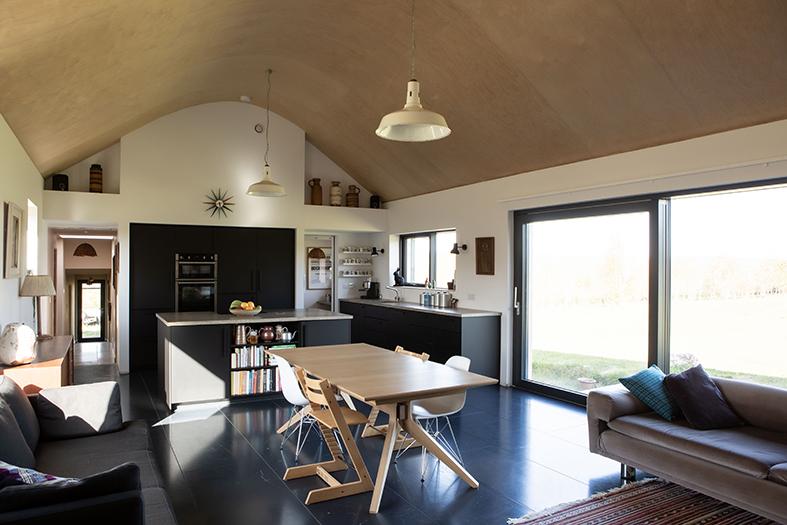

SimonD Posted April 28, 2021 Posted April 28, 2021 15 hours ago, JamesP said: Is that a plywood finish ceiling? If it is, did you have to use an intumescent treatment?
JamesP Posted April 28, 2021 Posted April 28, 2021 1 hour ago, SimonD said: Is that a plywood finish ceiling? If it is, did you have to use an intumescent treatment? Yes, Birch Ply and intumescent coating for Building Control.
SimonD Posted April 28, 2021 Posted April 28, 2021 1 hour ago, JamesP said: Yes, Birch Ply and intumescent coating for Building Control. Ah cool. So now I'm itching to ask how you did the curved section? It's very nicely done. I've got curved ceilings which are to be finished with Birch ply too where the curve is created by the glulam beams.
