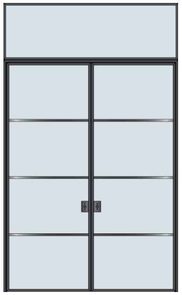

We'd like to install pairs of steel-framed glass doors across the two entrances to our living room. The apertures are both about 2800 high and 1050 wide.
The plan was for a fixed pane at the top, and then a pair of opening doors underneath. Roughly along these lines, although obviously quite a bit narrower:
We've started getting quotes. The couple we had for supply only were £5-7k. Then on Friday we had stunning quote of just shy of £15k, although that includes all measuring and installation.
I appreciate that bespoke solutions are always going to be more expensive, but various standard sizes seem to be available at a tiny fraction of these costs.
Anyone had success with sourcing this sort of thing at a more reasonable price?

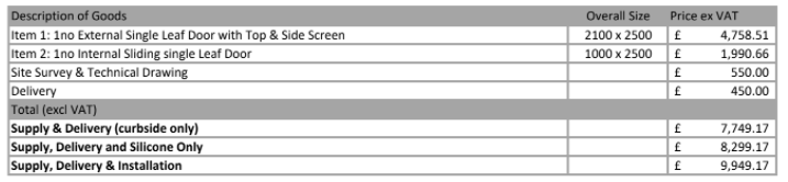

Based on quotes I have had, companies like Fabco might be in the £4k to £7k range, but will include survey and installation, rather than supply only. Here is a quote I had from them for two sets of doors: a large external door and a smaller internal one:
Worth speaking to them and understanding what format would be cheapest, but it might be that it's the extra complexity of having to support that top light and having the sliders being hung from that that take it out of their usual manufacturing process and make it dearer.
