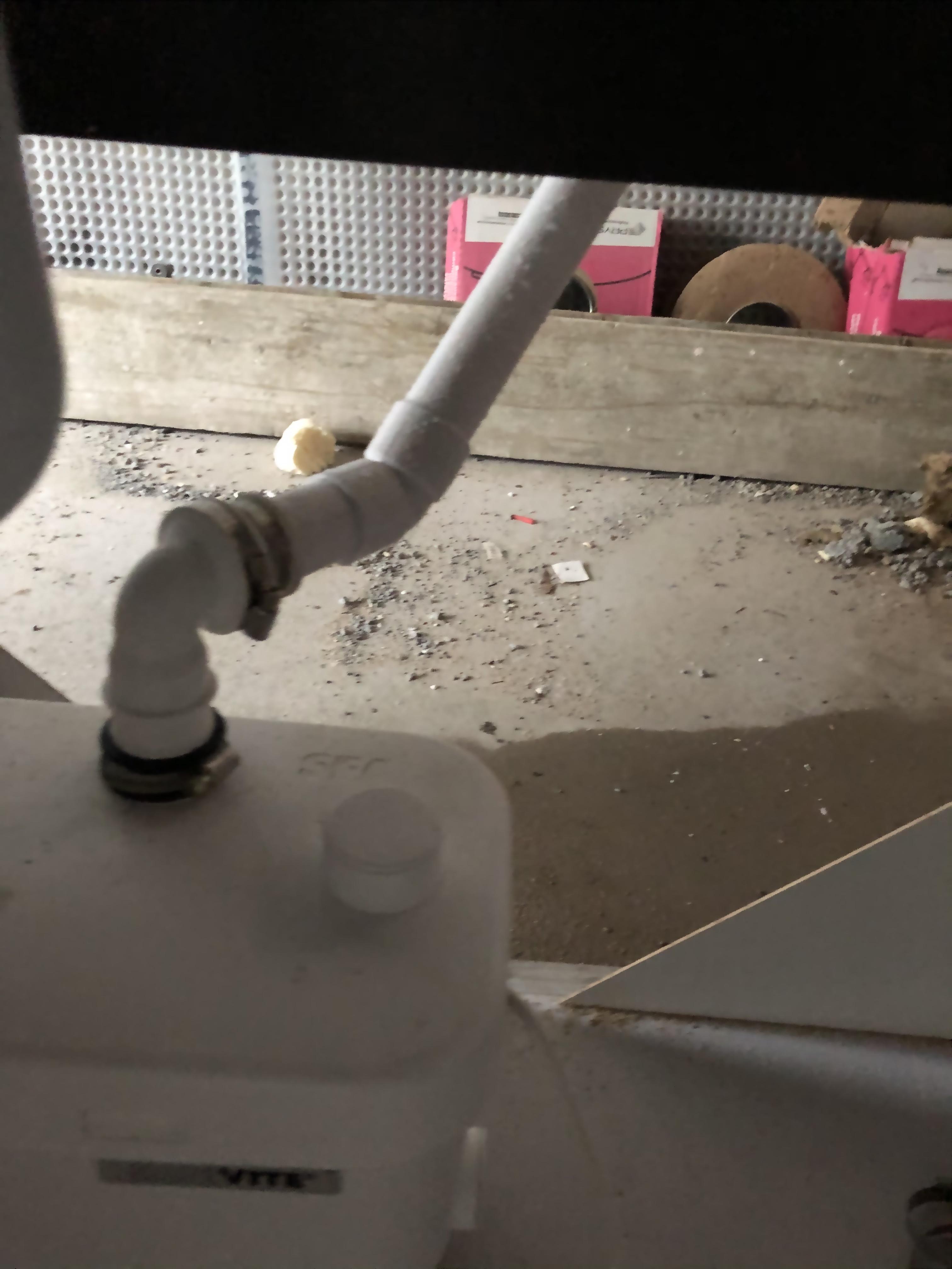

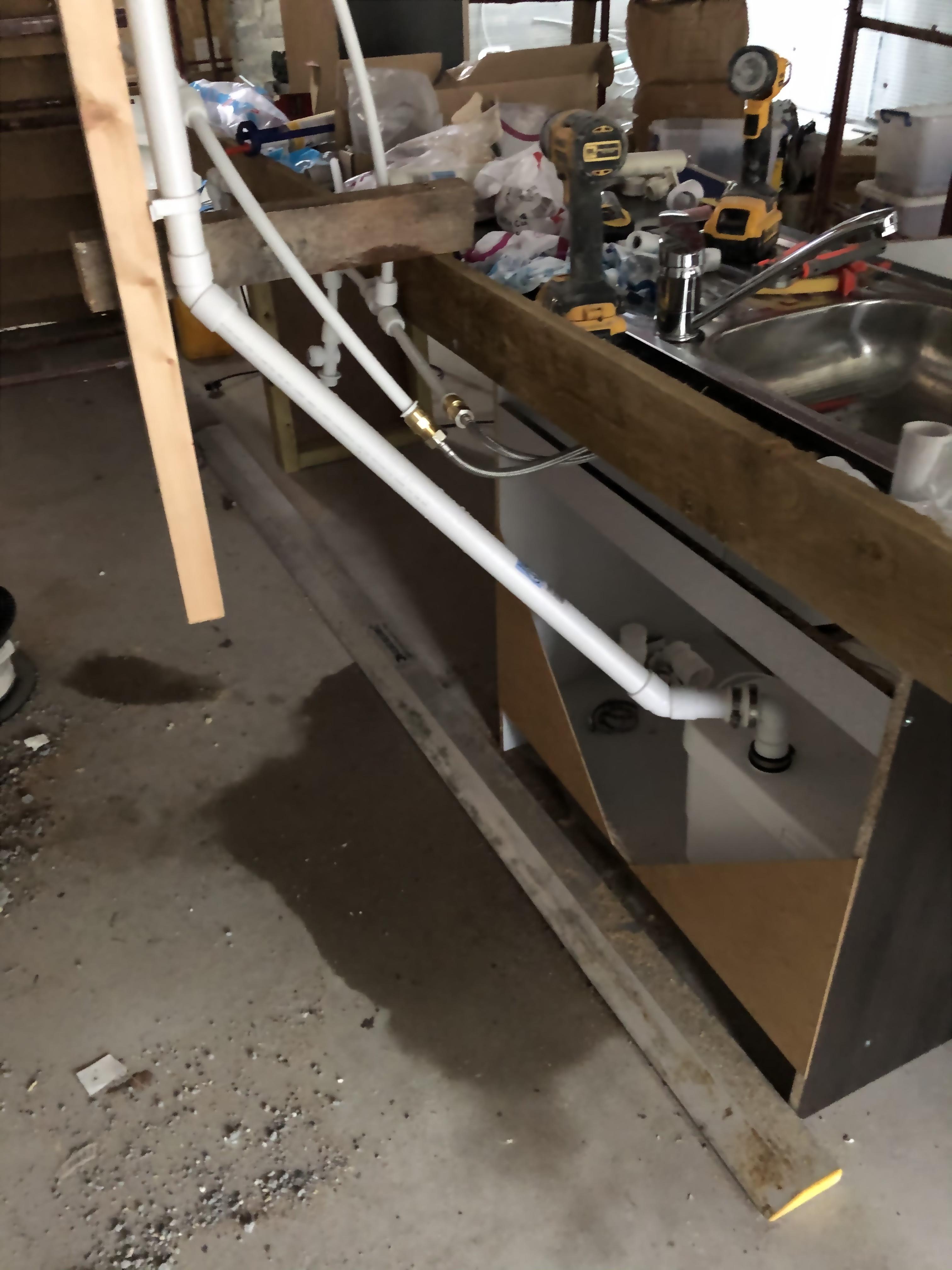

Pocster Posted March 23, 2021 Author Share Posted March 23, 2021 Well it’s all plumbed up . Ran the tap . Macerator runs for about half a second and stops . Are my pipe ‘angles’ the issue ?? Link to comment Share on other sites More sharing options...
Big Jimbo Posted March 23, 2021 Share Posted March 23, 2021 I don't think so. From memory, that pipe will be full of water. It won't pump air up behind it to empty the pipe. The pipe won't start to empty till it starts running downhill. Turn the tap on again, and i'm sure it will kick in. That vertical pipe will always be full of water. 1 Link to comment Share on other sites More sharing options...
Pocster Posted March 23, 2021 Author Share Posted March 23, 2021 6 minutes ago, Big Jimbo said: I don't think so. From memory, that pipe will be full of water. It won't pump air up behind it to empty the pipe. The pipe won't start to empty till it starts running downhill. Turn the tap on again, and i'm sure it will kick in. That vertical pipe will always be full of water. You are right! I stuck my phone over the drain on record then ran downstairs and ran the tap ! Works like a treat ! I guess I was expecting it to be like a ? macerator I.e run on for 4 or 5 seconds . It’s surprisingly quiet . My final question is can I run a washer outlet and dishwasher outlet into the same pipe before going into the macerator or should they each use a seperate macerator inlet ? Link to comment Share on other sites More sharing options...
Big Jimbo Posted March 23, 2021 Share Posted March 23, 2021 1 minute ago, pocster said: You are right! I stuck my phone over the drain on record then ran downstairs and ran the tap ! Works like a treat ! I guess I was expecting it to be like a ? macerator I.e run on for 4 or 5 seconds . It’s surprisingly quiet . My final question is can I run a washer outlet and dishwasher outlet into the same pipe before going into the macerator or should they each use a seperate macerator inlet ? You can run multiple outlets into the same unit fella. I sure that there is the potential for the pump to reach capicity, but with a couple more items only it will be fine fella. 1 Link to comment Share on other sites More sharing options...
