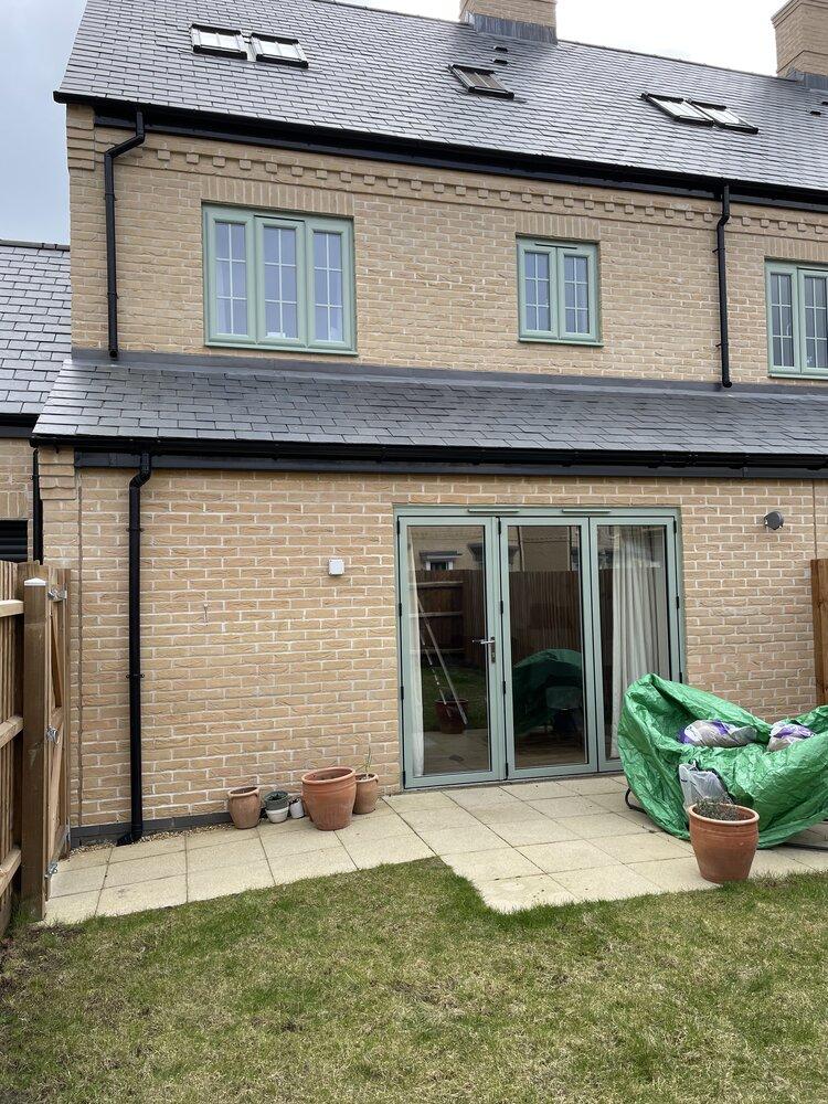

We've noticed our lounge, in our new build, to be particularly cold room of the house. The ceiling of the lounge partly is underneath the upstairs bedroom and partly by a roof (about half and half). Using a temperature gun I notice between a 5 and 10C temp difference between the ceiling which is under the bedroom and that under the roof.
The roof itself is smallish in height and has no access/loft hatch to easily look up there. I have tried looking through plasterboard gap where light fitting is but very difficult. Any tips to check and see how I can check if they have insulated up there (and if so what insulation to expect in that small roof)?
Pictures attached for clarification.
The only real way is to cut a hole in the plasterboard ceiling to have a proper look and then put a small loft hatch in to close the hole.

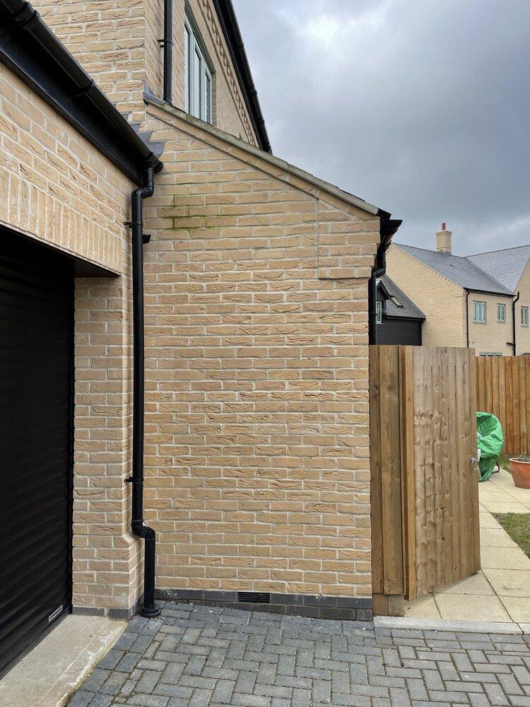

I take it this is a new build ..?? I’d be slightly more worried about the green patch in pic 1 ...
And you have two ways - ceiling down or slates off. I would personally go from the outside in as it’s less intrusive and easier to fix and I’d also be going toward the right of the patio doors to check if the fire barrier is installed between the two houses.

If you have access to a thermal camera it is early enough in the year to spot leaky insulation from outside on a cool day using a thermal photo.

That appears to be coming from boiler flue. Any tips on that? Or is there something else there? How would I check fire barrier?
What’s the distance from the boiler flue to the corner of the wall?
isn’t it meant to be a certain distance from an internal corner?

Yep - 300 from an internal corner and 150 from a downpipe or soil pipe....
that should have a plume management kit on it to take it upward and turn at 90 degrees to the wall.
https://nhbc-standards.co.uk/6-superstructure-excluding-roofs/6-8-fireplaces-chimneys-and-flues/6-8-12-gas-outlets-and-terminals/

See above - can you take a photo straight on to this..?? And is this a major developer build with an NHBC warranty ..??
Fire barrier ..?? Will look like either a blockwork wall or a lot of chicken wire stuffed with insulation inside that roofspace on the boundary.

OK thanks for that I will get that reported/sorted. It is a condensing boiler flue that one. has a long pipe in the garage but it is very close to that corner.
