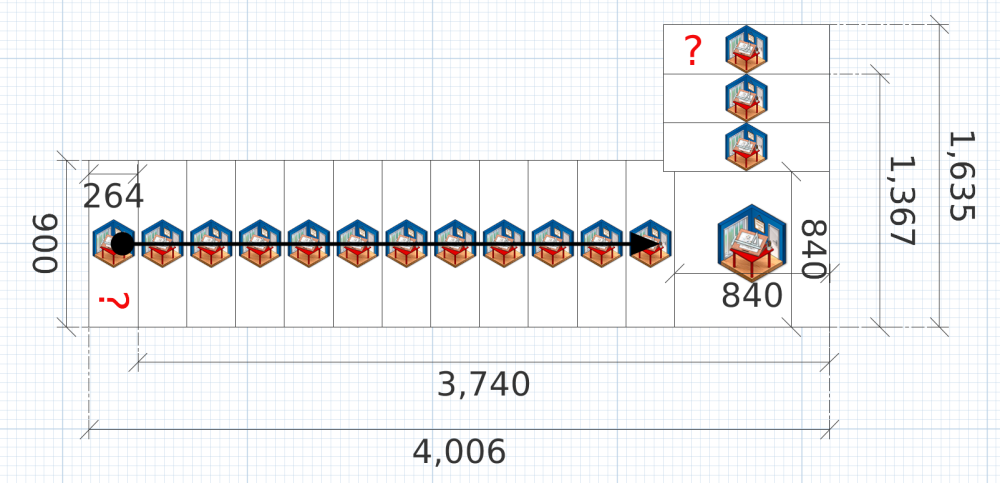

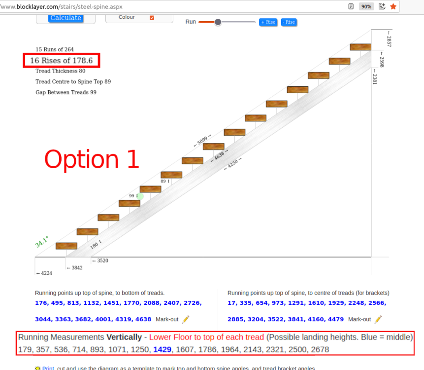

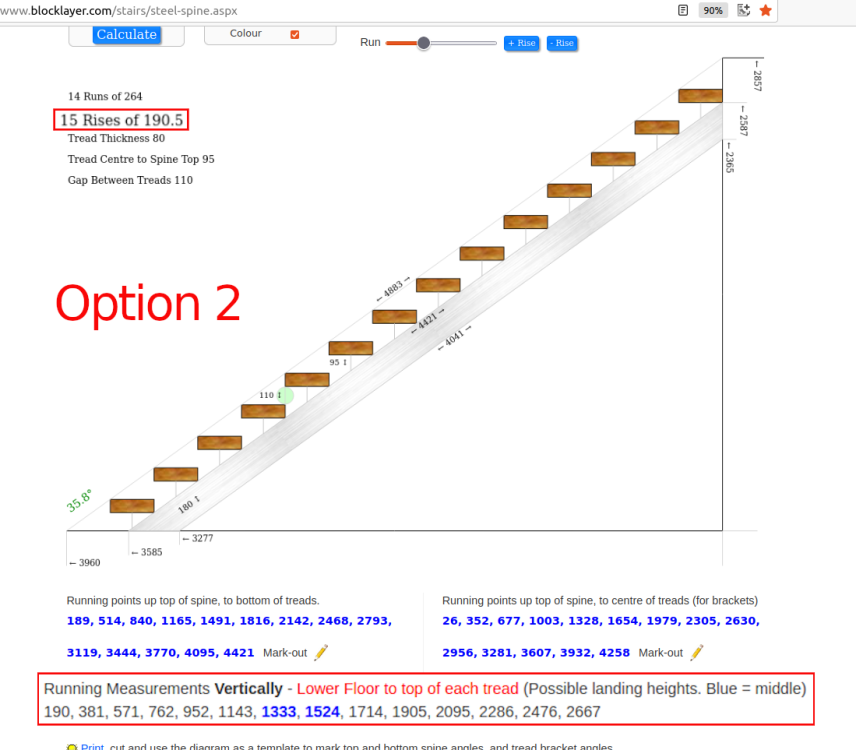

30 minutes ago, sruk said:
to achieve 38.1 degrees I can use 244 going (no nosing) and 191.1 rise (R*2+G=626.2) th4 going will be very close to the current only the rise will be more, not sure if going with a rise of 191.1mm will be comfortable.
correction to above figures, 243 going and 190.8 rise (R*2+G=624.6), is 190.8 rise considered comfortable?
thanks
