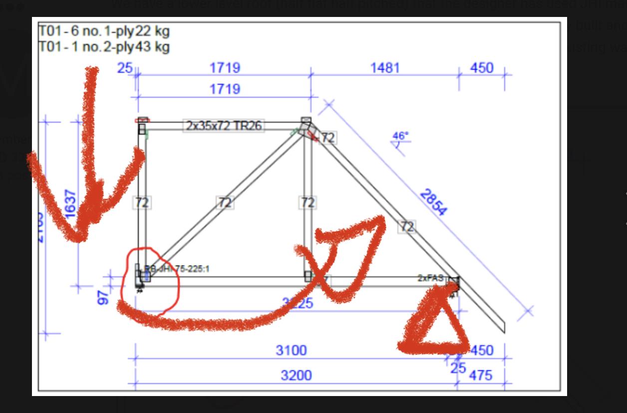

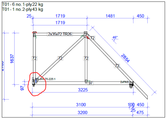

We have a lower level roof (half flat half pitched) that the designer has used JHI masonry hangers to attach to the wall at one end (circled below). The wall is already built and I was wondering if people thought cutting a masonry joist hanger in to an existing wall is harder than using a ledger board and timber joist hangers?

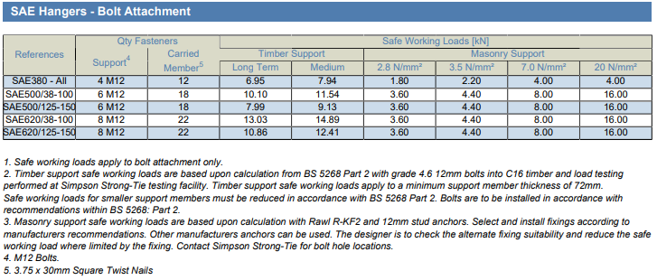

1 minute ago, Russell griffiths said:

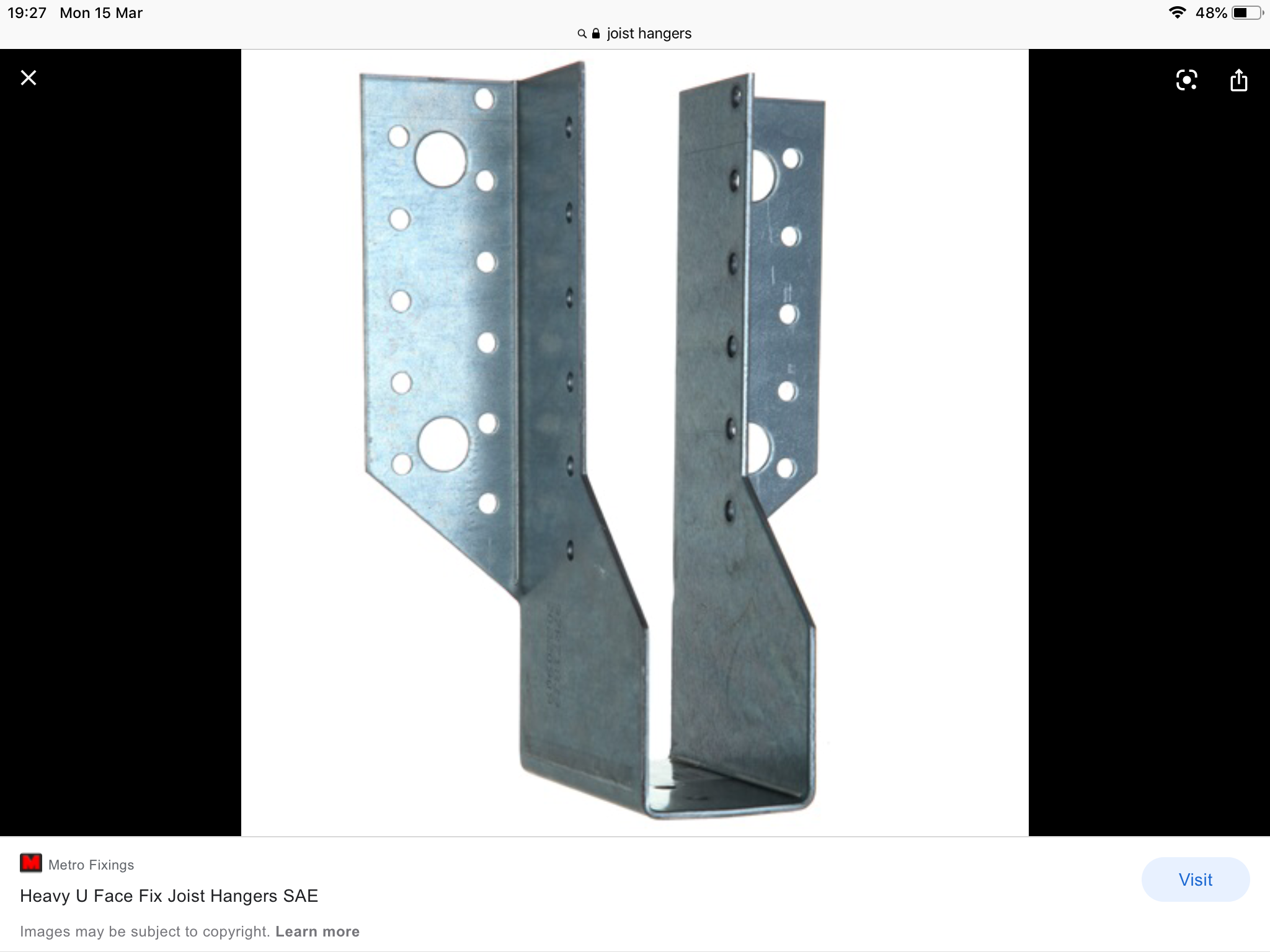

If you use this type you can just bolt on.   [Simpson SAE]
Yes I saw that type when looking just now and that doesn't have any tabs that tuck in. I like the sound of the hybrid approach you described as that seems like the best of both worlds.

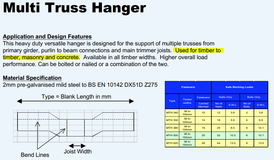

The SWL (probably 2.2kN aka 220kg) isn't particularly good which is a shame [datasheet]. The tuck in type have about 3x the SWL [their datasheet].

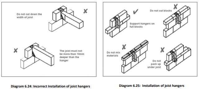

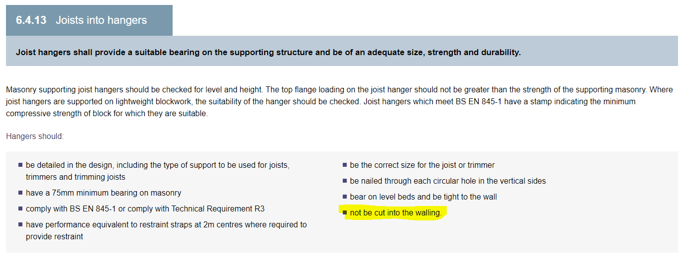

Yes I'm going to go that way. I also saw that he NHBC says that masonry hangers shouldn't be cut "into the walling" I presume that means shouldn't be retro fit rather than saying it shouldn't be cut in to the block itself. Also, some other warranty providers stipulate that materials shouldn't be mixed in the area and I have a transition from blockwork to brickwork at this level.
Ignore the NHBC. They say a lot of things that go against the MIs and in the end it will be a question of whether you’ve followed the MIs rather than a trade body if things go wrong.
I would be using a strongly restrained fixing in your case as there is more of a rotational pull on those mountings as the truss will try and pivot on the wall plate and the top mounting.
I don't see what you mean. tipping of the hanger side to side? There isn't a top mounting just bracing.
Posted
so your truss will rotate about the fixed point. The wall plate on the right is static (red triangle) the weight of the truss will try and push downward but rotate around its axis so there is a pull force exerted on the fixings of the bottom chord and it will try and push itself past the wall plate.
Crude arrows below ..!!
Posted
Hi MortarThePoint.

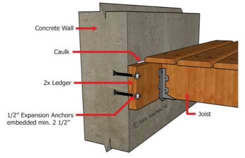

The ledger option can work well but as Peter points out you get this twisting effect.
Often you get stuck with ledgers as you stuggle to get the fixing capacity. Many fixings are rated on, not least, being fixed away from the mortar bed etc. If you have perforated bricks say the capacity of the fixings really drops off. Expanding type anchors don't work well in perforated brick and there is little test data available.
I have attached a very quick sketch showing another way of doing this where you extend the bottom chord and pocket the wall. You can add glued hardwood packers to level up. Here you get a good solid bearing on the masonry and by using the dwangs / noggings you can add extra horizontal tying of the trusses into the existing wall.
You may need to beef up the bottom chord a little as it is acting in shear rather than bearing.
Thank you for the consideration and the diagram! I think it will only try to pull laterally if the top vertical left hand member in the diagram contacts the wall, which it doesn't. That vertical member is 25mm nominal from the wall so the only member contacting static points is the bottom chord at the wallplate (R) and at the hanger (L).
