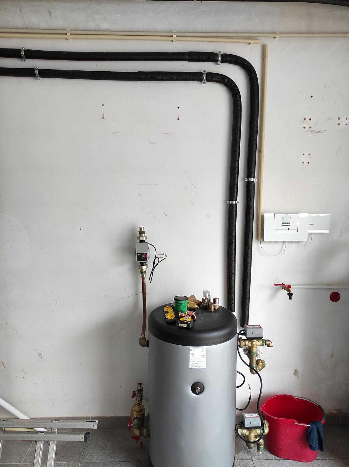

Bruno Posted April 21, 2021 Author Posted April 21, 2021 Here's a picture taken during installation. Sorry about the mess :) You can see the buffer tank, the 2 3-way valves (on the right of the tank) and the circulating pump (on the left). Further on the right there's the Vaillant controller which receives the temperature probes and feeds the valves and circulating pump. It's not on the picture but to the right of all that there's the DWH cylinder.

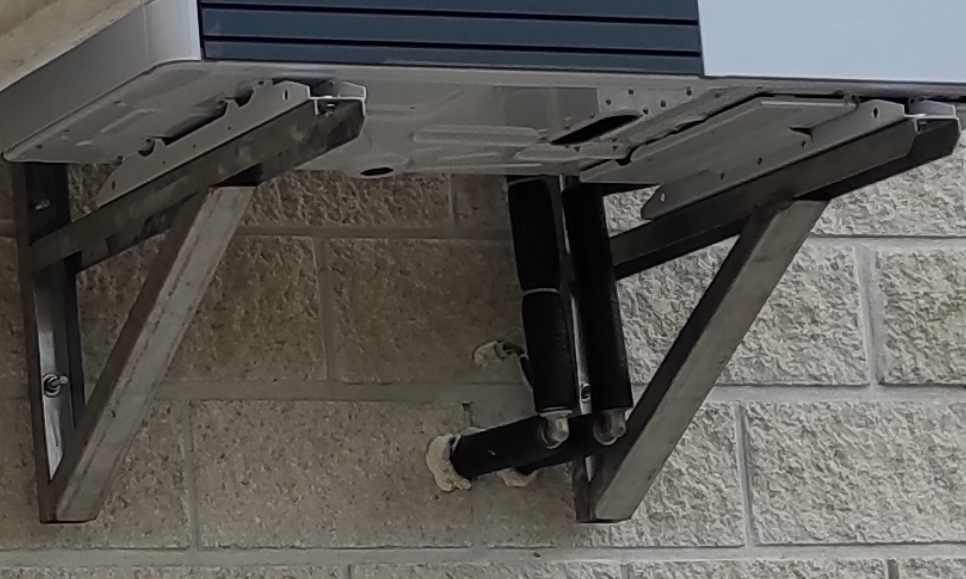

Bruno Posted April 23, 2021 Author Posted April 23, 2021 I need some further advice on 2 issues, both related to the installation. - insulation of the pipes and connections. Although the installer was very careful in distributing the pipes on the wall to reduce "dead space", I'm a bit concerned about insulation. All pipes have an external insulation sleeve, which is the same on the inside and outside. But all connection parts (especially 90º metallic - brass? - curves) are not insulated at all. Outside, there are 2 of these curves. Inside, around the 3-way valves there is big "set" of metallic parts which are all exposed and do heat up a lot when the heat pump is working. Isn't this something which might represent significant heat losses especially in winter? Do you have any recommendation for better insulation, or shouldn't I be worried? I did ask the installer about this, he claims that this is the standard way of doing it. - vibration noises in the structure The heat pump was mounted on the wall as I cannot put it on the ground. During the night when everything is silent there is an audible humming noise which seems to come from the structure of the house. Although this seems to be a frequent problem, it's something that never came up in all the previous reading and research I did. The solutions I found out now are some rubber pads, but I would like to ask if someone already encountered this issue and which kind of pads are the safest bet in fixing this problem? I discussed this with the installer, we will go ahead and do a first test with a small rubber piece just to check if there is some improvement.
Nickfromwales Posted April 28, 2021 Posted April 28, 2021 Assuming the heat pump is bolted to a frame, and the frame is bolted to the building? Then; These for each of the 'feet' of the heat pump and go from there. If that reduces but does not solve the problem, then look at similar to separate the frame from the building. and; This stuff for insulating anything that doesn't need any regular disassembly. 1
dpmiller Posted April 28, 2021 Posted April 28, 2021 There are flexible hoses between the ASHP and the pipes in the wall?
Bruno Posted April 28, 2021 Author Posted April 28, 2021 (edited) On 28/04/2021 at 11:50, Nickfromwales said: Assuming the heat pump is bolted to a frame, and the frame is bolted to the building? Expand Yes, it is. Thank you, I actually have access to these rubber pads for free ? Will try them shortly. On 28/04/2021 at 15:22, dpmiller said: There are flexible hoses between the ASHP and the pipes in the wall? Expand No, there aren't. It's just 3 sets of 90º curved sections. Here's a picture which shows both the tubing and the wall mounting Edited April 28, 2021 by Bruno
Marvin Posted April 28, 2021 Posted April 28, 2021 Hi Bruno I would insulate the pipes as much as possible. It will do no harm and only help. I wouldn't worry about industry standard, only a better standard. The only thing I would say is to avoid insulation around electrical parts like the box on the port valves next to your tank. Marvin 1
