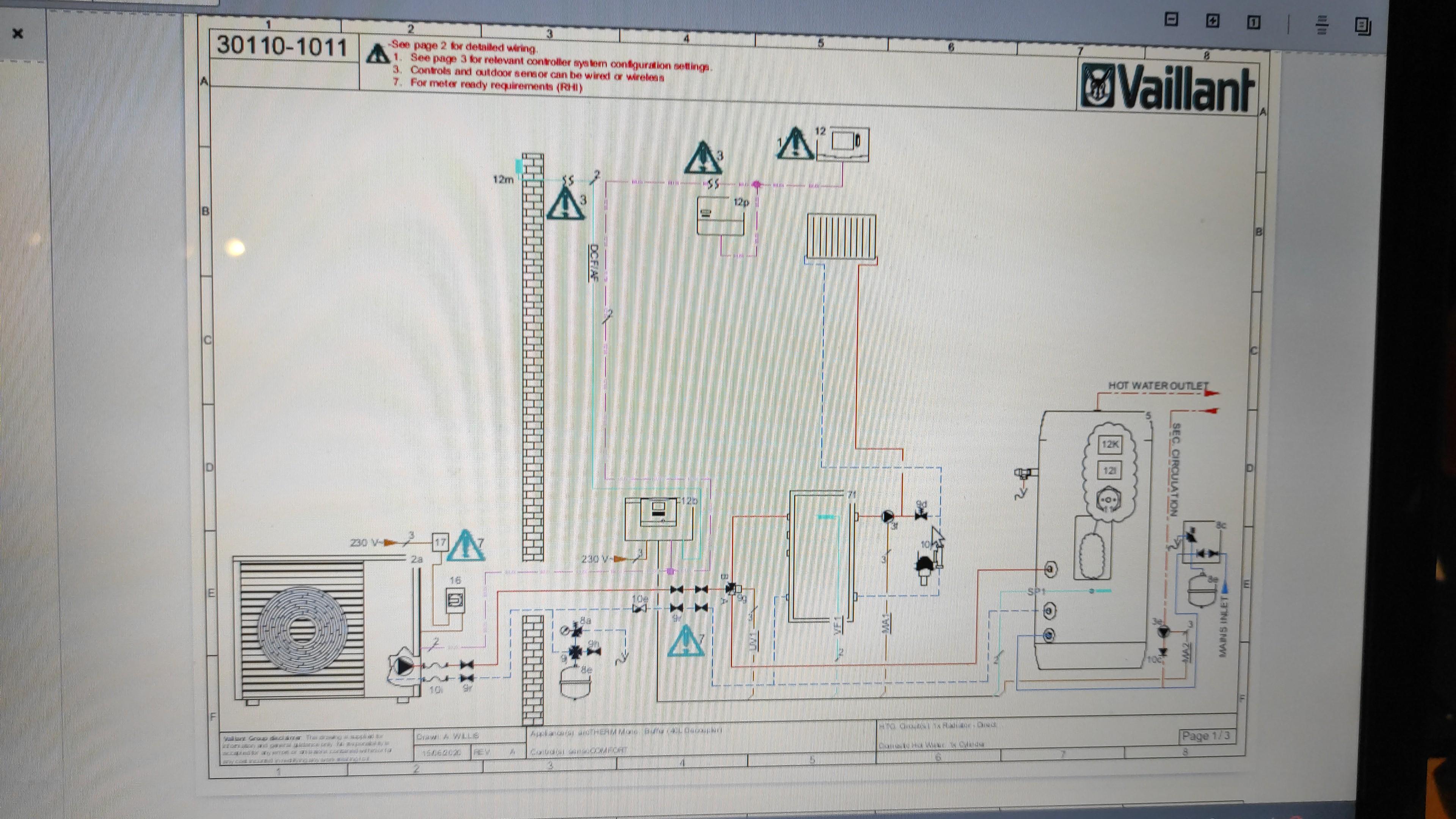

Bruno Posted March 23, 2021 Author Posted March 23, 2021 I found the installation manual from Vaillant. I'm pretty sure I would be able to do this myself ?
J1mbo Posted March 24, 2021 Posted March 24, 2021 (edited) Certification is required to work on the unvented side (even though the ASHP cannot actually boil the water, though the immersion clearly can) and the system needs glycol. The other issue is that the system only gets 7 years warranty if installed and serviced by an approved installer. Edited March 24, 2021 by J1mbo
