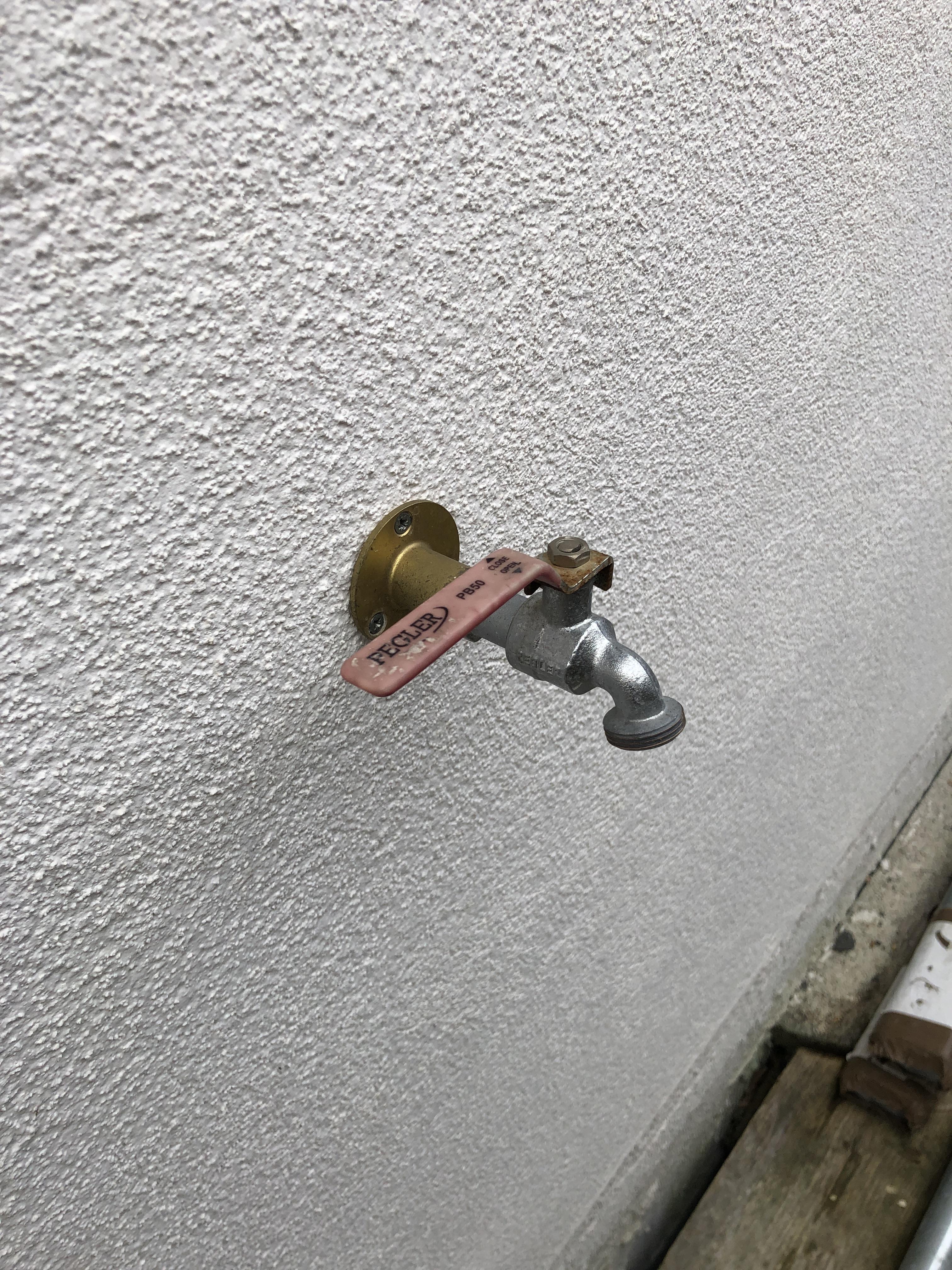

Pocster Posted March 13, 2021 Share Posted March 13, 2021 Look @jfb even I did it !!! ??? Link to comment Share on other sites More sharing options...
Onoff Posted March 13, 2021 Share Posted March 13, 2021 18 minutes ago, pocster said: Look @jfb even I did it !!! ??? Why not a brass one (that wouldn't rust)? Link to comment Share on other sites More sharing options...
joe90 Posted March 13, 2021 Share Posted March 13, 2021 Actually I have one of those lever handle outside taps and prefer them. ? 1 Link to comment Share on other sites More sharing options...
Pocster Posted March 13, 2021 Share Posted March 13, 2021 18 minutes ago, Onoff said: Why not a brass one (that wouldn't rust)? The lever is better . Also F off Link to comment Share on other sites More sharing options...
