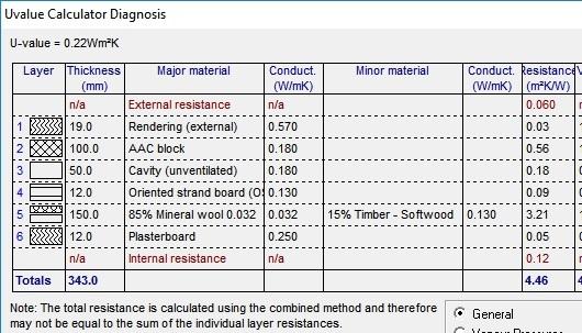

A_L Posted March 12, 2021 Posted March 12, 2021 1 hour ago, Mike_scotland said: Ground - 0.15 You have previously said the ground floor is 19m x 7.5m and I gave a U-value 0f 0.11 for 150mm PIR. What is the thickness and type of the insulation? 1 hour ago, Mike_scotland said: 0.14 exposed floor?? Do you have a floor on the first floor which has outside environment below it? Is some of your ground floor suspended and some 'slab on ground'? 1 hour ago, Mike_scotland said: Walls 0.22 (i think quite poor sounding) Here is a simulation below. So about right. As I said before you should add about 100mm of same insulation or equivalent to get about 0.13. The roof is O.K.

A_L Posted March 12, 2021 Posted March 12, 2021 (edited) @Mike_scotland, The floor only has 110mm of insulation not 150mm and is correct. Also because layer 4 is next to a ventilated airspace its thermal resistance should be disregarded, a small additional thermal resistance, 0.29m2K/W can be added to allow for a thicker external resistance layer because of lower air velocities. This would be quite significant. Edited March 12, 2021 by A_L to add 'can be added'
Mike_scotland Posted March 12, 2021 Author Posted March 12, 2021 4 minutes ago, A_L said: @Mike_scotland, The floor only has 110mm of insulation not 150mm and is correct. Also because layer 4 is next to a ventilated airspace its thermal resistance should be disregarded, a small additional thermal resistance, 0.29m2K/W to allow for a thicker external resistance layer because of lower air velocities. This would be quite significant. How do you mean? Would it help the sap or make it worse?
A_L Posted March 12, 2021 Posted March 12, 2021 1 minute ago, Mike_scotland said: How do you mean? Would it help the sap or make it worse? Removing layer four would increase the U value and in theory make the SAP score worse but in practice may be to small to actually affect it. 1

A_L Posted March 12, 2021 Posted March 12, 2021 6 minutes ago, Mike_scotland said: Do you reckon add another 100mm of wool insulation to the walls? Yes, or another insulation to the same effect, it should cover the timber studs to reduce the thermal bridging effect of heat being transferred through the timber. 10 minutes ago, Mike_scotland said: Is it floor and walls that need looked at? The walls have been dealt with above, the floor is O.K.(ish) but re-visit what I said previously what I said about having it in one layer. 12 minutes ago, Mike_scotland said: The roof is 0.12 but its a 1.5 storey sort of thing so that will be our walls upstairs. Have all/any of the horizontal and sloping ceilings and vertical walls all been considered?
