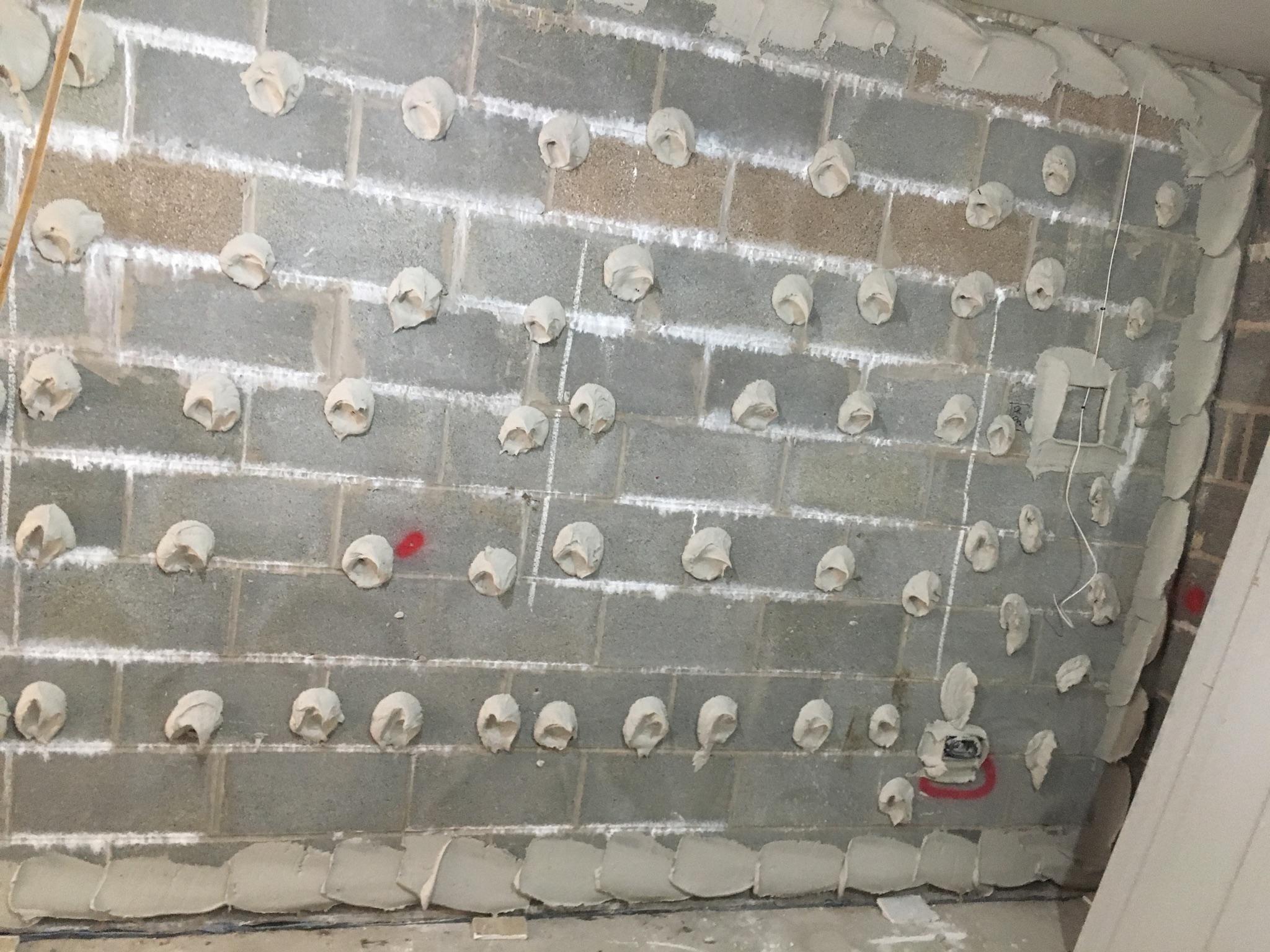

nod Posted March 9, 2021 Share Posted March 9, 2021 48 minutes ago, WWilts said: Getting the plasterboard junctions well taped seems to be the critical point, as well as sealing windows/doors. Will aim for as low as possible, then might well achieve better than 4.0 It is and around and under windows and doors Get that right and you have no need to worry about airtightness I took this photo when I started plastering ours My trusted helper also Mixed every bag of plaster and 250 bags of render I’ve got her a battery mixer for our next build Link to comment Share on other sites More sharing options...

Moonshine Posted March 9, 2021 Share Posted March 9, 2021 16 minutes ago, nod said: Those dabs around sockets, beautiful 1 Link to comment Share on other sites More sharing options...
nod Posted March 9, 2021 Share Posted March 9, 2021 10 minutes ago, Moonshine said: Those dabs around sockets, beautiful Yeah it’s not rocket science But everything must be sealed Good practice to run a line of acoustic sealant around all ceiling angles also Link to comment Share on other sites More sharing options...
