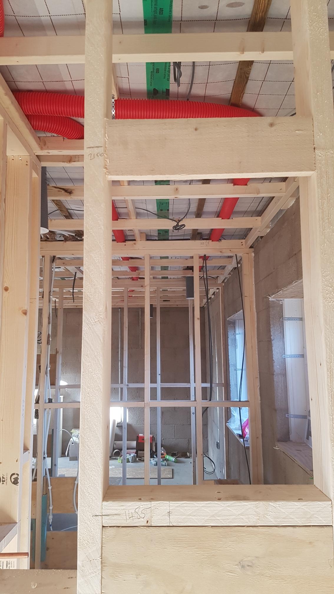

Oz07 Posted March 6, 2021 Share Posted March 6, 2021 Cavity closers built in, blockwork pargecoated inc reveals upto closers. Windows fitted, clearance caps left unfilled at fitting. Window board fitted foamed underneath with decent 10mm ish gap. Illbruck airtight foam. 10mm ish OSB board cut into strips roughly sized from back of window frame to face of blockwork. These all stuck to blockwork/lintel obviously spanning junction of cavity closer to blockwork. Illbruck airtight foam again. Fill window gaps in internally at this point also. Screw plasterboard onto osb job done. Wetting the OSB and blockwork/lintel seemed to help. It's a pain to set up but easy if long winded after. Window board goes on first to give you a level platform. A jig built to hold the head OSB while the foam gets it. After half a day than comes out and reveals cam be stuck on and held with friction or a couple of temp pins into head and window board. Good for blind fixing in head too. 1 Link to comment Share on other sites More sharing options...
Moonshine Posted March 6, 2021 Author Share Posted March 6, 2021 3 minutes ago, Oz07 said: Cavity closers built in, blockwork pargecoated inc reveals upto closers. Windows fitted, clearance caps left unfilled at fitting. Window board fitted foamed underneath with decent 10mm ish gap. Illbruck airtight foam. 10mm ish OSB board cut into strips roughly sized from back of window frame to face of blockwork. These all stuck to blockwork/lintel obviously spanning junction of cavity closer to blockwork. Illbruck airtight foam again. Fill window gaps in internally at this point also. Screw plasterboard onto osb job done. Wetting the OSB and blockwork/lintel seemed to help. It's a pain to set up but easy if long winded after. Window board goes on first to give you a level platform. A jig built to hold the head OSB while the foam gets it. After half a day than comes out and reveals cam be stuck on and held with friction or a couple of temp pins into head and window board. Good for blind fixing in head too. Sounds interesting, have you got any drawings / pictures? Link to comment Share on other sites More sharing options...
Oz07 Posted March 6, 2021 Share Posted March 6, 2021 I lost my phone between end of first fix and plastering so lost a load. I have some pics but non which I think show that detail luckily had some with wires/pipes I'll see if any in background. No drawings I made it up on the hoof Link to comment Share on other sites More sharing options...
Oz07 Posted March 6, 2021 Share Posted March 6, 2021 Found one which shows the bathroom window and a small window in another room. These don't have the jambs on yet as I went round doing all the heads first with the jig. Just do a window every few hrs 2 or 3 a day while doing other things. Link to comment Share on other sites More sharing options...
