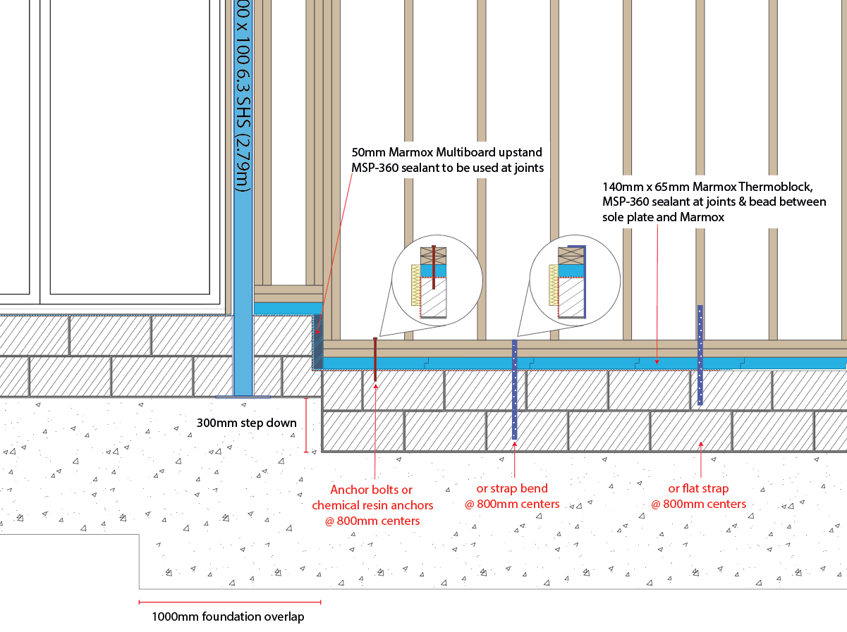

SeanDean Posted March 2, 2021 Posted March 2, 2021 Hello all I'm at the stage where I'm looking for the best solution to strap/bolt down the soleplate of my TF to the blockwork and I am looking for your opinions/advice. I'm currently looking for one of the following options fixed @ 800mm centres: - Anchor bolts down through the soleplate. - Chemical resin anchors down through the soleplate. - Strap bend on the outside of the blockwork going up and over the soleplate. - Flat strap on the outside of the blockwork that goes up the studs. Any advice and help would be greatly appreciated.
Russell griffiths Posted March 2, 2021 Posted March 2, 2021 You can get a strap that does all of those jobs in one. Think it’s made by CULLUN timber connectors, it’s basically a strap with a foot on it with a hole in it, so it nails to the stud, pushes down onto the sole plate and bolts through to the underlying blockwork. With regards spacing this is normally dictated by your racking board layout, so position is at the start and finish of racking boards. So up the first stud then on the one 1200 away. But that all needs someone far cleverer than me to decide.
SeanDean Posted March 3, 2021 Author Posted March 3, 2021 14 hours ago, Russell griffiths said: You can get a strap that does all of those jobs in one. Think it’s made by CULLUN timber connectors, it’s basically a strap with a foot on it with a hole in it, so it nails to the stud, pushes down onto the sole plate and bolts through to the underlying blockwork. With regards spacing this is normally dictated by your racking board layout, so position is at the start and finish of racking boards. So up the first stud then on the one 1200 away. But that all needs someone far cleverer than me to decide. Cheers for the info, I have been trying to find the timber connectors you speak of but its proving difficult and I'm just coming across standard straps. I was hoping to just adopt one of the methods, is this wrong and should I be adopting more that one? What are your thoughts on the DPC being pierced when using anchor bolts or resin anchors? I'm not sure what the racking boards are that you refer to, I have researched this but can't find this term relating to timber frame construction. Cheers.

TonyT Posted March 3, 2021 Posted March 3, 2021 I would use an anchor bolt, either 400 or 600 spacing so there is one fixing per bay. m10/m12. sds drill bit through the timber into the masonry in one go. 1

Russell griffiths Posted March 3, 2021 Posted March 3, 2021 24 minutes ago, TonyT said: I would use an anchor bolt, either 400 or 600 spacing so there is one fixing per bay. m10/m12. sds drill bit through the timber into the masonry in one go. This method is perfectly adequate, however your relying on your sheathing board transferring the resistance to other parts of the frame. With a tie that is fixed to a stud it uses the stud to hold the frame down, not just the sole plate. Really down to the engineer designing it and what loads are on it and wind loading. The last stick frame I did was in a cyclonic area so I tend to be a bit belt n braces. 1
TonyT Posted March 3, 2021 Posted March 3, 2021 32 minutes ago, Russell griffiths said: This method is perfectly adequate, however your relying on your sheathing board transferring the resistance to other parts of the frame. With a tie that is fixed to a stud it uses the stud to hold the frame down, not just the sole plate. Really down to the engineer designing it and what loads are on it and wind loading. The last stick frame I did was in a cyclonic area so I tend to be a bit belt n braces. Agree. i never work to a minimum specification. money well spent at the correct time, pays dividends later. 1

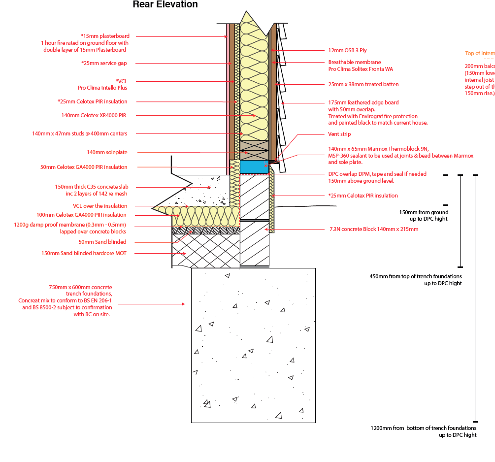

SeanDean Posted March 4, 2021 Author Posted March 4, 2021 On 03/03/2021 at 12:54, Mr Punter said: Can't the straps go on the inside? less likely to corrode. Ideally, they would but then that would mean they would need to penetrate the DPM that comes from under the base and laps up over my blockwork. Is it ok to do this and if so do the areas the straps penetrate need to be taped or sealed up some home?

SeanDean Posted March 4, 2021 Author Posted March 4, 2021 17 hours ago, TonyT said: I would use an anchor bolt, either 400 or 600 spacing so there is one fixing per bay. m10/m12. sds drill bit through the timber into the masonry in one go. Cheers for your input, what are your thoughts/solution on penetrating the DPC?
SeanDean Posted March 4, 2021 Author Posted March 4, 2021 Some really useful responses from you all that have really helped me understand what I need a lot more and the reasons why. I'm going to work on a solution that includes anchor or resin bolts along with a strap like the one below, I just need a solution for sealing the DPC after it's been penetrated along with sealing the DPM if I put the straps on the inside of the build. Any input would be greatly appreciated.
Mr Punter Posted March 4, 2021 Posted March 4, 2021 12 minutes ago, SeanDean said: Ideally, they would but then that would mean they would need to penetrate the DPM that comes from under the base and laps up over my blockwork. Is it ok to do this and if so do the areas the straps penetrate need to be taped or sealed up some home? If you have a section drawing it would be useful. Handy to see foundation, ext level, slab, insulation ffl etc. 1
SeanDean Posted March 4, 2021 Author Posted March 4, 2021 2 minutes ago, Mr Punter said: If you have a section drawing it would be useful. Handy to see foundation, ext level, slab, insulation ffl etc. Hope this helps
Mr Punter Posted March 4, 2021 Posted March 4, 2021 I would have stainless steel restraint straps externally. Have the top bent over top of the sole plate and then rum down the outside 500mm and fix to the blockwork with plugs and stainless screws. Get them 1200 long and cut in half. Light duty if the engineer says it is OK.
