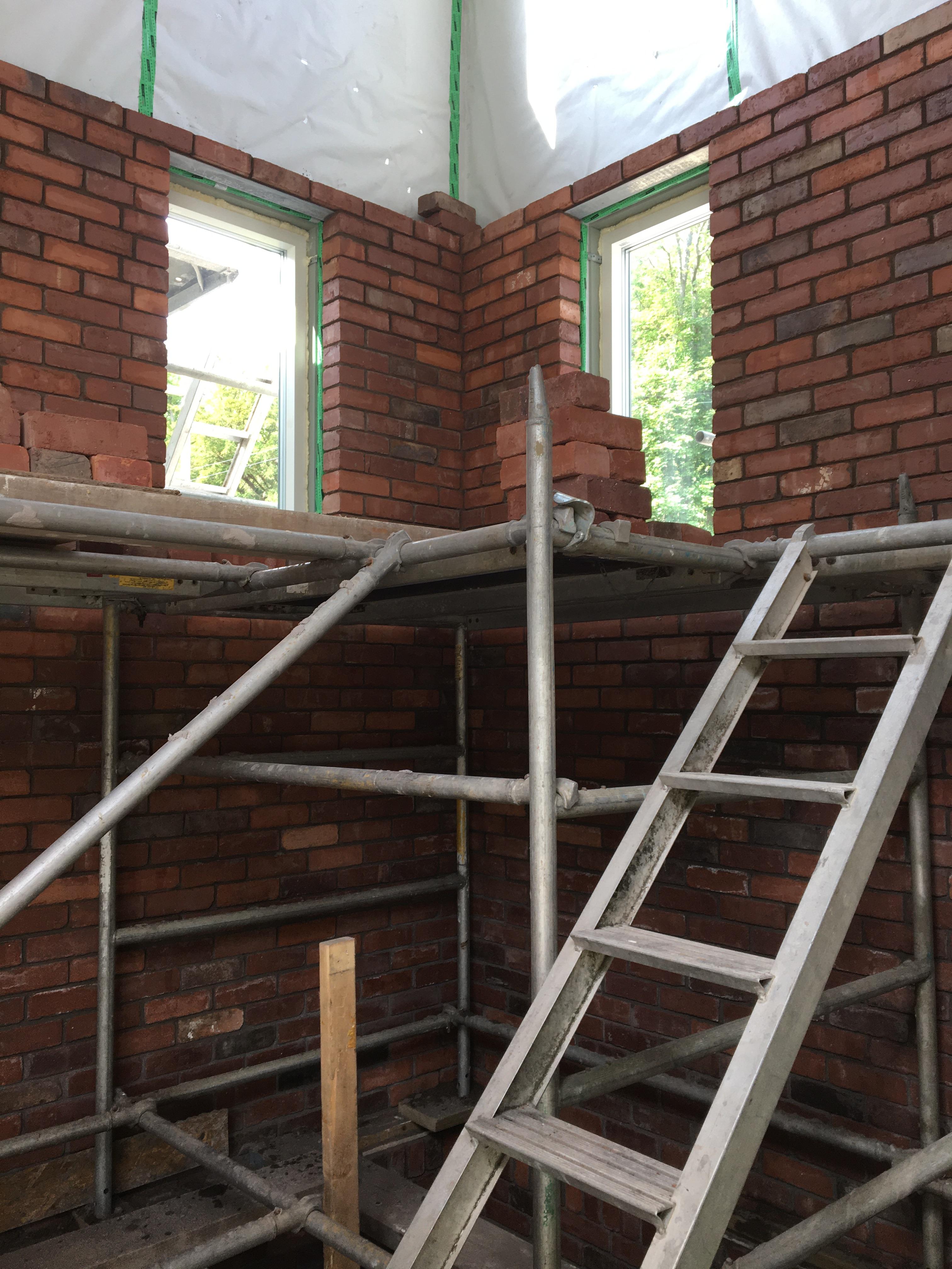

Triassic Posted March 9, 2021 Share Posted March 9, 2021 (edited) On 02/03/2021 at 12:45, Bitpipe said: We had a similar era building and could not even give away the 1500 unused and stored bricks from its original construction (original owner had kept them for a future project) We used the second hand bricks to create feature walls and an ingle nook fire place. We’ll probably use what’s left for garden walls. Edited March 9, 2021 by Triassic Link to comment Share on other sites More sharing options...
