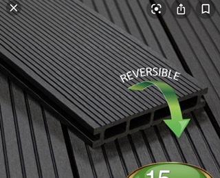

daiking Posted March 7, 2021 Share Posted March 7, 2021 20 hours ago, MikeGrahamT21 said: Not for this bit no, to be honest I just used this stuff to make a couple of steps out of the bifolds on to patio as it was too big of a step down. Can take some photos tho if you want? No need to go to any trouble. I’m just looking at options. One thing I don’t like about the cheap options I’ve looked at is that there is no edge board option. Either you leave the slot on show or use the dodgy trims. Link to comment Share on other sites More sharing options...
Gone West Posted March 7, 2021 Share Posted March 7, 2021 1 hour ago, daiking said: One thing I don’t like about the cheap options I’ve looked at is that there is no edge board option. Either you leave the slot on show or use the dodgy trims. Can't you make an outer frame with mitred corners and then board up to the frame. Link to comment Share on other sites More sharing options...
daiking Posted March 7, 2021 Share Posted March 7, 2021 28 minutes ago, PeterStarck said: Can't you make an outer frame with mitred corners and then board up to the frame. That’s what I mean, you still have the slot down the outer long sides. I have seen a step profile which could work in that situation. Link to comment Share on other sites More sharing options...
MikeGrahamT21 Posted March 7, 2021 Share Posted March 7, 2021 1 hour ago, daiking said: No need to go to any trouble. I’m just looking at options. One thing I don’t like about the cheap options I’ve looked at is that there is no edge board option. Either you leave the slot on show or use the dodgy trims. I mitred my boards rather than using trims which worked fine, saved using the trims Link to comment Share on other sites More sharing options...
daiking Posted March 7, 2021 Share Posted March 7, 2021 5 hours ago, PeterStarck said: Can't you make an outer frame with mitred corners and then board up to the frame. 4 hours ago, MikeGrahamT21 said: I mitred my boards rather than using trims which worked fine, saved using the trims Or do you both mean mitre down the full long edge of 2 boards and finish the edges that way? Link to comment Share on other sites More sharing options...
TonyT Posted March 7, 2021 Share Posted March 7, 2021 Mitre any external angles, so the joining strip isn’t required. the deck board that you stand on , either finishes flush with the joist, or overshoots it by the thickness of a deck board, so when the deck board on the face is fixed it’s flush Link to comment Share on other sites More sharing options...
Gone West Posted March 7, 2021 Share Posted March 7, 2021 32 minutes ago, daiking said: Or do you both mean mitre down the full long edge of 2 boards and finish the edges that way? No I didn't mean that, I didn't notice it had that type of long edge. Is that how they're joined together length ways or something. Link to comment Share on other sites More sharing options...
MikeGrahamT21 Posted March 7, 2021 Share Posted March 7, 2021 3 hours ago, daiking said: Or do you both mean mitre down the full long edge of 2 boards and finish the edges that way? Yeah that’s right, took a bit of time but it looks pretty good Link to comment Share on other sites More sharing options...
MikeGrahamT21 Posted March 7, 2021 Share Posted March 7, 2021 3 hours ago, PeterStarck said: No I didn't mean that, I didn't notice it had that type of long edge. Is that how they're joined together length ways or something. The groove is used for the hidden fixings to grab into which runs all the way down both sides of the length 1 Link to comment Share on other sites More sharing options...
