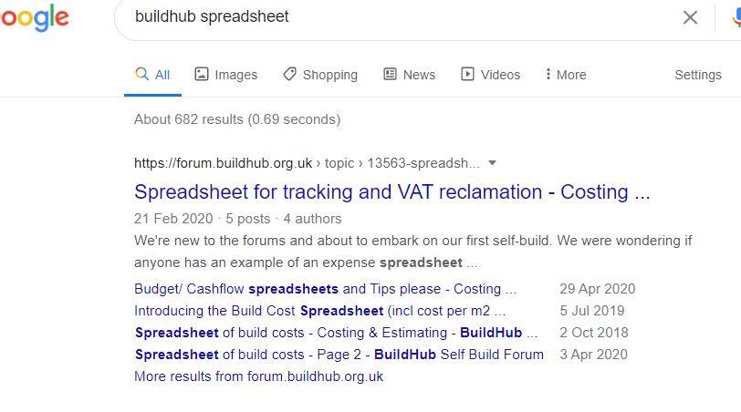

ToughButterCup Posted February 27, 2021 Share Posted February 27, 2021 Hello. Interesting project. Tight is the word isn't it? 9 hours ago, JJD1 said: ... any project plans or spreadsheets would be very gratefully received! 1) Construction methods/materials... where to begin!? SIPs, timber, steel, block...? I am keen to keep the build as environmentally friendly as possible, but budget will unfortunately have a part to play. Where did you start with considering the options? 2) Does the 'floating overhang' limit my options of construction methods/material? 3) Does the fact the building would be 4 storeys limit my options too? You are new to us so you might well not have discovered the power of the local site search Here's a site search for the term spreadsheet in the title (here) You can also search this site from Google like this In relation to question 1 the answer is, genuinely, anywhere. Just do it. (Stopped wearing Nike trainers some time ago - too old ?) As far as 2 and 3 are concerned, I have no idea, but I'd start by chatting to an SE Now, can I ask an obvious question: do you have Planning Permssion? Link to comment Share on other sites More sharing options...

JJD1 Posted February 27, 2021 Author Share Posted February 27, 2021 22 minutes ago, ToughButterCup said: Tight is the word isn't it? Something like that... 22 minutes ago, ToughButterCup said: Here's a site search for the term spreadsheet in the title (here) Thanks for this! I have looked through all of these but still haven't found one. My computer won't let me convert those that say to download and convert back to .xls files. I'll keep looking and will aim to share mine when it's complete. Or when I think it's complete, at least. 22 minutes ago, ToughButterCup said: Now, can I ask an obvious question: do you have Planning Permssion? Not yet, but pre-planning advice was very promising! Link to comment Share on other sites More sharing options...
