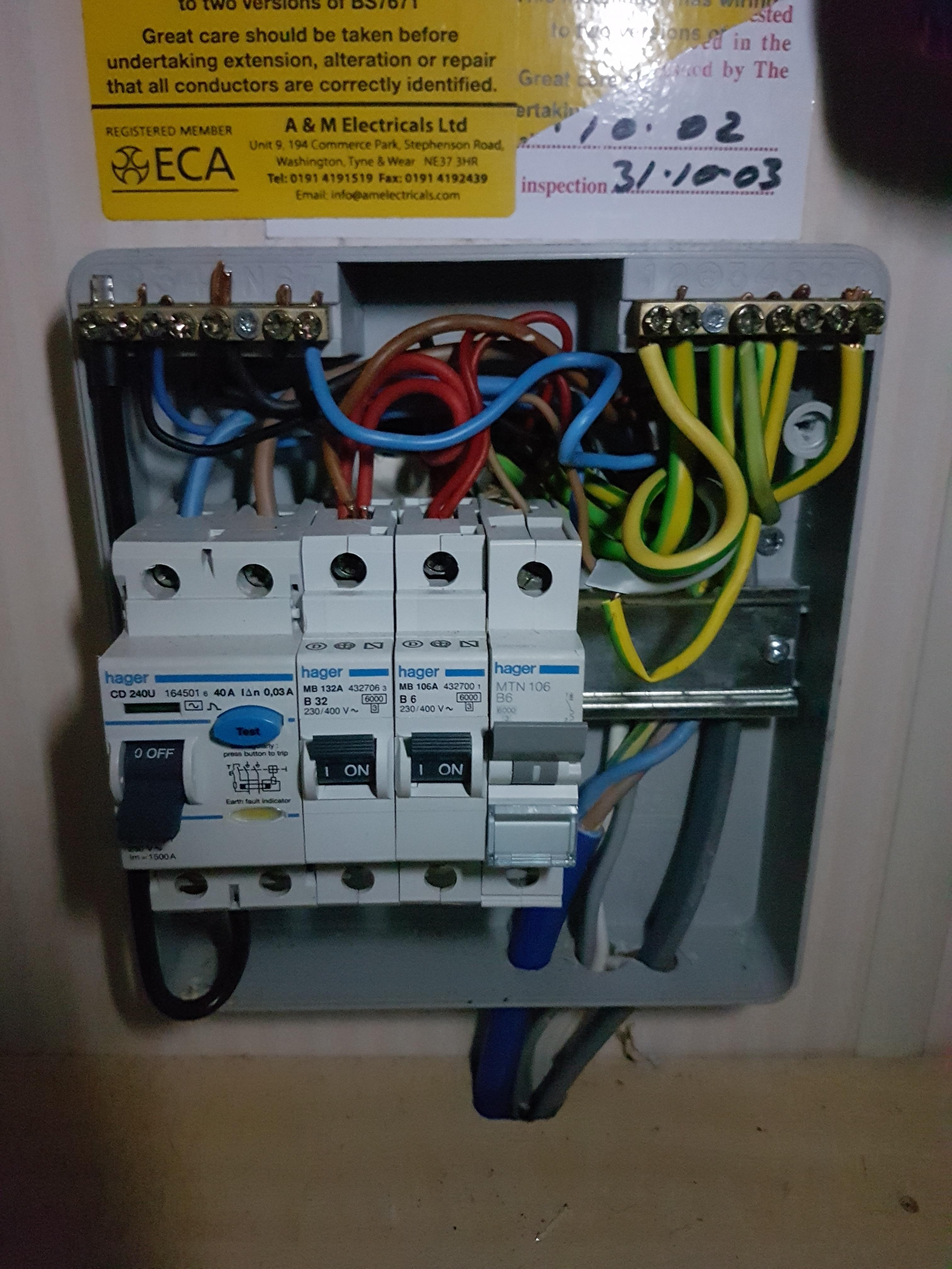

Tom Posted February 20, 2021 Share Posted February 20, 2021 Moved in to the static yesterday. Cosmic. All going well, or at least as well as can be expected. Today electrics fine, but then suddenly this afternoon the rcd trips and won't go back "on". I turn off the three switches in the consumer unit: lights, ring main and heaters. I can turn the rcd back to on, but if I turn any of the three switches to "on" it trips again. I'm guessing there can't be a downstream fault in the three circuits as any of them trips it, so there must be a fault upstream in the supply to the consumer unit - is that right? Help!! At the moment sat here with an extension lead from the barn powering our router and a light... Link to comment Share on other sites More sharing options...

ProDave Posted February 20, 2021 Share Posted February 20, 2021 2 minutes ago, Tom said: Yes please Dave! Right, open up your consumer unit. If it follows the norm for these things there will be an RCD main switch and 3 mcb's. Disconnect the L AND the N from one of the circuits try resetting the RCD and see if the remaining 2 circuits works and does not trip the RCD. If it still trips re connect that one and dosconnect both L and N of the next circuit and try it. Hopefully you will result in 2 of the circuits connected and working and the fault will be on the third disconnected circuit. Link to comment Share on other sites More sharing options...
Tom Posted February 20, 2021 Author Share Posted February 20, 2021 Pic attached, remove wires going in to the top of the mcb? Link to comment Share on other sites More sharing options...
ProDave Posted February 20, 2021 Share Posted February 20, 2021 One circuit at a time, remove the wires from the MCB AND remove the corresponding neutral wired from the neutral block top left. Take particular care to follow the lives back to identify the cable and identify the corresponding neutral. Neutrals look all jumbled up in the N block so not as straightforward as it could be. the first mcb, the 32A one, looks to be a red / black ring final with a later brown / blue spur added. Treat that as 2 circuits so try removing the 2 reds (and corresponding blacks) or try removing the brown and corresponding blue one at a time. 1 Link to comment Share on other sites More sharing options...
Tom Posted February 20, 2021 Author Share Posted February 20, 2021 Thanks Dave and thanks Tony - great video. So I've tried removing each wire from each mcb in turn, and their corresponding neutral (and earth, though rereading your post Dave it looks like I needn't have bothered, makes sense when I think about it). Anyway, makes no difference, the RCD keeps tripping when I turn an appliance on, heater on or flip the lighting mcb (guess there must be a slight load on this circuit). A lot of the time the RCD doesn't reset even if all mcb's are in the off position. It takes multiple attempts and then it will finally stay on. Faulty RCD? 20210220_190356.jpg Link to comment Share on other sites More sharing options...

Tom Posted February 21, 2021 Author Share Posted February 21, 2021 So pondering this while lying awake at 3am last night: if I AM able to switch the RCD to the on position (even after a few tries) then it cant be a neutral/earth fault? As irrespective of the MCD position it should trip straight away - is that right? It seems to trip when there is load on any of the circuits - a neutral/earth fault should trip the RCD irrespective of whether there is load on a circuit or not. So it MUST be a faulty RCD? Link to comment Share on other sites More sharing options...
dpmiller Posted February 21, 2021 Share Posted February 21, 2021 A high resistance on neutral might do it (as there's always *some* leakage current to earth) but it does sound like it's the RCD. but whenever you *do* get the RCD to latch in and the lighting MCB trips it that does allude to a problem with that circuit. Is there an extractor fan in the loo perhaps? Where is the power coming from for the van? What kind of cable? Is there an earth rod? Link to comment Share on other sites More sharing options...
ProDave Posted February 21, 2021 Share Posted February 21, 2021 A neutral - earth fault will result in some of the return current from any load travelling via earth, not neutral so it creates an imbalance between L and N and the RCD does it's job of tripping. So there will only be a return current and hence an imbalance when a load is turned on. No loads (all mcb's off) = no current flowing = no imbalance = no rcd trip. Link to comment Share on other sites More sharing options...
Tom Posted February 21, 2021 Author Share Posted February 21, 2021 The lighting MCB trips it when I switch it to on true, but I can switch the other two MCBs on but then any load on those trips it too. So can it be a fault on any one circuit? No extractor fan in the loo (unfortunately). There is no earth rod for the van itself, but the supply is from one of the barns via the 3phase supply to these - it's a 16a cable. I've already tried replacing this as I was initially thinking it must have been a fault on the supply. Link to comment Share on other sites More sharing options...
