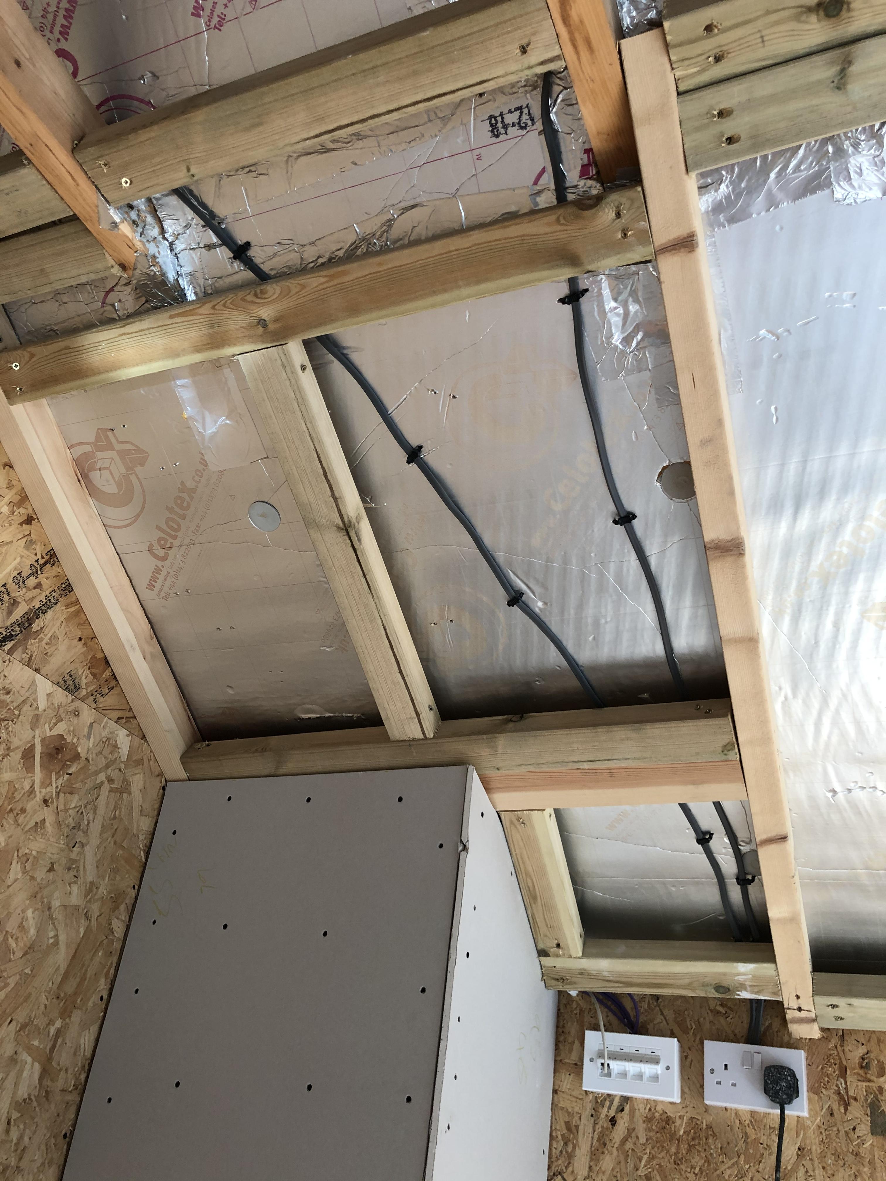

Started a ceiling at the weekend. Hadn't anticipated the noggins taking longer than getting the sheets up.
Not helped by the fact I had a few boards up before I noticed the sag and had to climb in to the loft void to retrospectively fit >:(

A plasterer asked what centres our trusses are, which are 600mm. He suggested using 4x1 counter battens (aka 'brandering', thanks @Hobbiniho) at 400mm centres screwed underneath the trusses to screw the plasterboard to. What do people make of this suggestion? It's a lot easier than noggins. It eats in to the ceiling height but only be 22mm.

I must admit despite my plasterer saying noggins are not required at joins I tend to screw an off cut of ply or flooring to the edge of the plasterboard just put up then screw the new plasterboard sheet to it. Not a noggin but just keeps the plasterboard edges in line. Probably OCD but I have no cracks in my plasterwork after a year ?
