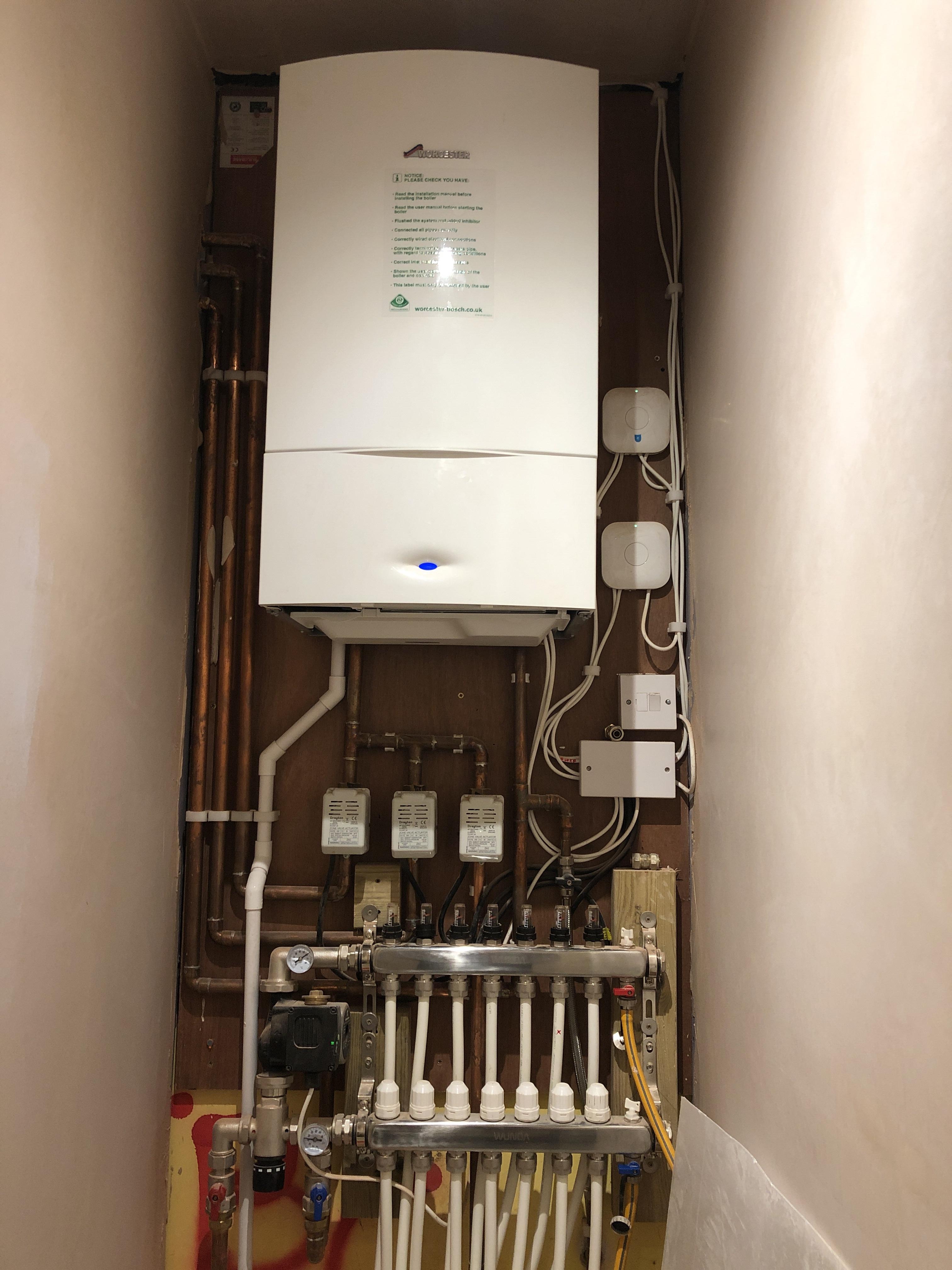

Currently my UFH & system is setup as the following.
Entire ground floor is UFH, i have a 8 port manifold (7 used) this is connected to my boiler and Pump.
When i turn the nest up the pump kicks in pushing the water around the loops until temperature is met.
Problem is the longer runs take longer to heat up so i purchased the Salus THB23030 - Auto Balancing Actuator. (7 of them!)
I dont want to rip out my nest as i like the smart functions of the nest, i presume i can do the following.
Install the Salus THB23030's (simple and easy todo) wire them into a Salus KL08NSB 8-zone wiring centre WHICH ONLY has 230v power supplied to it to power the Salus THB23030's.
In effect they will be "always on" and will have the power to control the pins/flow as they see fit.
Is there any thing im missing here? Would that be a good way todo it? As i say im retro fitting and dont really want to take away the nest or re-wire it.
Probably all you needed to do is balance the system, turn down the flow rate to the shorter loops and turn up the flow rate to the longer loops.
can you post a picture of your manifold as it is?

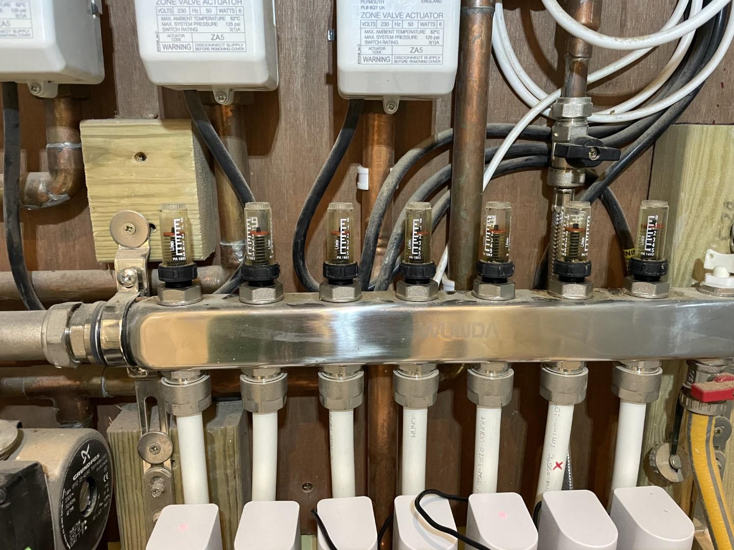

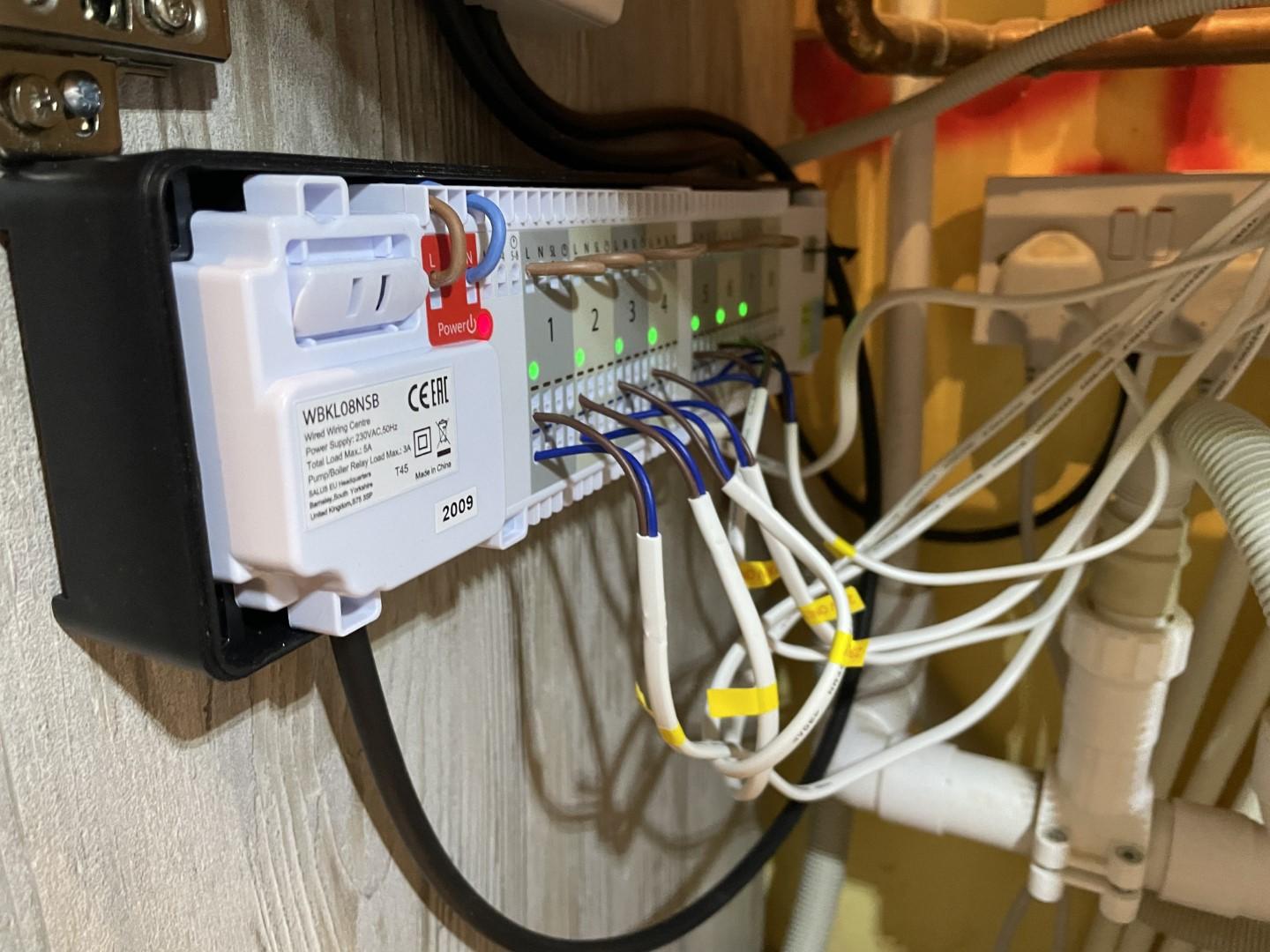

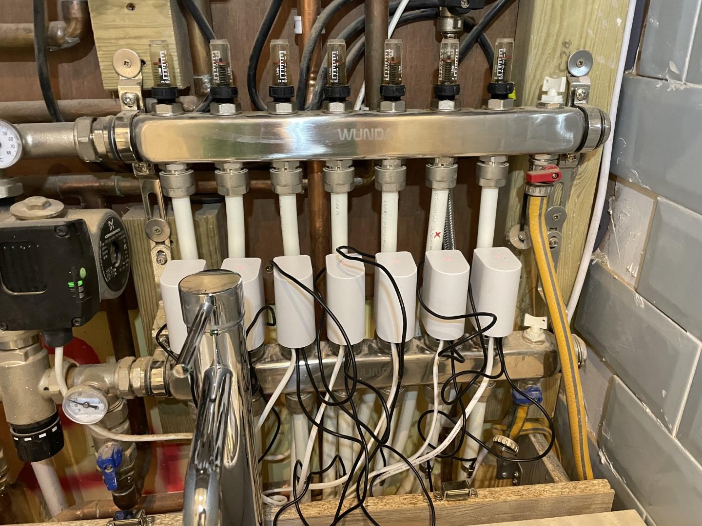

so i got the units installed buy having a nightmare with them.
all 7 actuator's are linked into the KL08NSB controlbox which is powered by 240v mains.
The all come on and powerup fine, no issues.
On first setup as per the manual heating was switched on, actuator's was then powered on and LED's ontop began to blink (i presume this was calibration phase) i left it for around 30mins.
During this time the actuator's closed, opened then closed (their boot up sequence) and remained closed.
They basically will not open or balance the pump is on, boiler is on heating and i can see the temp rising on the probe and worried it will burst or something if gets stupid hot, which it is because the valves are all fully shut and pump is trying to push water around the circuit.
any ideas on what i can do ?

4 minutes ago, PeterW said:
Are all the green LEDs saying lit on the control panel ..??
yes, my control panel is wired to be always on giving 24/7 power to the Actuator's.
2 minutes ago, PeterW said:
Have you tested that with a meter and confirmed it..?
yes 240v into the control box, LED's green, Voltage going to the actuators, which move (open/close) and RED LED's lit.
7 minutes ago, PeterW said:
And the pump is starting ..?? pipes getting warm..?? Clips the right way round ..??
everything working as it should. just valves close and stay closed.
clips are 10cm as per manual - not sure they have a way around to go ?
If I've understood correctly you have the actuators powered all the time? What happens if (after calibration) you turn the power to the actuators off then on again?  The manual says it should flash the led for 2min then fully open the valve.
Edited by Temp
ok it might be fixed!!
i read somewhere to leave it on for 60mins "calibrating" and not the 20mins the manual says.
So far this seems to have worked and the valves are now open and everything is balanced at 2l/m
