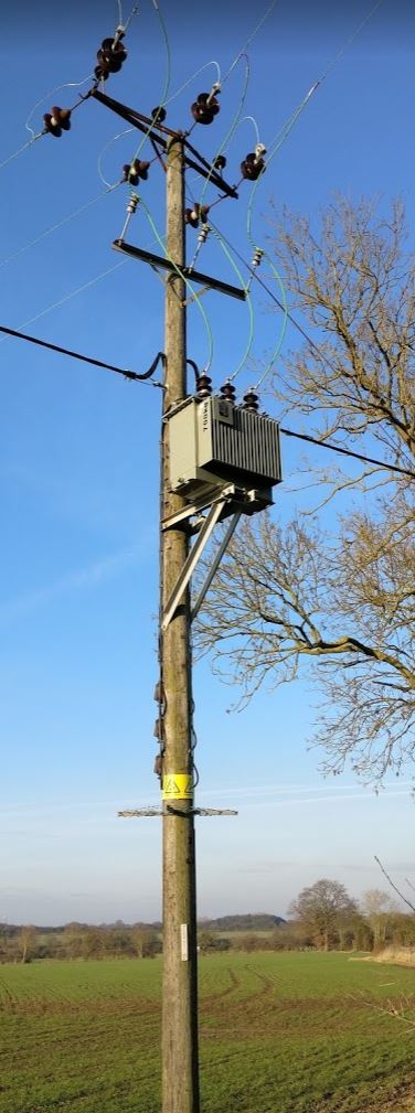

PeterW Posted February 10, 2017 Posted February 10, 2017 For drones you need to talk to our own aerial photographer @Construction Channel Does the site not have existing power..? Being rural you may find its in a pole transformer - these do need replacing and upgrading over time and sometimes you can get lucky and the company will do it for free. Other times then you may end up with a bill - £10-15k is not unreasonable. It also drives the decisions on what to use for heating etc as unless you go very low energy you will need to get a decent heat source that is not power hungry or the price of the transformer goes up ..! @readiescards did some thinking on being off grid in a similar situation 1
ProDave Posted February 10, 2017 Posted February 10, 2017 3 minutes ago, PeterW said: Does the site not have existing power..? Being rural you may find its in a pole transformer - these do need replacing and upgrading over time and sometimes you can get lucky and the company will do it for free. Other times then you may end up with a bill - £10-15k is not unreasonable. That is a valid point. we were only offered a "12KVA supply", which is a bit low for a normal domestic house, but that was on the basis of there being 8 houses now sharing one 100KVA transformer, and I know if we pushed for a bigger supply, there would have been a cost implication to upgrade that transformer. The reality is we get exactly the same supply as anyone else,same size cable, 100A fuse, so we could draw 24KVA from it without problem, but if everyone did that at the same time there would be a problem.

IanR Posted February 10, 2017 Posted February 10, 2017 19 minutes ago, PeterW said: Does the site not have existing power..? Being rural you may find its in a pole transformer - these do need replacing and upgrading over time and sometimes you can get lucky and the company will do it for free. Other times then you may end up with a bill - £10-15k is not unreasonable. I needed new connections to my Barn Conversion, to split it away from the original supplies to the Farm. UK Power Networks made sure I paid for a new Transformer even though I could demonstrate that our Farm and two neighbouring Farms supplied by the same Transformer were not using anything like the power they consumed 10 years ago. Even to add 20kVA single phase supply for my property they wanted the transformer upgrade, so I went with 100kVA 3 phase and it made no difference to the price. The Transformer was £3.5K, but the overall connection was £8.5K including the 130m of underground cable pulled through a trench that I dug. Here's my Transformer, I feel I own it! 2
