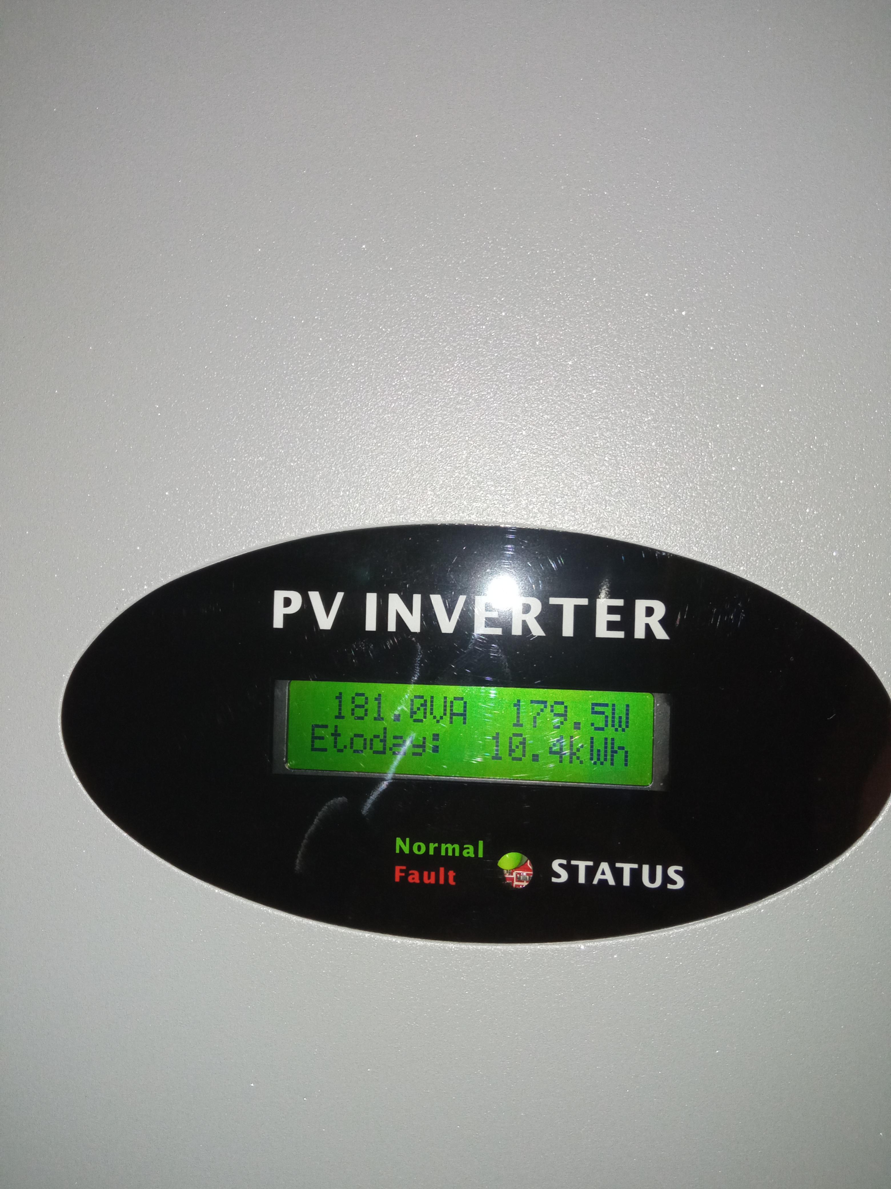

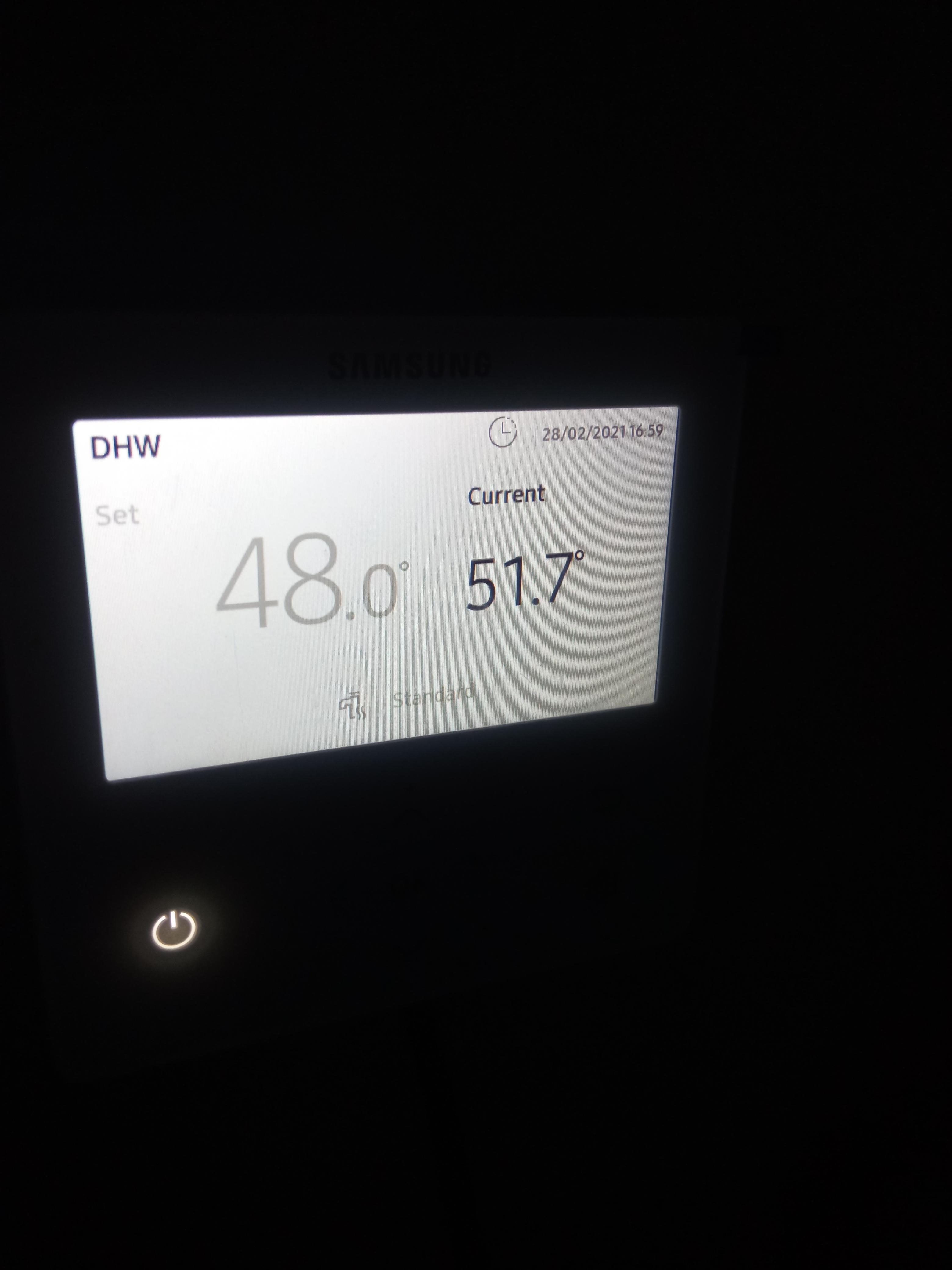

canalsiderenovation Posted February 28, 2021 Posted February 28, 2021 (edited) We had in roof solar 12 x 320w panels in roof landscape. It was not as cheap as @ProDave as we had to pay for installation and the equipment was just shy of £2400 alone which included everything - the Solic for diverting the excess to the immersion, the in roof panels, inverter etc We currently only have our heat pump heating the water for a couple of hours a day on the Octopus Go Faster Tarrif (8:30pm for 4 hours of 5p electric) and we find the Solic pv heats the water in between (it's set at 48 degrees for the heat pump to heat it and a sunny day like today the excess pv diverted to the immersion and it's heated way above that and I've had bucket lots of hot water today as I've been cleaning windows and washing the car). Pics taken just now... The solar today and yesterday did well over 10kWh. Earlier in the month it was only around 5kWh a day. Today we have charged everything, had washing and dishwasher going. It's worth it for me but we both work from home and can really make use of the electricity when its there. Edited February 28, 2021 by canalsiderenovation

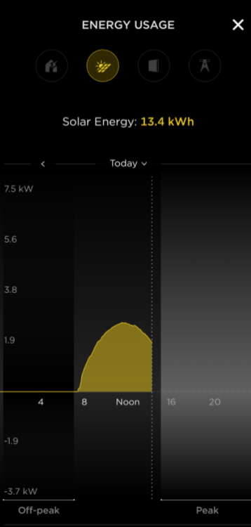

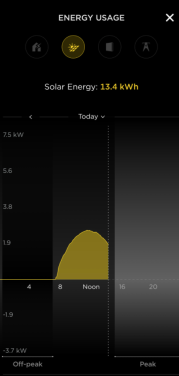

Dave Jones Posted February 28, 2021 Posted February 28, 2021 It's a nice feeling isn't it 'free' electric! My own solar has done really well the last week of sunshine, not to mention the 60p fit... I bought a tesla Powerwall 2 years ago so I could time shift my usage and take advantage of the solar and hourly billing. Really pleased with the investment.
