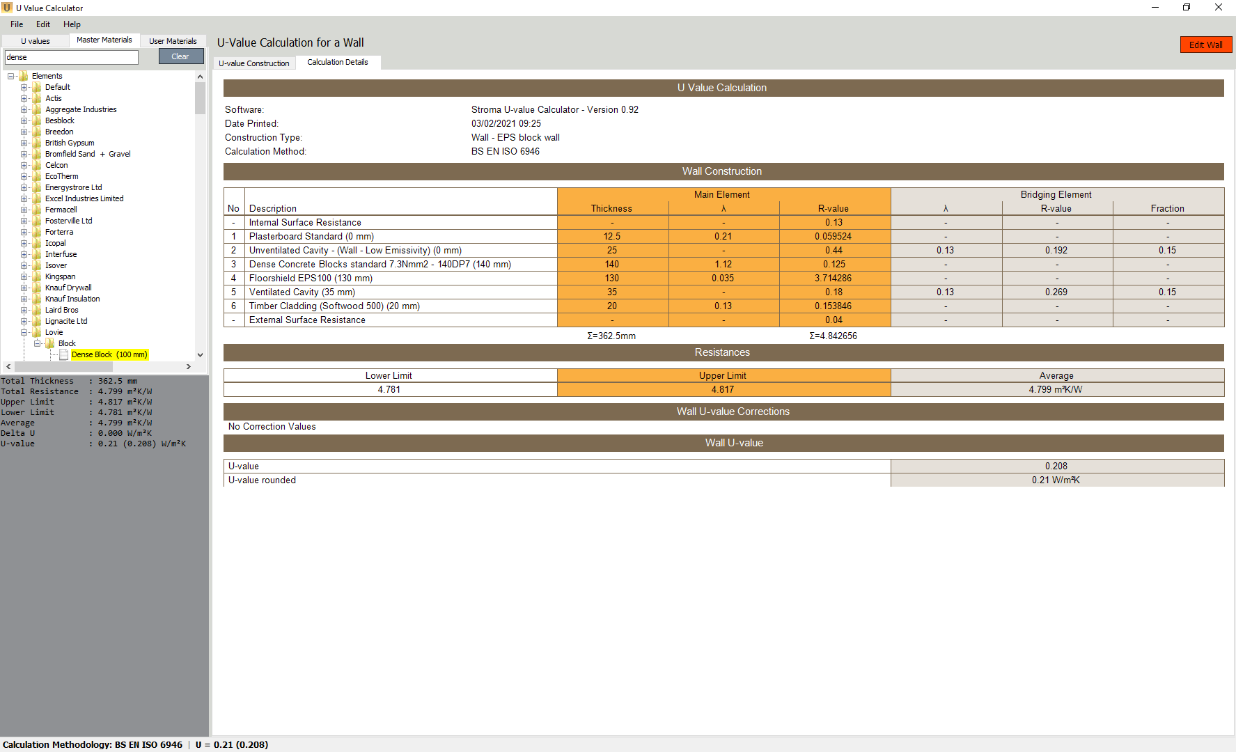

Russell griffiths Posted February 3, 2021 Posted February 3, 2021 Can somebody do some rough number crunching for me please. There has been a bit of talk lately about block walls with just external eps insulation, so wondered where it comes out U value wise. From the inside out. 12.5 plasterboard 25 mm service batten 150mm dense concrete blocks 130mm eps 100 25mm batten timber cladding. Thanks, oh clever ones.
Bitpipe Posted February 3, 2021 Posted February 3, 2021 https://www.uvalue-calculator.co.uk/calculator/ https://www.changeplan.co.uk/u_value_calculator.php You add the R values for each material and then 1/R = the U value. 1
Moonshine Posted February 3, 2021 Posted February 3, 2021 i get it calculated to 0.21, you can get it to 0.19 if you use a lightweight block of R value 0.25. 1

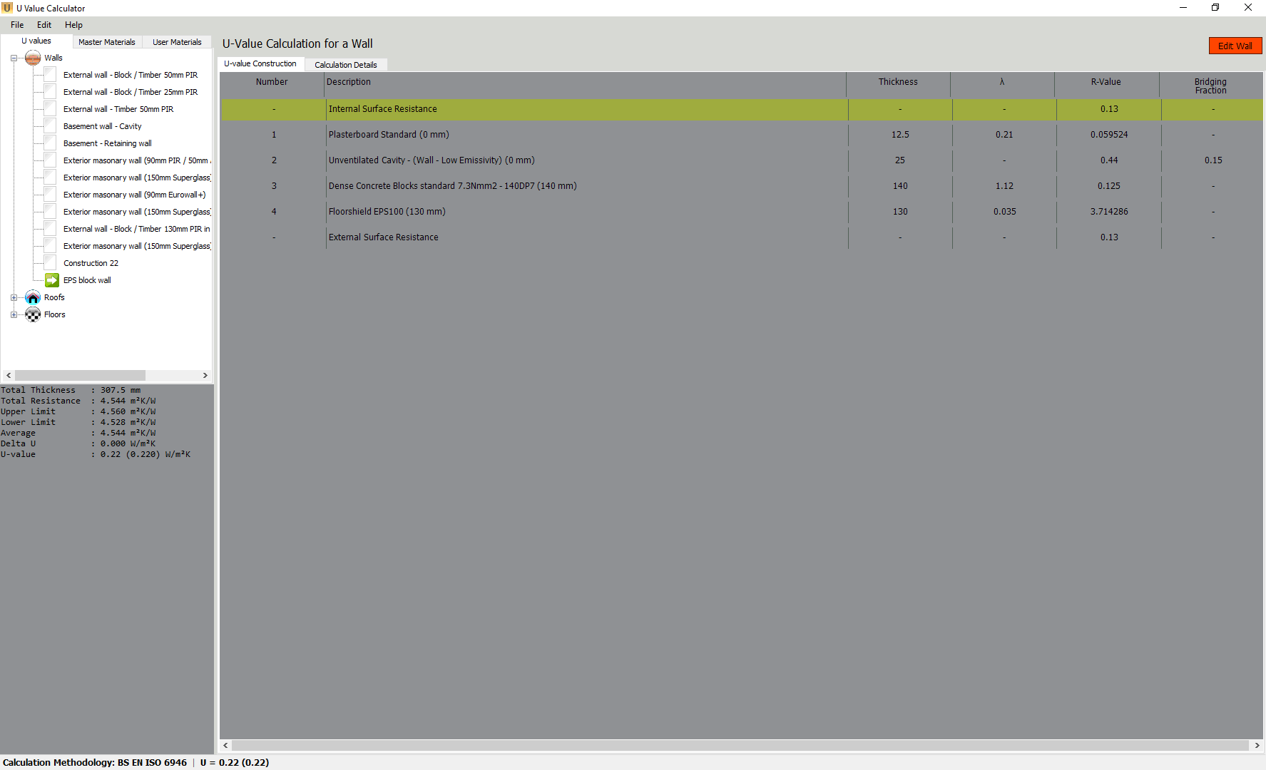

A_L Posted February 3, 2021 Posted February 3, 2021 Since the cavity (layer 5) is fully ventilated layers 5 & 6 are by convention not included but the external resistance, which is actually at the outside of layer 4, can be increased to 0.13 because the reduced average air movement increases the thickness of the external surface layer. See page 12 of attached pdf. BR_443_(2006_Edition).pdf 2
Moonshine Posted February 3, 2021 Posted February 3, 2021 (edited) 53 minutes ago, A_L said: Since the cavity (layer 5) is fully ventilated layers 5 & 6 are by convention not included but the external resistance, which is actually at the outside of layer 4, can be increased to 0.13 because the reduced average air movement increases the thickness of the external surface layer. See page 12 of attached pdf. Cheers, that ups the U-value to 0.22. Edited February 3, 2021 by Moonshine 1

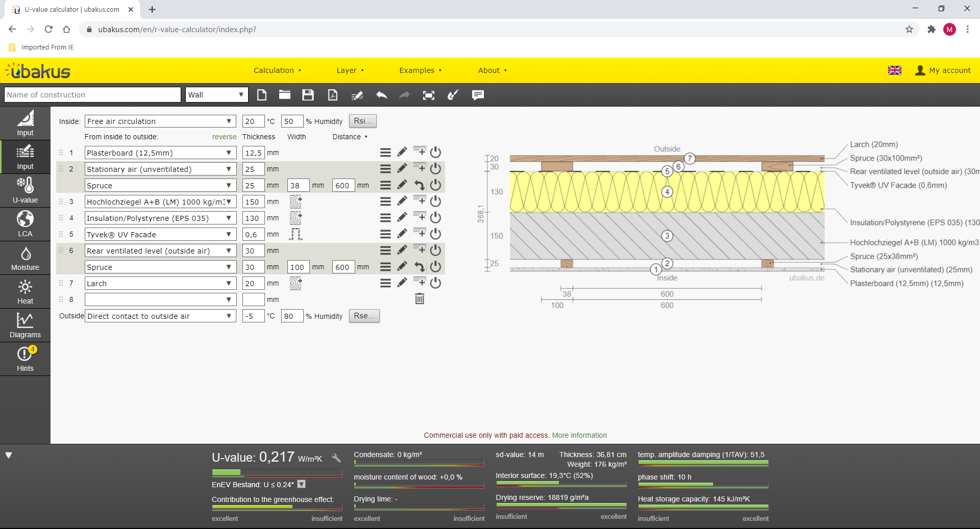

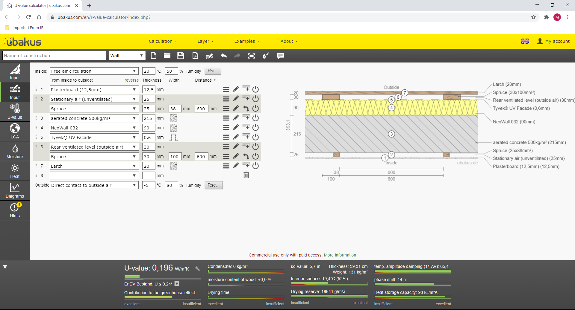

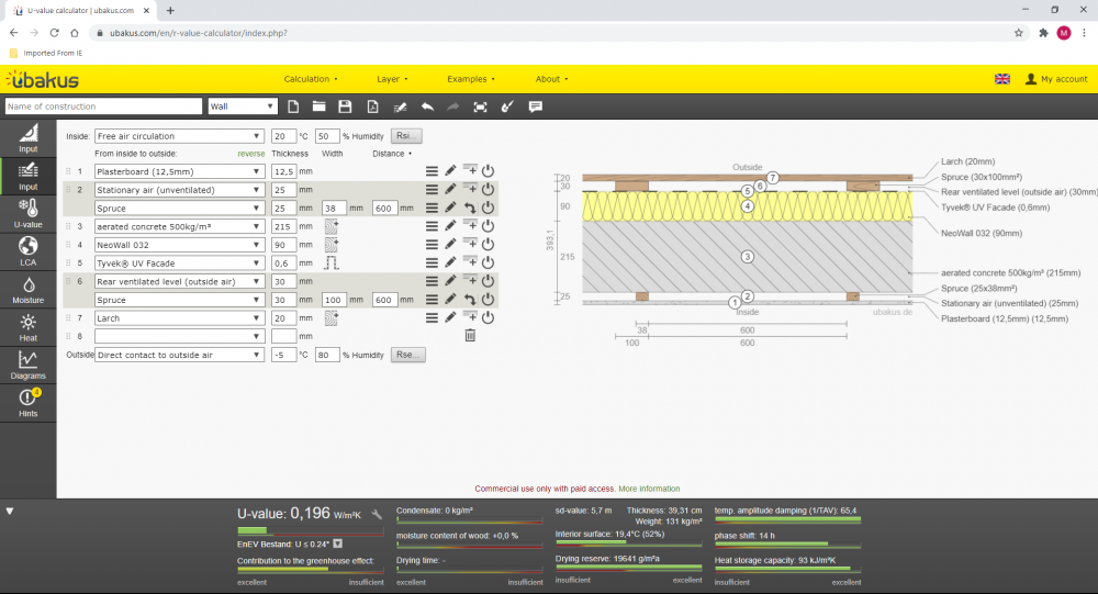

MikeGrahamT21 Posted February 3, 2021 Posted February 3, 2021 (edited) Another one for you with a few more facts and figures Also another config with Aircrete: Edited February 3, 2021 by MikeGrahamT21 1
